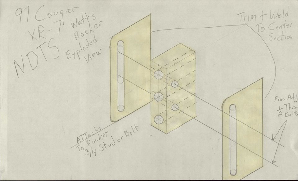

RON EFFIN SUTTON, there I said it.
While the man is a taboo subject on a lot of forums I used several ideas from him that were actually useful. While designing the rear suspension certain things like the width of the rear frame rails were taken directly from his drawings. Turns out 34 inches is perfect width for the speedway engineering rear sway bars. It also allows for a lot of rear tire clearance.
These are my drawings, because any project even though they mostly happen in our heads needs direction. You will see that later on some of the parts are not the same as the drawings. A piece in your hand quite often looks significantly different than the drawing.
I am far from perfect and you will see what looks like the same drawing but it will be a revision. After acquiring 3 red seal trades and attending several drafting courses I love to do drawings anyways.

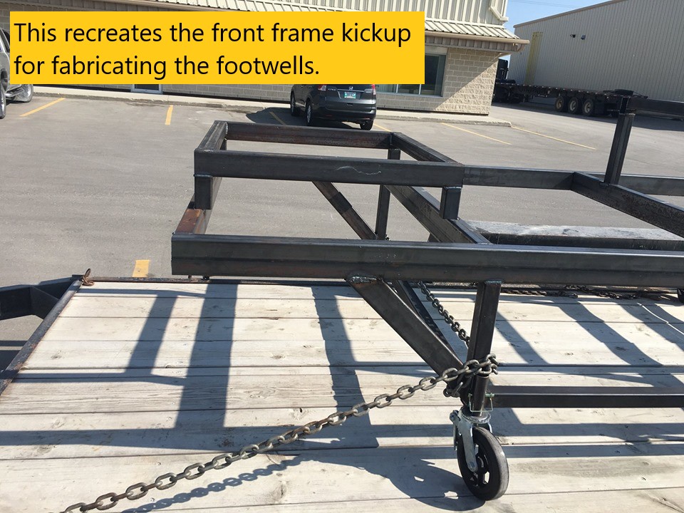

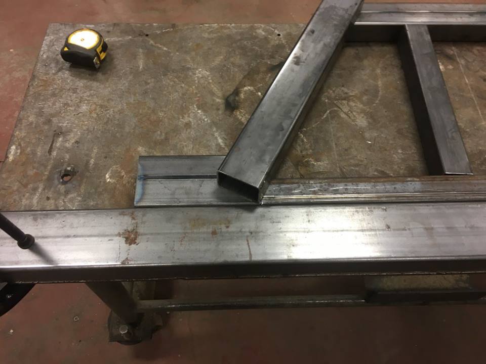

I told you this build was about to get serious. We are talking a full frame build and this is the first domino to fall. I am a modular style of builder and the rear section will be completed and a roller before we start on say, OH I don’t know, “The front section”?
There are 1x2, 2x2, 2x3, and 2x4 sections in this frame section. Because most of the rules call for a roll cage of 1-3/4 .120 wall I have chosen for the frame to be .125 wall as well. Obviously a chromoly cage would be lighter but many ruling bodies discourage, or don’t allow a lighter wall tubing for the 4130 cages. Extra expense with no weight advantage. NO THANKS!
With a layout table we build the first side. PEOPLE, that’s really easy! The hard part is when you have to make the second side match. Just use the first side as a pattern. That’s the easy way, LOL.
I know I mention this a lot but squares levels and tape measures are a staple of the pipe fitting trades and I am well versed in using them to keep it all straight. I kinda like using a piece of string once in a while also.
