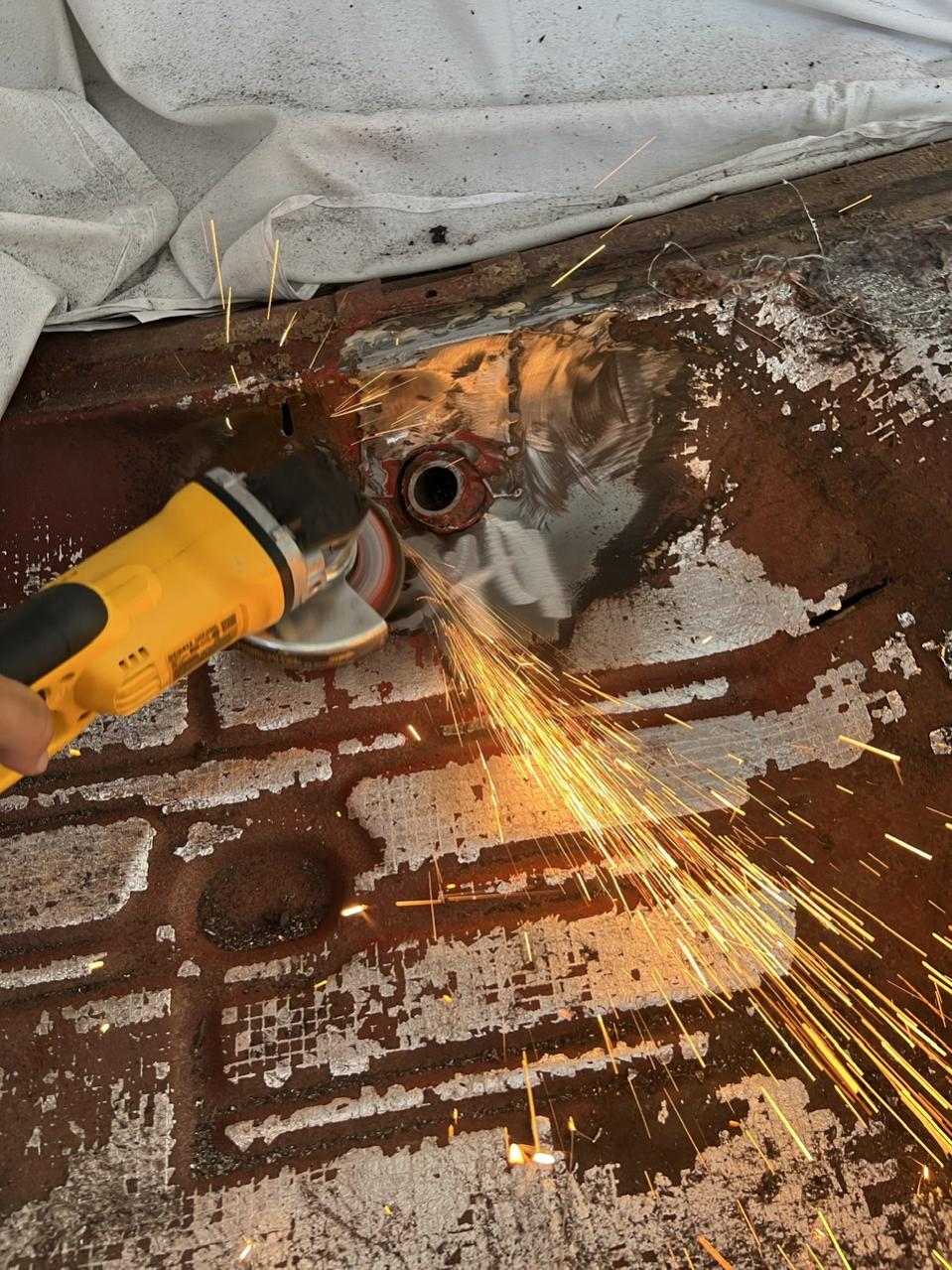

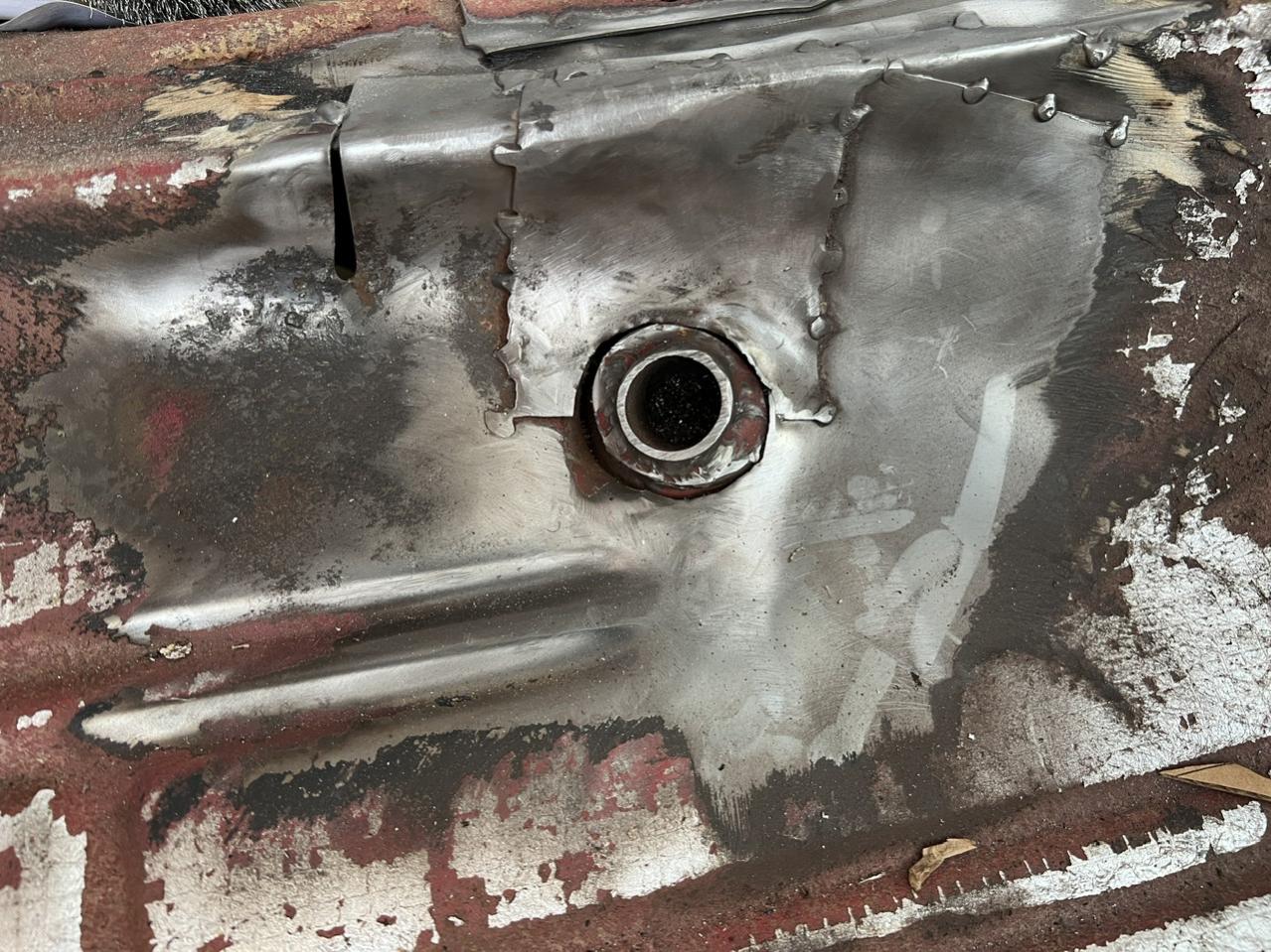

Hello Everyone! Not too much to update. I haven’t spent much time on it while my kids were out for the Summer. School is back in session, so I will be able to get some work days in here and there hopefully.
The only thing I’ve accomplished recently is starting on prepping the interior to weld in patch panels for where I removed parts of the roll cage. I will be working on that and the firewall panel before I move on to anything else.
I quickly learned I need to get a corded angle grinder. This little bit of work took four batteries using a sanding disc and a wire wheel brush. I’m hoping I can do it justice with the patches as I will be learning how to weld as I go. Yay! Go me!
The patches that are in the pics are from when the cage was installed. I have not mud-daubered any of my welding yet....

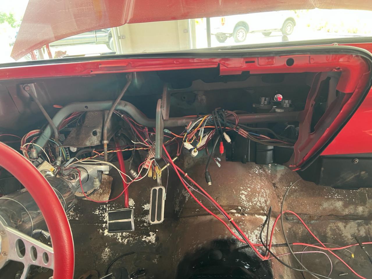

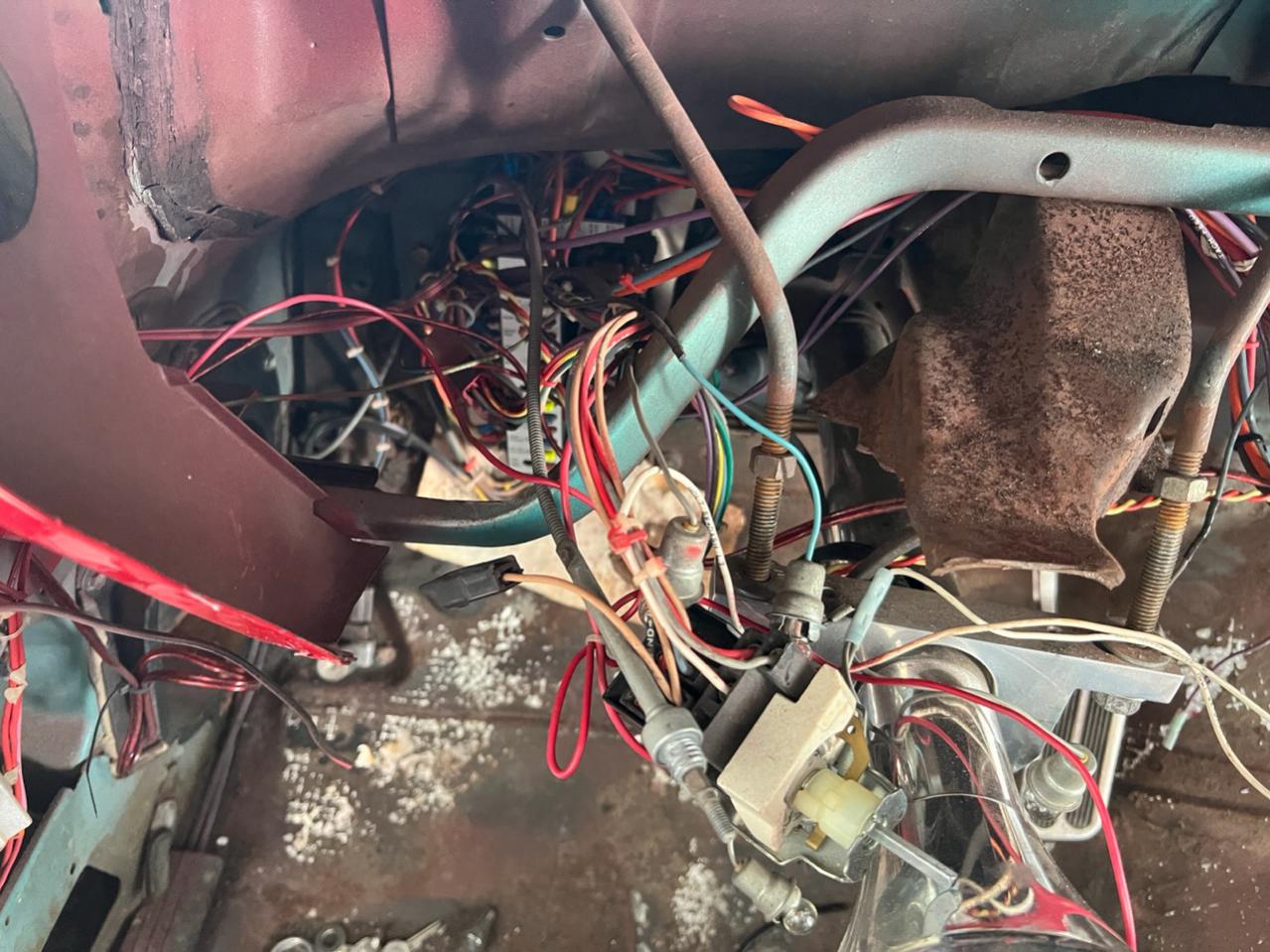

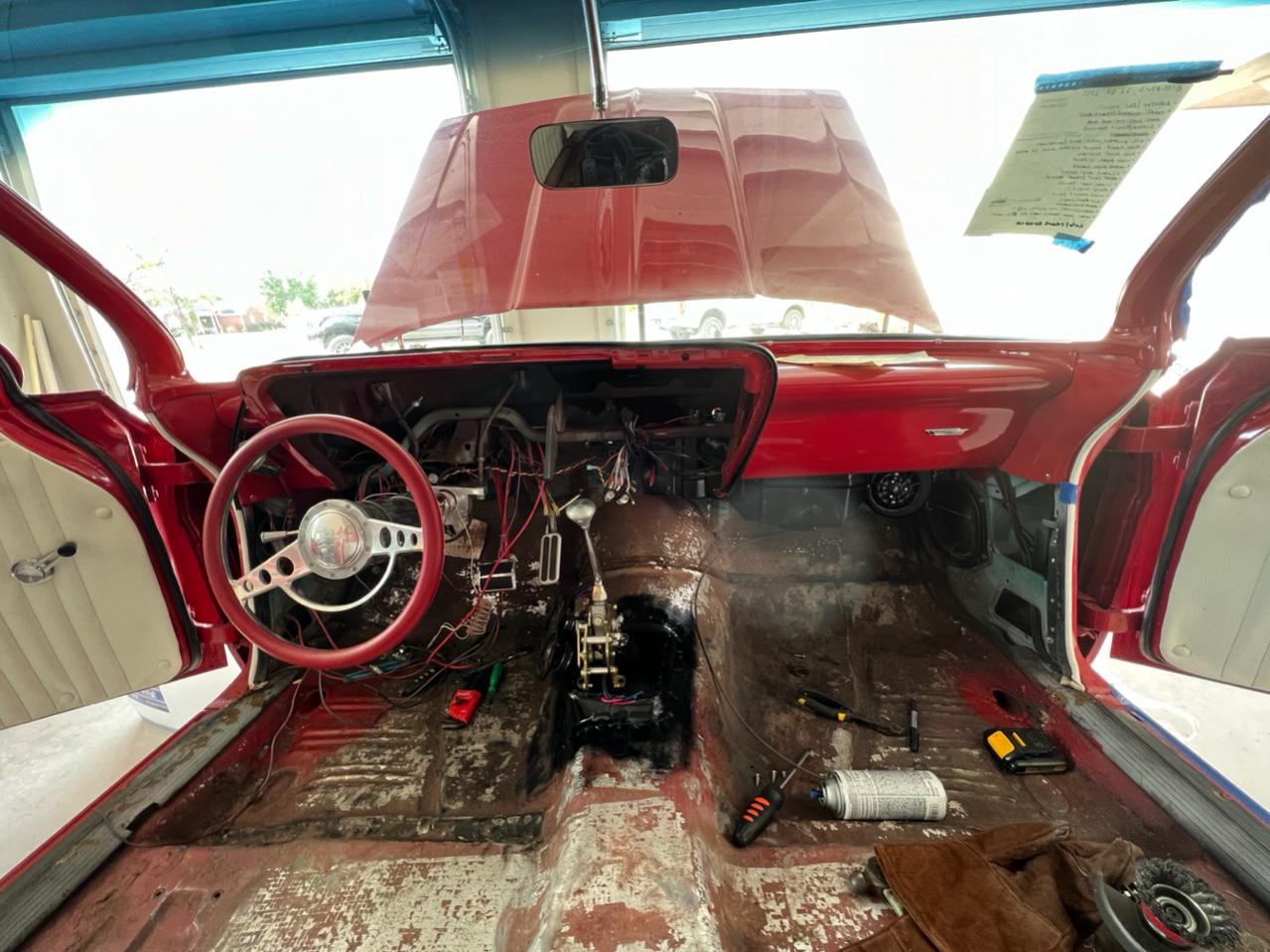

Ok… it has been a little bit since my last post. Not too much going on unfortunately. I have managed to get a 4-speed hump modified to work with my shifter so it will be offset in the center console and have also started on disassembling the dash to install the Dakota Digital gauges. The rat’s nest of wiring will be fun to tackle. The shifter is not mounted in the pic, btw.
