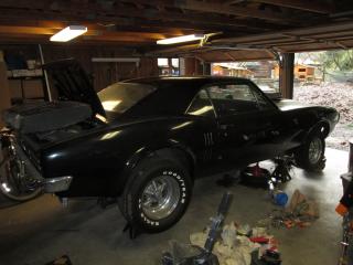

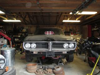

So I thought I would post some pictures of what I'm starting with. . .this is the '67 Firebird as it sits now; the only thing i have done to the car since I bought it is to remove the rear seat and some interior trim.
I thought I document start to finish. . .
. . .you'll have to forgive the messy garage; my Dad passed away and I shipped two antique tractors, 3 box trucks of tools & equipment, and a box truck of tractor parts. I haven't had time to get it all put away neatly yet.
