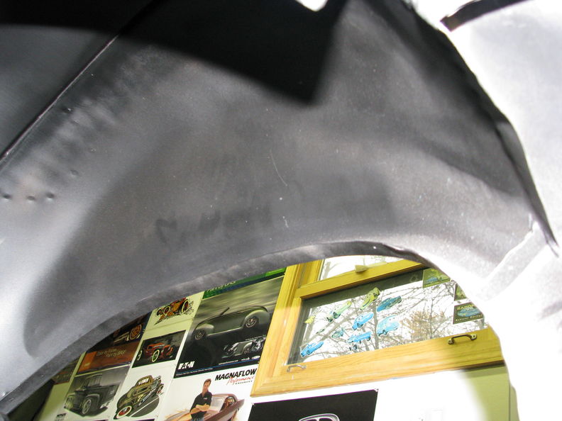

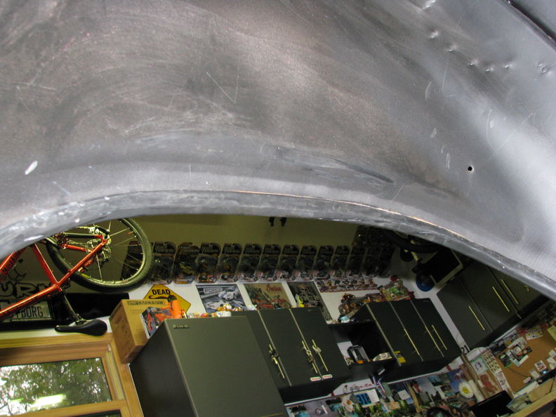

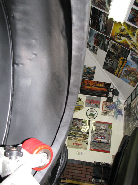

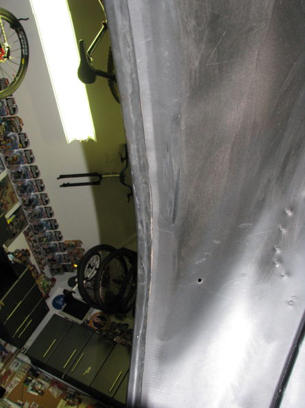

Last step is to roll the fender lip to gain a little tire clearance.
You can see how wide the fender lip.
Fender roller mounted and the fun begins
Finished - I've gained about 1/2" of extra room.
