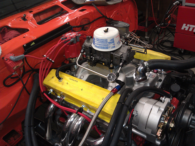

What spark plug wire separators do you have on your valve covers?....I have been looking for something like those but haven't had luck finding any.
Moroso, pretty common, Summit & Jegs, etc.
