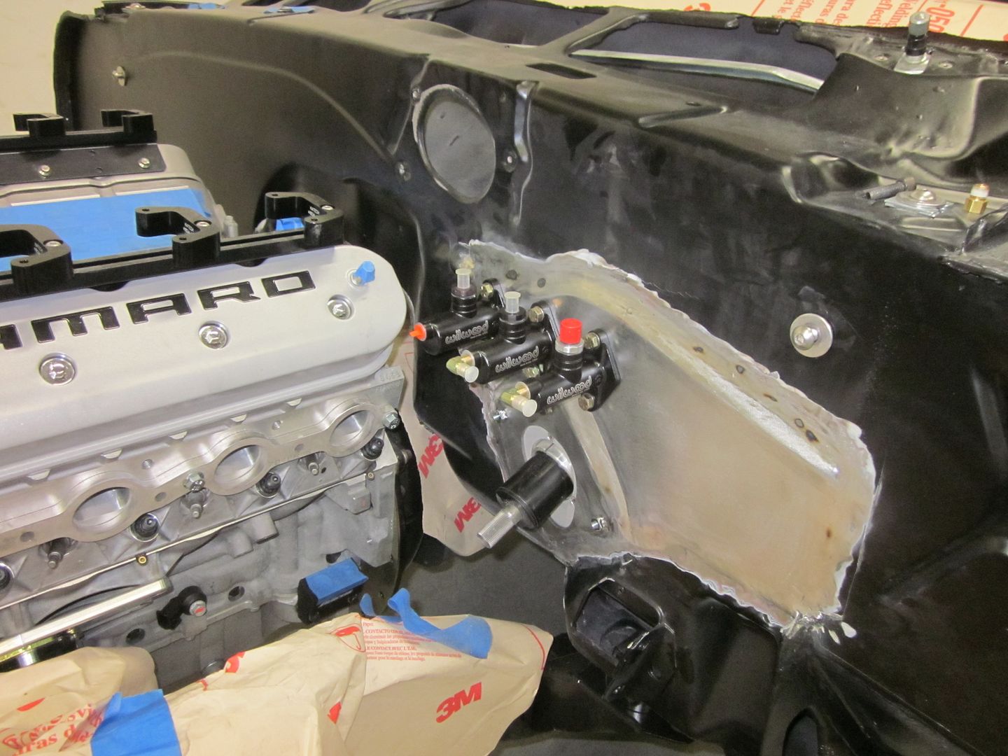

Got the Wilwood M/C with pedals done today.. Still got a little fine tuning to do but were close to finishing it out.. Need to modify the M/C to use Bajo fittings..
Looks good Cris! Thx for posting, can't wait to see it in person!
