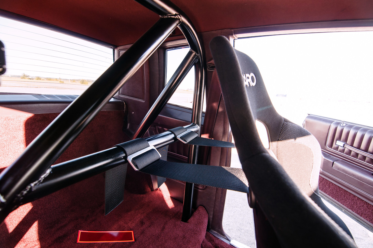

Bye-bye backseat!

Oh that ship sailed a few years ago already...

That's a nice clean back seat area there Lance.
That's all I got. Carry on with the Basher.

It'll be interesting to see what you come up with, Lance. I wonder how much lighter the car will be without that shag carpet.
