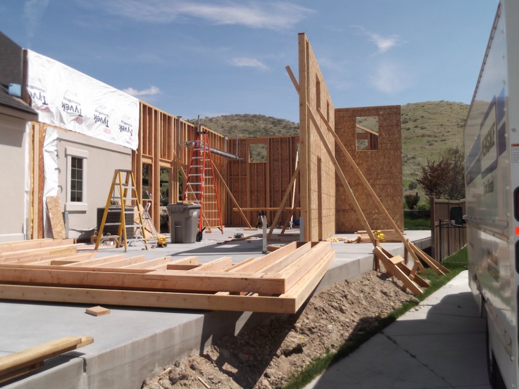

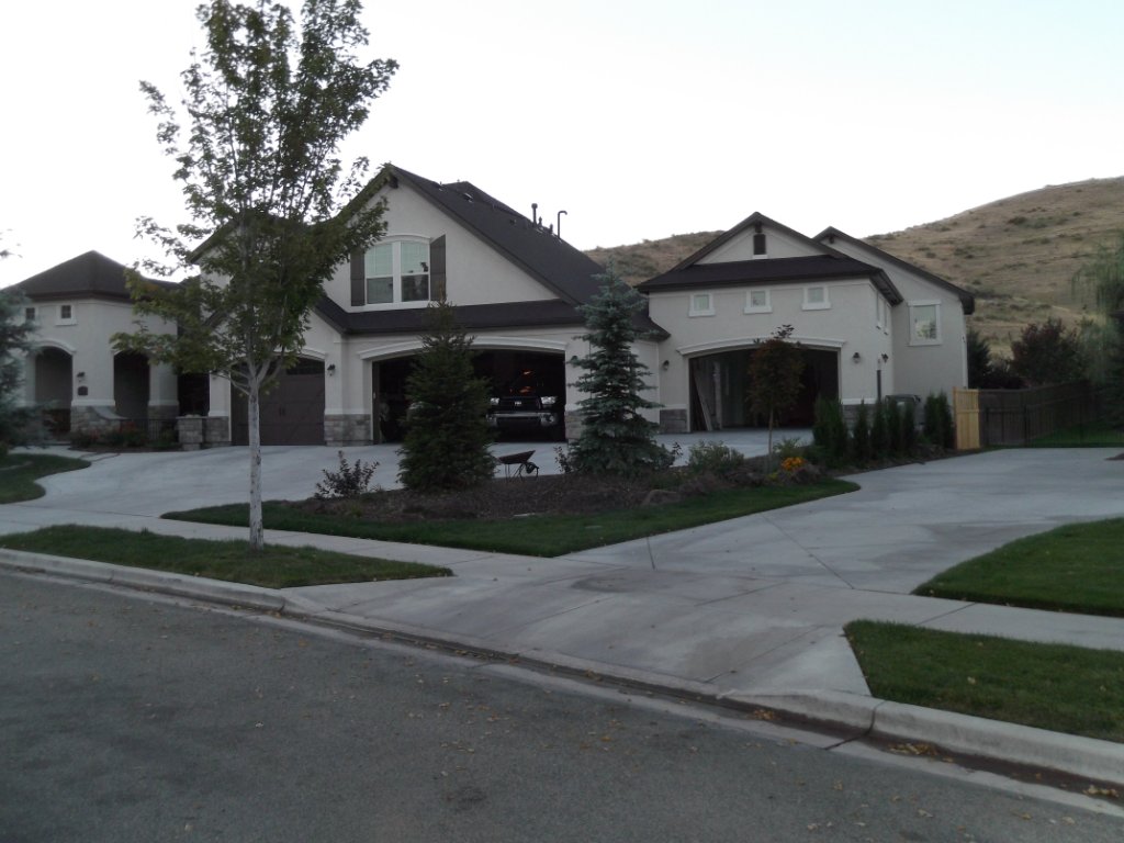

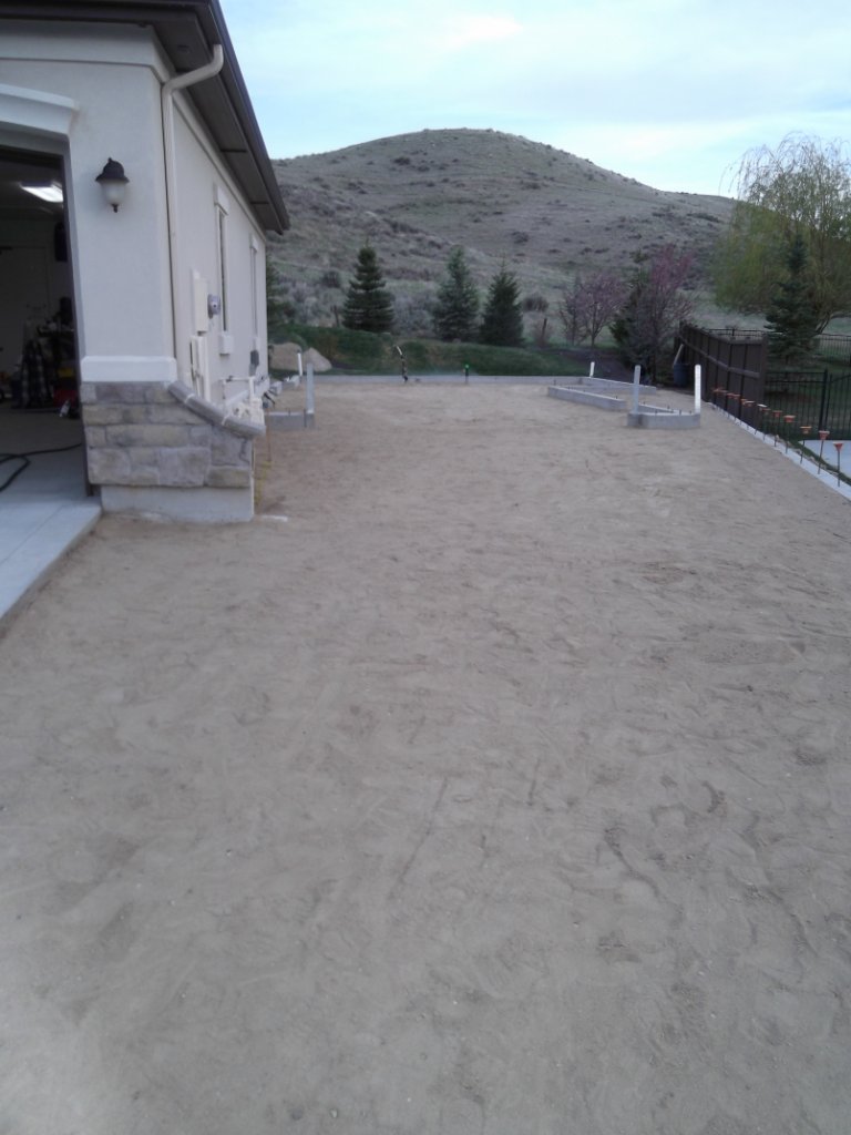

Hi Jody - Thanks! Live in an area called Hidden Springs, about 15 min from downtown Boise, you in town? coming over to help sand? Beer frig is stocked.
I built a shop next to my house back in 2013, has worked out pretty well except it could be bigger!
