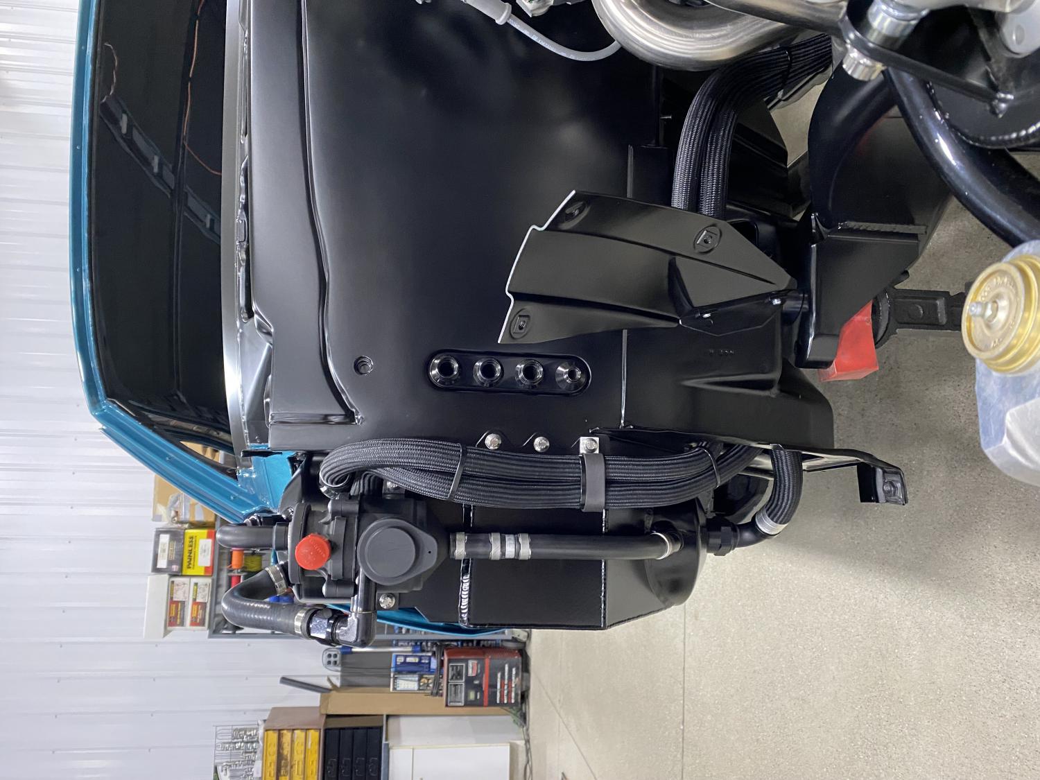

Originally Posted by thedugan View Post
Amazing work and car.
Why does Matt chop the bottom of the rad support off? To center the radiator? Or for a floating mount?
The stack up of radiator, innercooler and condenser are so big is has to come out to fit and give space for induction tube. Plus cutting the sides and bottom off core support give more area for air to pass through for better cooling
