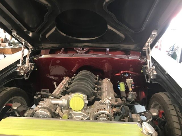

So I thought I would finally do a build thread on my car. It's a 68 Acadian that I orginally bought for $700. When I got it, it was white with black racing stripes. I fixed the car up on a pizza shop manager's wage. I had it painted cherry red, rebuild the 350 and th350 and put on 15" cragar rims with BFGoodrich tires. Now that I'm a cop and make way more money than I did back then, I'm doing the car again...but the way I want to. My plans are as follows:
Pro Touring theme
Suspension, brakes and tires:
18" New Gen Splitters, polished lip and brushed centers. 305-30-18 in the rear and 245-35-18 in the front.
Speed Tech Performance subframe with Speed Tech high clearance tubular control arms.
Speed Tech 1.25" solid sway bar.
Unisteer rack and pinion kit
Ridetech single adjustable coil overs
Wilwood 6 piston calipers with 12.2" rotors
Prodigy bar rear suspension (airbar with adjustable arms) with Ridetech single adjustable coil overs
Moser M9 housing
Moser 31 spline axles
Strange Pro Nodular centre section with 3.70 gears and half billet posi
Wilwood 4 piston calipers with 12.2" rotors
Drivetrain:

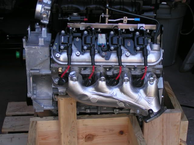

LS3 6.2L crate motor. Hope to be around 550 hp.
Speartech ECU with DBW
Comp Cams camshaft: 226/234 .598”/.612” 114LSA custom cam using EPS on intake and LXL lobes on the exhaust.
LS3 intake with LS3 ported and polished throttle body
Speed Tech Performance / Stainless Works long tube polished headers.
Wegner Motorsports polished diamond cut serpentine kit
Tremec TKO600 with MGW shifter
Monster stage 3 clutch
Interior:
Flaming River polished tilt steering column
Flaming River Waterfall leather steering wheel
2005 GTO leather power bucket seats in front and GTO rear seats
Custom console with 7" LCD screen
Thunder Road gauge cluster
Speedhut gauges
Vintage Air Gen IV air conditions
Billet Specialties air conditions louvers
Body:
New sheet metal includes:
Goodmark: quarter panels, inner rear wheel wells, deck filler panel
Auto Metal Direct: 2" cowl hood, inner fender wells, rear cross rail, rear tail light panel, quarter panel end caps, door skins
DSE deep tubs

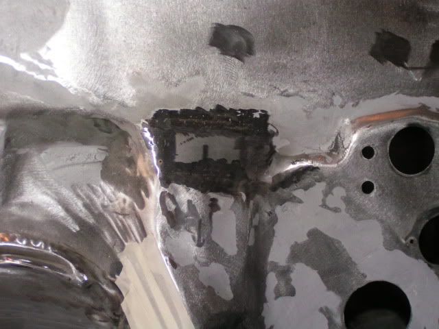

Firewall has been completely smoothed
Paint will be House of Kolor's apple red with black base coat
Stereo:
JL Audio stereo (haven't decided what but will be big)
More to come, but in the meantime here's some pics:

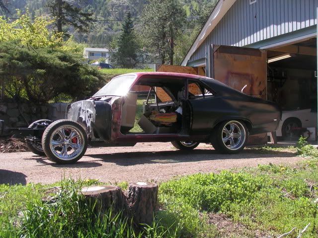

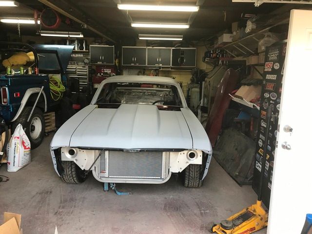

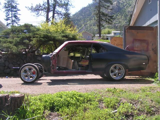

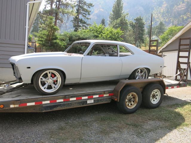

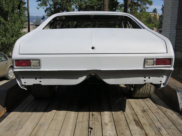

Here's what the car looked like before I started tearing into it again.

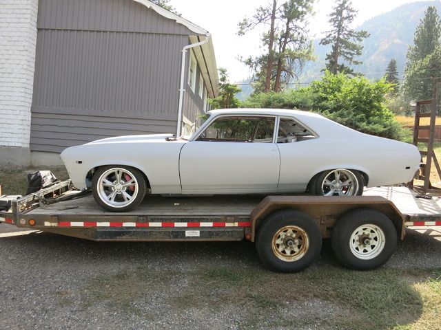

Here's the car as it sits today
