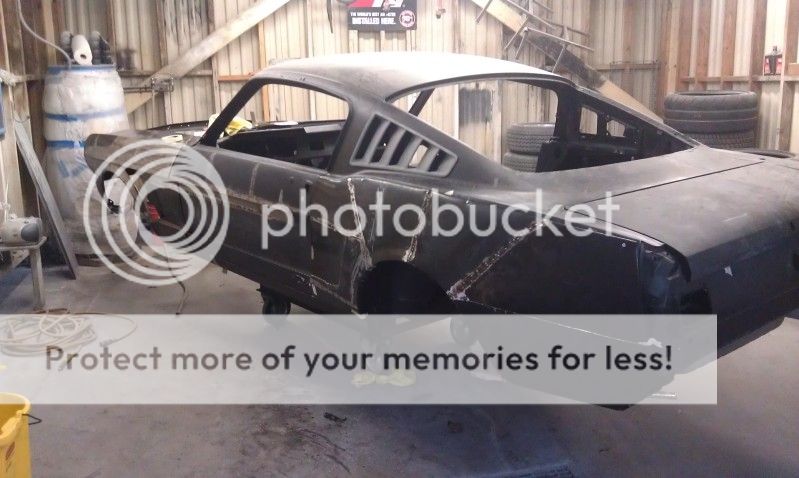

One day I noticed that Mark of Lateral-Dynamics fame was selling a little '65 Fastback project car. For five thousand dollars, you can't really go wrong. When it comes to buying fastbacks in that price range, something resembling a tear drop shaped roof with some other metal attached is usually all one can hope for. So, I bought it. It needed repair work on the quarters and doors, nothing unusual. It really wasn't terrible. After blasting the car we discovered there was just enough rust though that about every respective corner of the car needs a spot patched here or there.
After blasting it and getting it in etch primer I let the car sit to save up a bit of money. All the while trying to figure out what to do with it. Every time I looked at it, I thought it looked really wimpy, like a secretary's car with a cool roof. First I lived with the look. I told myself as long as it had a cool stance I would be happy. Then I realized I wouldn't be able to stuff big tires under the car. The rear could be mini tubbed, but the front was a problem. I looked at fender flares, I mocked up some off the shelf fiberglass "E2" flares that help make '65s look like bastardized Eleanor cars. Those didn't work. Next I moved on to modeling some out of high density foam. Those still didn't give me the look I wanted. I started paying close attention to Ron S's "$5000 dollar budget Mustang." It is low, wide, and rounded compared to a stock little slab sided Mustang. Campbell Auto Restoration did pair similar to Ron's, and after seeing those I decided that was the direction that I was going to head in.

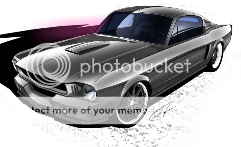

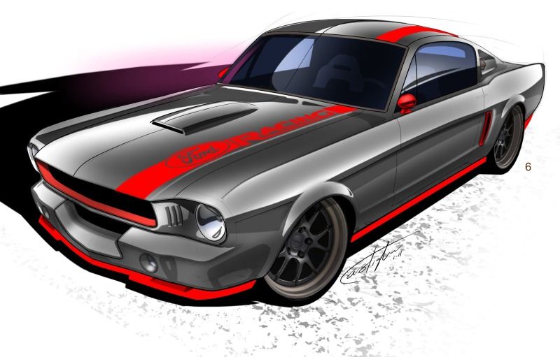

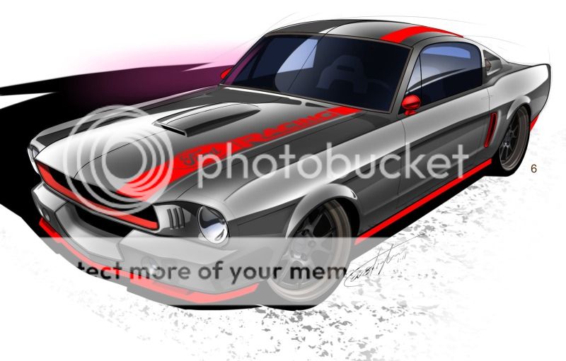

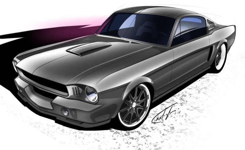

I figure most of you probably probably didn't bother reading my ramblings. That's okay. Mike Casti who is okay at sketching out Muscle Cars helped render things. My skills are limited to pencil and paper. Casti's are pretty much limited to the computer Chrysler sends him for work.
I wanted this car to be a little more obnoxious and racer car looking than the Camaro. Here is a rendering which draws its inspiration from a GT3. Now that I think about, it has to be blue and white!

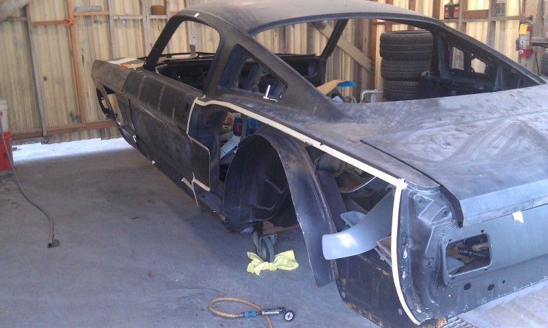

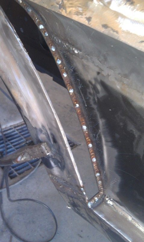

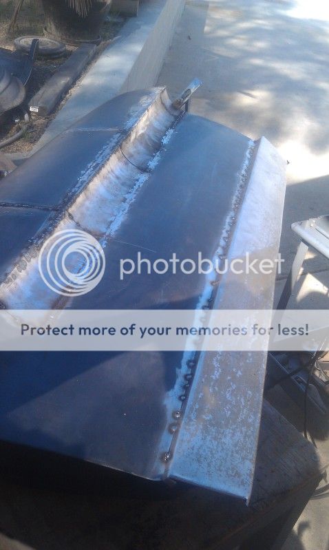

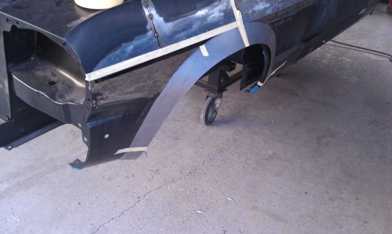

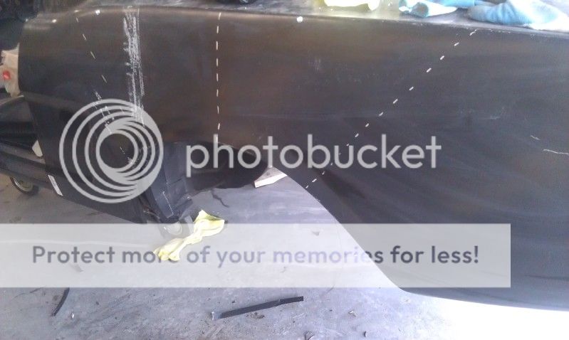

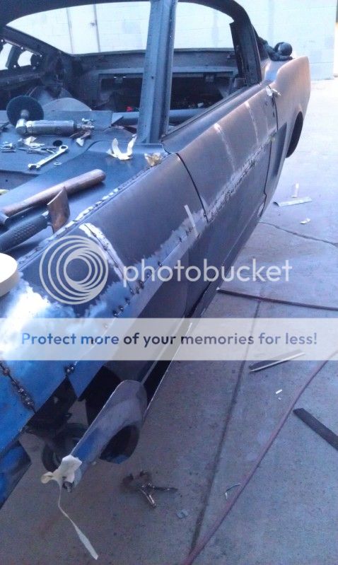

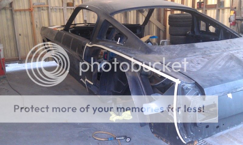

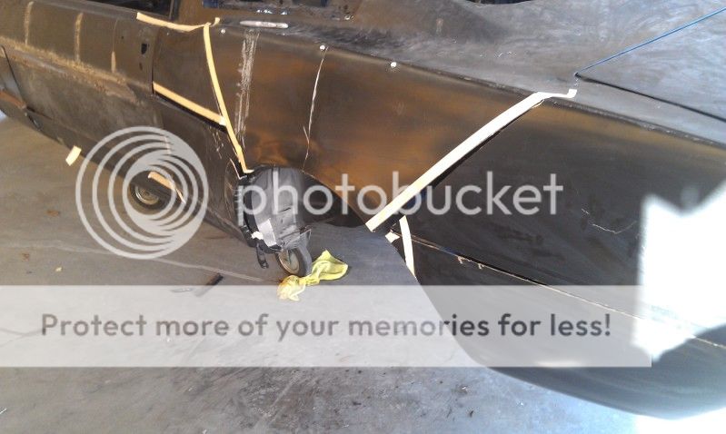

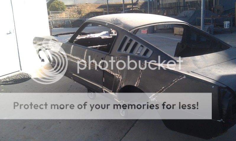

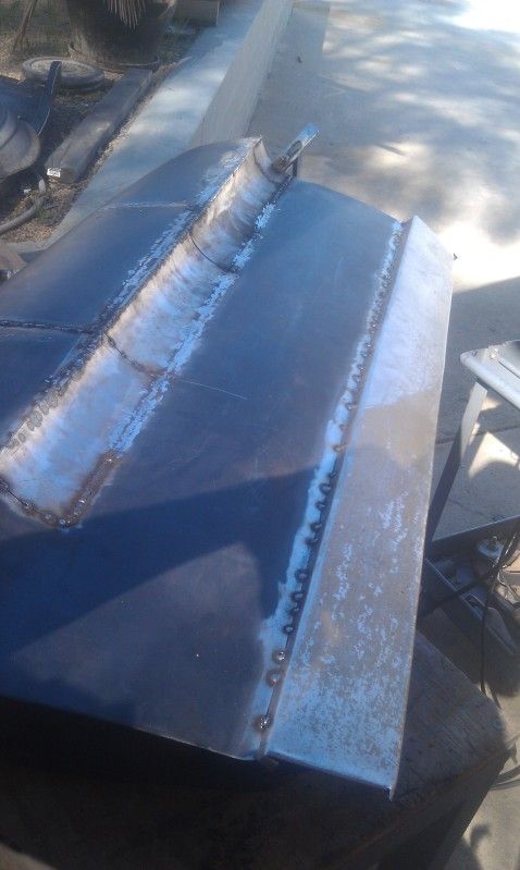

Getting started on the fender stretch I realized how weird it would look it if the doors were completely flat, while the fenders and quarters bulged out. Thus, I decided to carry the stretch all the way through the doors.
To maintain the location and the subtle, natural curve in the upper side body line elected to make a bunch of vertical cuts and pull everything out and up. Because the width increased from the door handle to the center of the wheel opening I was able to get by just adding in a a tapered strip, without ending up with a straight line.
I mocked up a fender flair on top of the stretch but ultimately decided it looked too tacked on. I want the design to flow and like something Ford could have done, rather than something aftermarket.

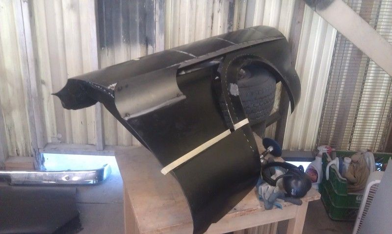

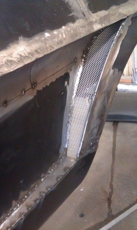

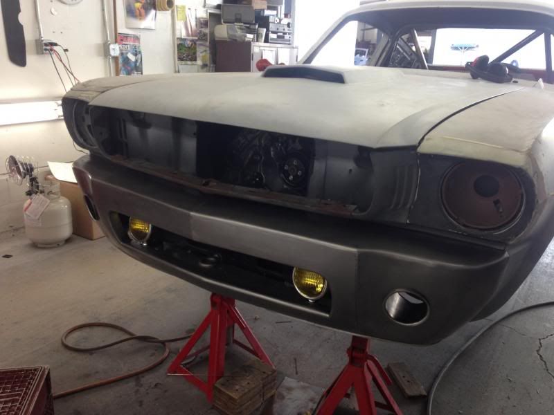

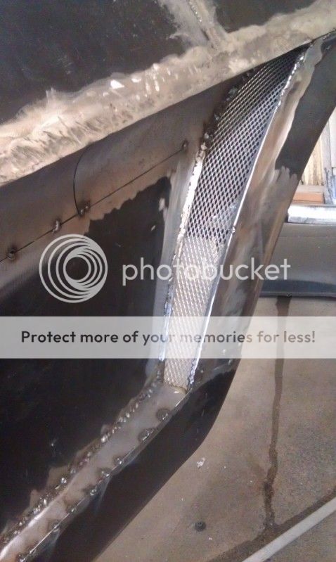

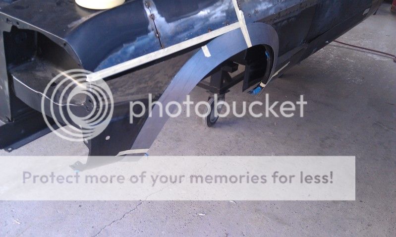

With the upper part of the fenders and doors cut, I needed to bring the bottom out as well. To accomplish a little bit more of the "race car look" I decided to add fender vent behind the front wheels a la the Ferrari F40, Carrera GT, Viper, etc. Besides, doing this meant that I wouldn't have to stretch the middle of the doors
To create the smooth curved transition I used a small slip roller.

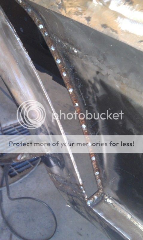

To finish off the the opening I bent a little bit of round stock on the tubing bender. This was also done to add a little bit more strength just to insure nothing buckled, or bent excessively.
I couldn't help but toss in a little bit of mesh just to see what it would look like.

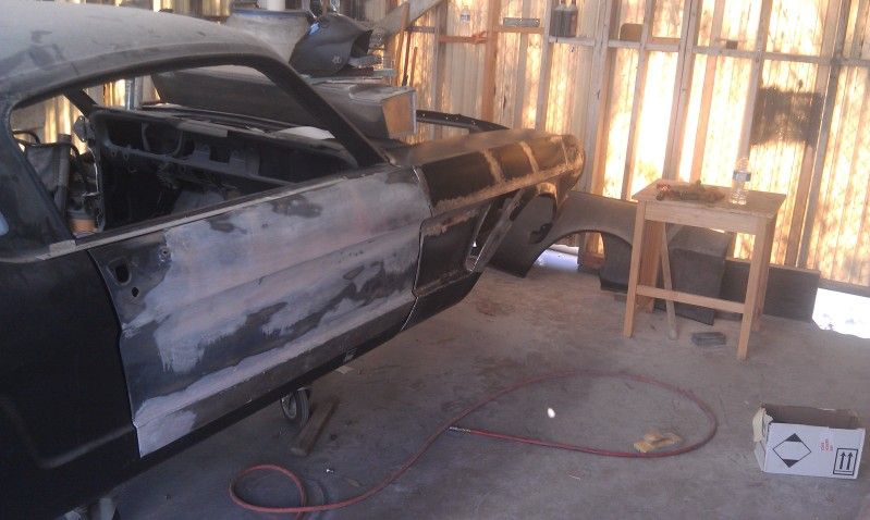

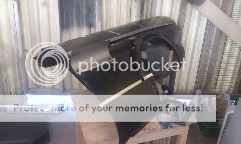

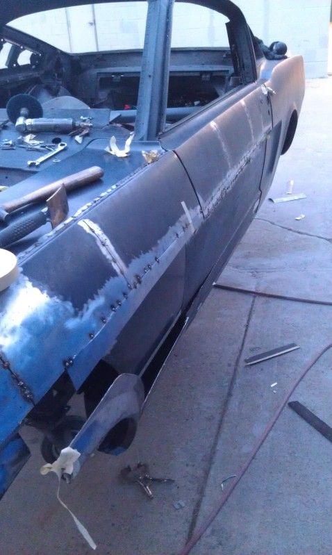

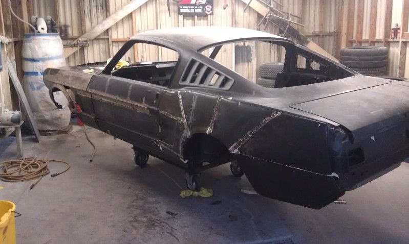

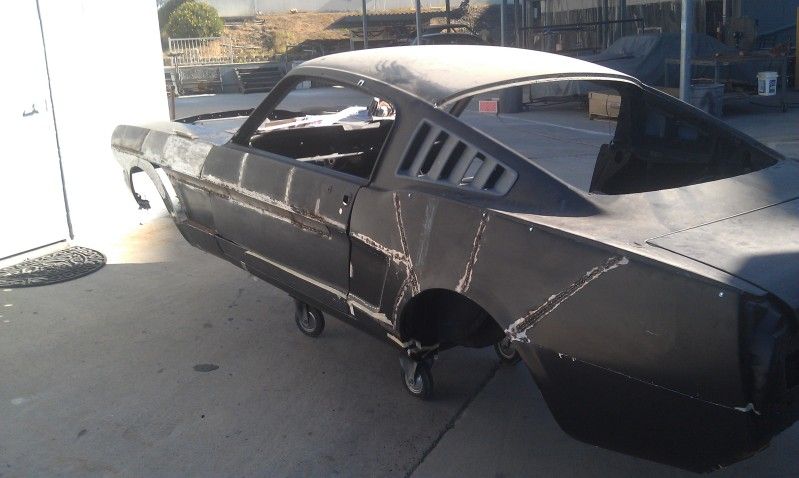

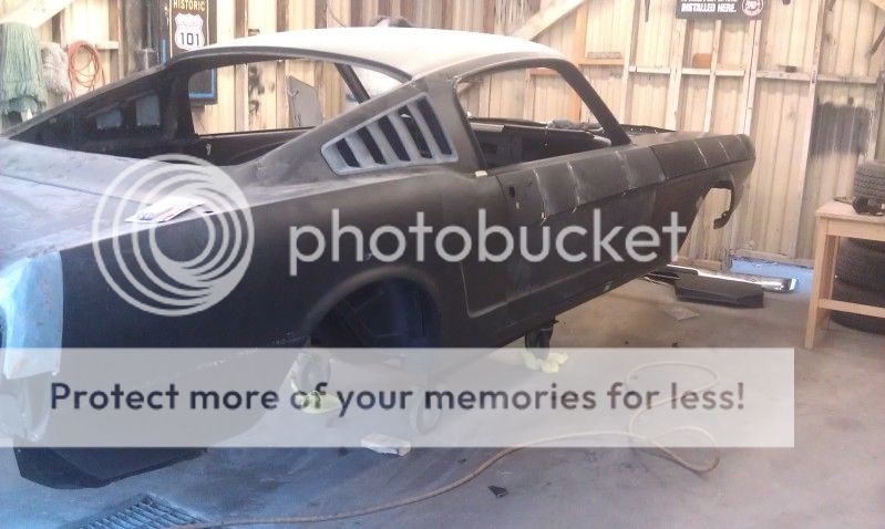

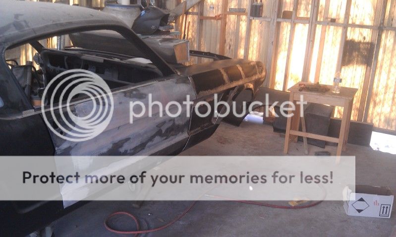

With the upper part of the door in place I moved onto the bottom. Because I added the fender vent in, I also needed to add some metal to the bottom of the door and since I there was rust in bottom corner I just replaced the whole bottom part.
After doing this I decided to to start playing around with one of the quarters so that I could what one whole side of the car would look like.

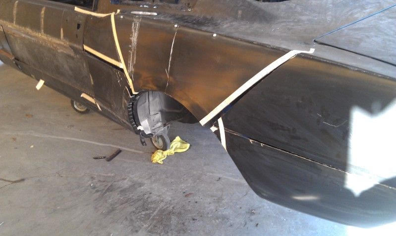

Off with the old!

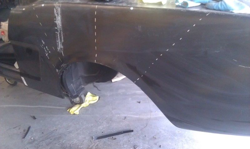

I think I've said this before, but I really have no idea what I'm doing. I usually as the guys if I can try something, and they say "sure, go do it."
These seemed like good places to make some cuts...

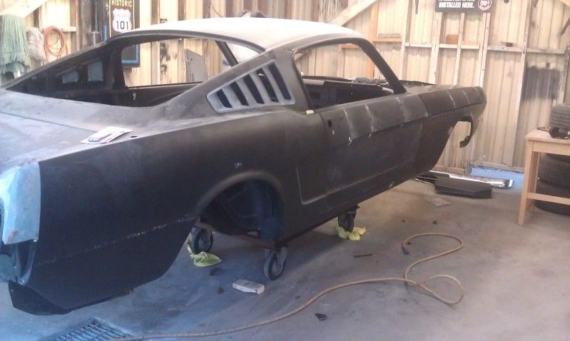

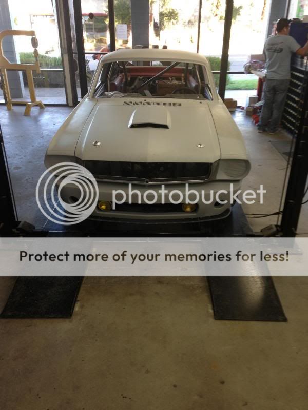

I tech screwed the fender in place. I need to spend some serious time grinding and hammering before I put it on. Then again maybe I should just buy another and start fresh. My still very basic skills have come a long way since I started, and I probably spend more than half my time fixing everything I do, usually at least twice. The doors and fenders have been cut countless times now. Actually, I've lost count

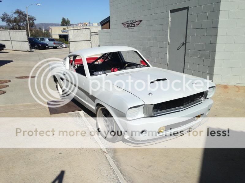

Rolled out into the light, it still looks as ugly as ever.
