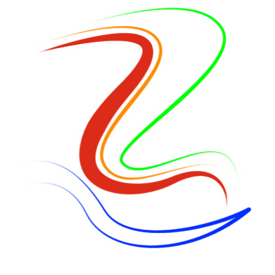

You can also "Stroke" a path in photoshop. When you stoke the path you can also set it to simulate stroke pressure, so that it gets wider in the middle and thinner on the end.
Make your path with the pen tool. Make sure the pen tool is set to paths and not shapes. Once you have your path defined, right click on the path or anywhere in the screen for that matter, and click stroke from the pop up. You must still have the pen tool selected to do this. The simulate pen pressure is awesome and it will use the last brush selected in you brush tool.
Really a cool way of simulating pressures.
