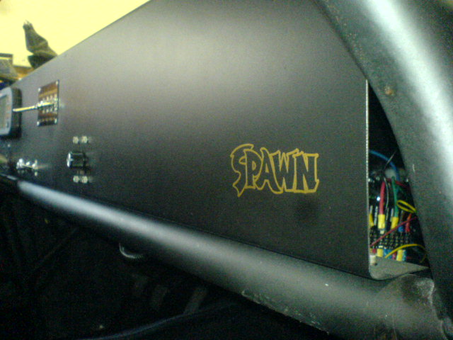

It's all together, interior is pretty much finished up, here's a few pics and videos to sum up the last 7 months or so -
Got it all legal, put some street miles on it
Recall is fun, I love the Racepak

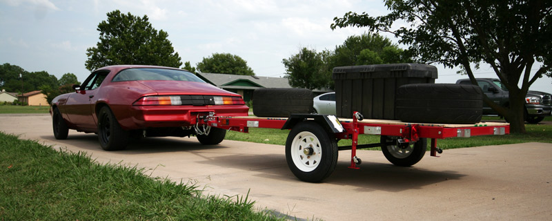

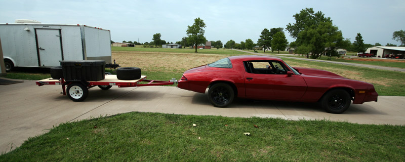

The little trailer fits like a glove behind it
