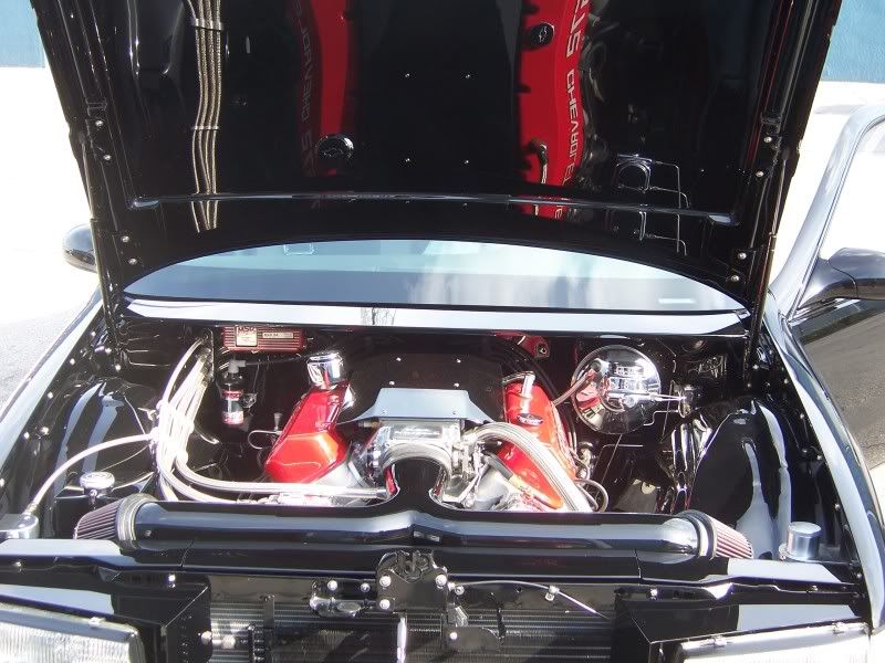

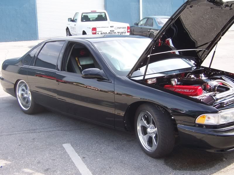

Definitely.
This boat flies!
Listen to him cackle!

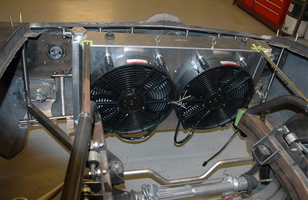

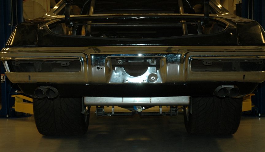

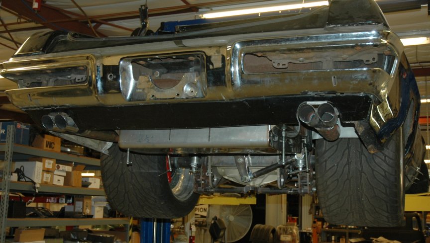

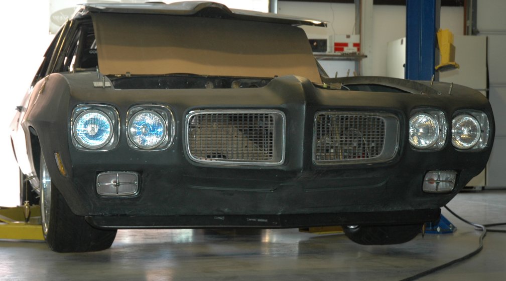

Update. Glass front end, radiator and intercooler all mounted. Engine going to dyno in Feb. We made some changes there. Were hanging the dual master pedal assembly with balance bar (adjustable from dash) and putting the floor/tunnel in. The custom 28 gallon stainless gas tank is done and installed. Has a triple trap door internal sump, Magnafuel EFI pump and #12 out/#10 return. The radiator is a 34" wide core dual pass, with a pair of 2 speed 17" derale fans. Water pump is mounted on the radiator tank. Both tank pics are with the car on a lift.
