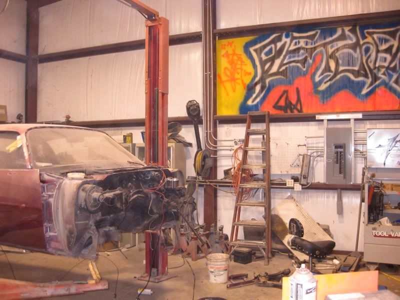

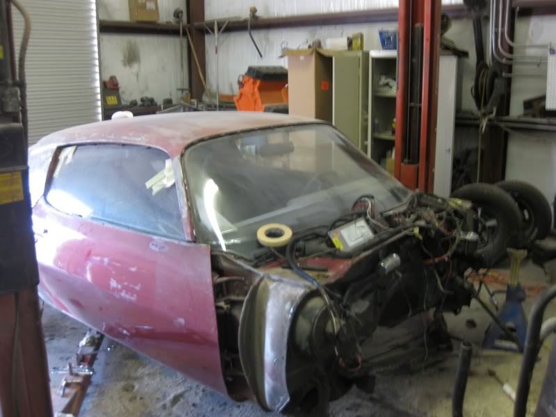

Had a few minutes at lunch, so I ran by the shop and grabbed a couple of really crappy pics!! I really need a new camera!!!
Nothing major, just a couple shots showing it stripped. One day I'll learn how to pull a motor without making a mess!! There must be 40lbs of kitty litter on the floor. Tonight will be clean-up the shop and strip the interior!!!
Subframe!! It will be blasted, primed and painted semi gloss black!! more on that later!!
Two really crappy pics in the shop!!

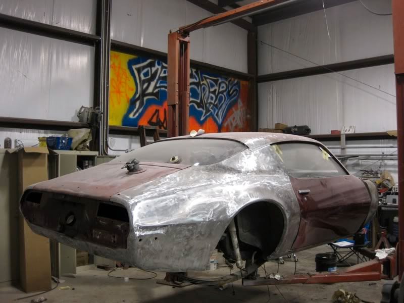

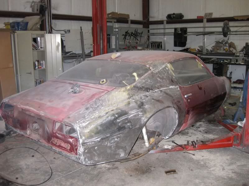

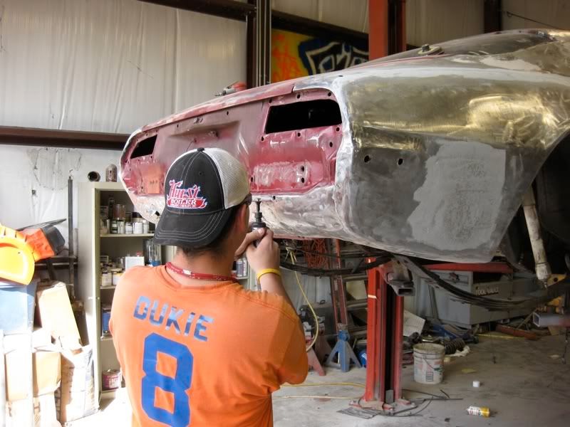

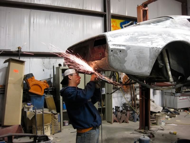

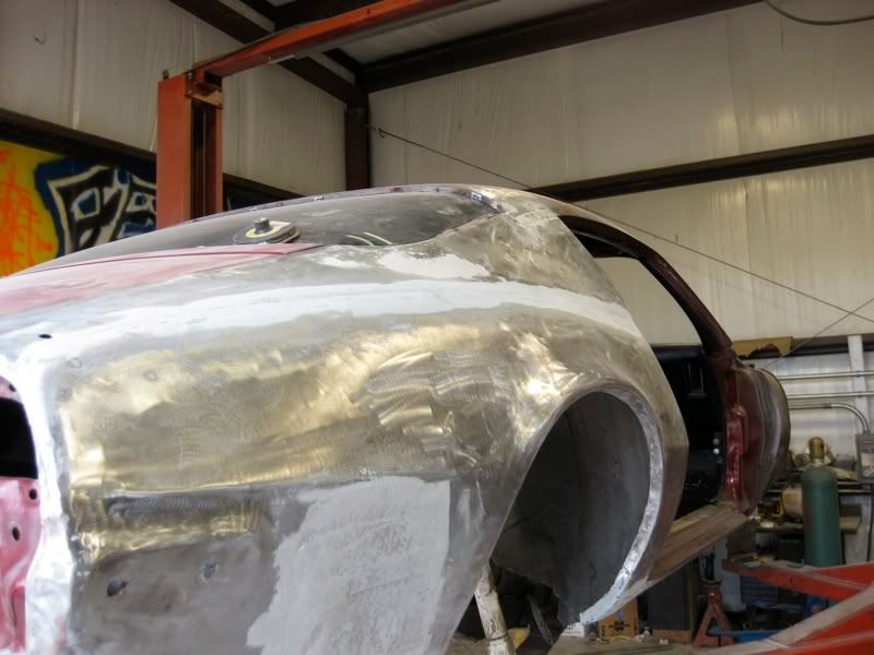

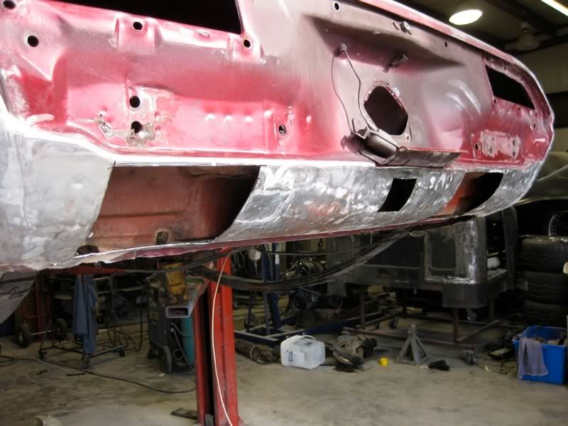

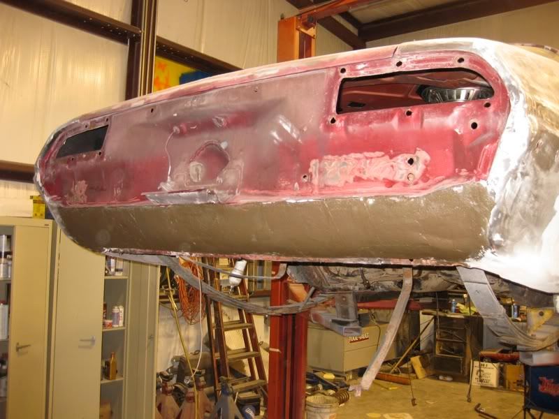

Wow! What an awesome weekend! Really got a lot of stuff accomplished even though the pics don't show much. Spent Friday evening, Saturday and Sunday doing rust repair!! Woohoo! We all know how much fun that can be!! After this weekend we are 42 hours into the car, spent 9.5 hrs yesterday on the tail panel alone!! Car is really in a better place. Cut about 2 sq feet of rusted panels out and replaced with new metal. Had some major issues in the tail panel; little small 1/2" area in the rocker and some other pitting issues here and there. I forgot how much fun it is to tack weld for 4 hours!!! lol But everything is good to go now. After we welded everything in and smoothed with the grinder, we then covered with a skim coat of Fiberstrand filler. I've shaved hundreds of doors in my life and have always had the best results with a nice skim coat of glass reinforced filler down first. Anyway, onto the pics!!
Shot showing the skim coat of glass filler put on the shaved markers, quarter seam, etc.
Cutting out the rust, this is one of my helpers Micheal, couldn't do it without him!
After we got it all cut out, we got two good places for exhaust outlets and a perfect spot for the trailer hitch to come through! :banghead:

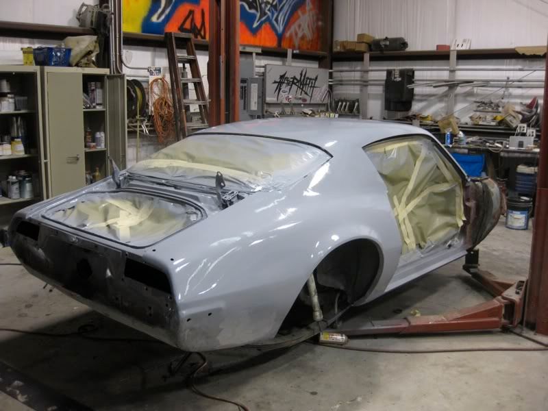

New metal welded in !!
Little Grinding
Little Filler

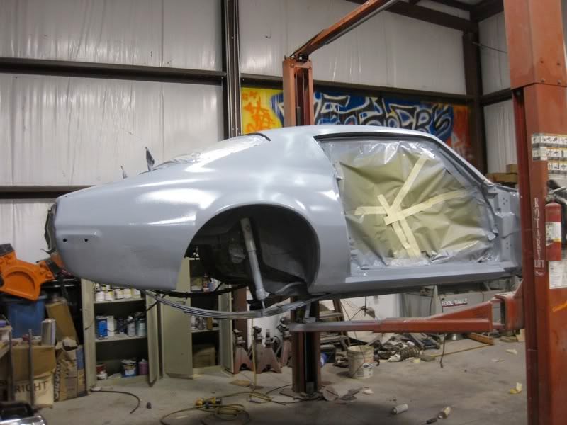

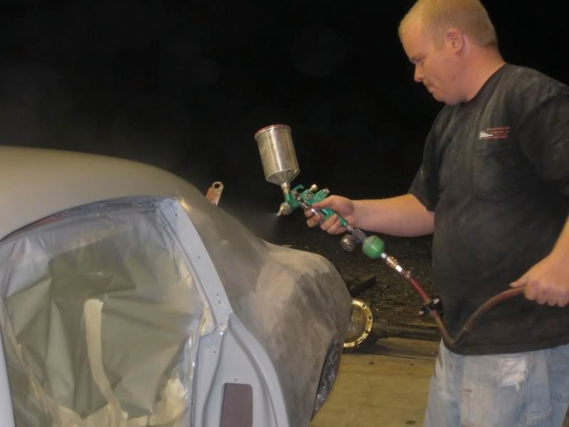

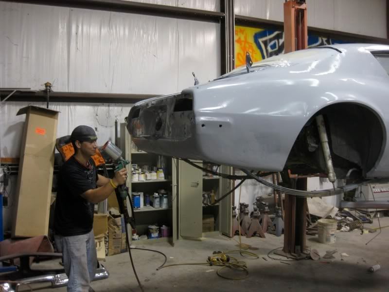

Ok all the rust repair is done and the big dents have been pulled. The bare metal has been killing me, seems like I all I do is remove surface rust that seems to pop up overnight, lol :pat: So last night we put the car in a coat of epoxy primer. Nothing special just thought I would post a couple pics
