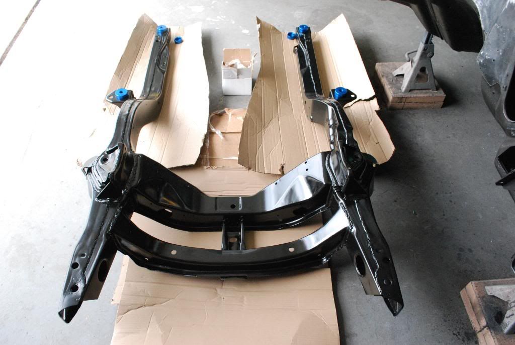

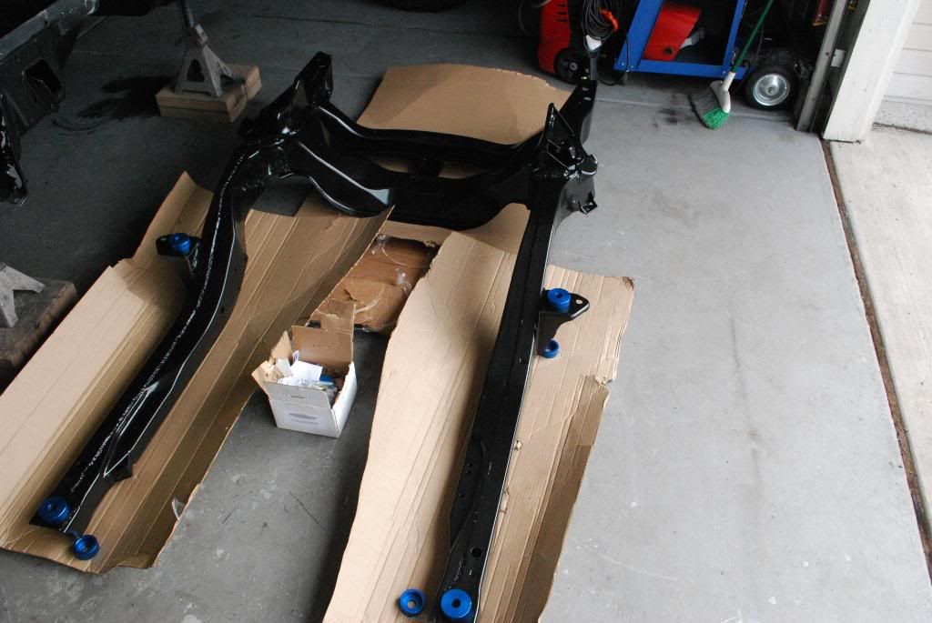

I went and picked up the sub frame from the powdercoaters today

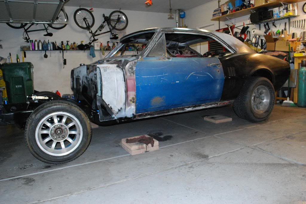

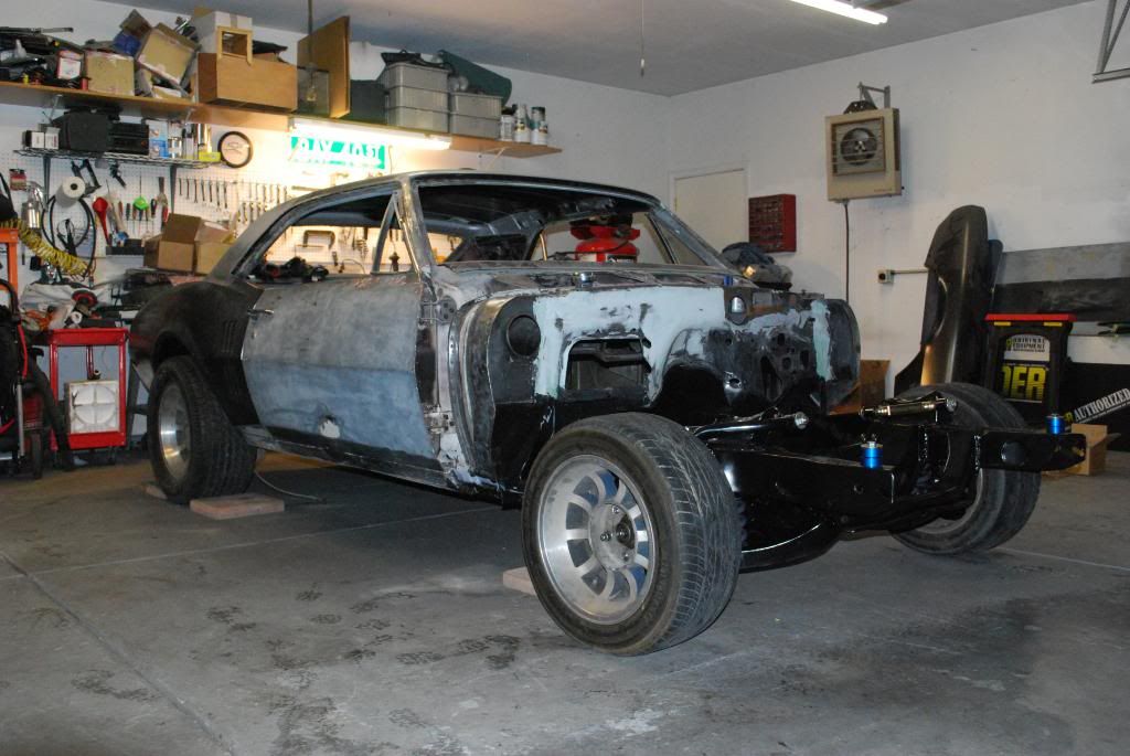

Thanks, I will. The subframe is now mounted and I stuck the original rear end back in; I have two tires on the ground Once I finish painting my lower control arms and engine brackets, I'll have a roller...

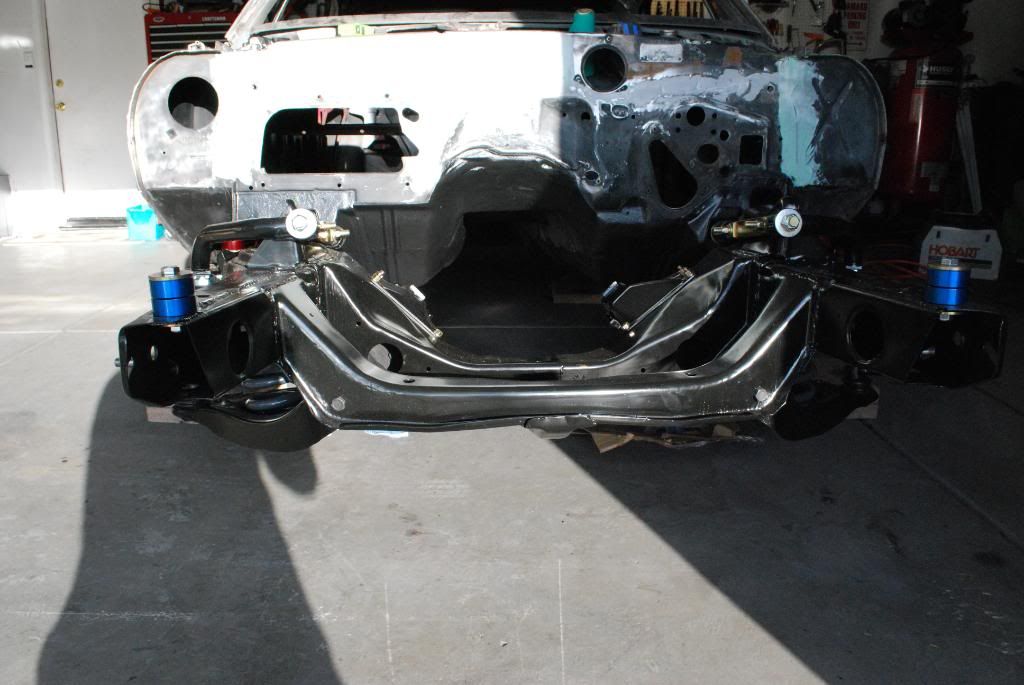

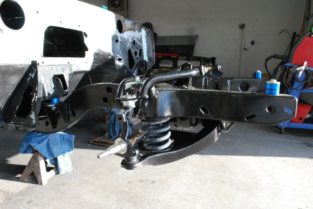

I mounted the subframe using Global West solid bushings, mounted the GW upper arms, painted the stock lowers. Upper and lower arms have poly bushings. I also mounted the stock rear-end for the time being so that I could get this to roller status. The brakes will be C5; I picked up a set of calipers for a good price, so I guess I'll be giving Kore3 a call for some brackets and hardware.
