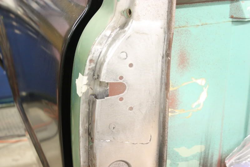

This is a great thread. Especially for me as I am also trying to learn with the new Tig welder. I have been reading and practicing. Things are going better. I'm a visual person. Here is the result of the best I have done so far. I am far from happy, but mind you I've only burned about 4 filler rods with the TIG so far.
I spent a lot of time fitting the panel I made. It was good, but the second one is better. As usual. I am getting ready to start welding the second one. I have it tacked in. Look along the bottom. I was trying to keep everything fitting as I went using a hammer and dolly. I didn't make a weld longer than 1/2" at a time before cooling. I was also hammering the welds as I went to try and keep the panel from shrinking in. When I was done and started the grinding/sanding I realized the panel I added along the bottom was slightly proud. You can see this in the photo. Any suggestions as to how to work this out? A small amount of filler will cover as it is only about 5-10 thou. proud, but I would like to make it better. The same thing happened with the 2 plug weld spots you can see.
This brings me to my next question. What happens when you are butt welding sheet metal and you can't get to the back side to hammer the welds and work the joint? No matter how slow I go and how small the welds are, I almost always end up with the weld bead/HAZ low. Do you use a stud gun or something to raise that area? I will be getting to these types of welds very soon. That's enough for now. Any comments/advice good and bad will be greatly appreciated.

I'm going to let better body men than I answer these questions -- but I would say on the area being "proud" (high) after hammer welding is because you stretched the panel too much. You don't have to pound the weld perfectly flat to save yourself a lot of work with the grinder. 3 pounds of shizzaz in a 1 pound can. When you're fit up is really tight - you weld - you hammer flat - the metal that is hammered flat is going to GROW not shrink.
Ever heard of a shrinking hammer? They work if you know how to use 'em.
Hammer and dolly work is a black magic art form... I've seen people take a perfectly good panel and RUIN it because they just think you pick up and hammer and start banging away. They stretch the metal - leave hammer marks all over and then start trying to shrink it when they should have just left it alone! LOL
If you "pull" this area out with a stud gun - you'll then most likely end up with an oil can.
Ever heard of Bondo? Works real well on low areas... don't be afraid to use it. Personally - I'd prefer a low area over a proud one.
Not sure what the right answer is on the "can't get there to work the area"... I'm all for "do my best and skim coat it".

I'm going to let better body men than I answer these questions -- but I would say on the area being "proud" (high) after hammer welding is because you stretched the panel too much. I know what you are saying here. I don't think that's what I have going on here. You can pick up an edge with your finger nail as you see it in the picture. When I use my flat hand the panel is flat other than that edge. You don't have to pound the weld perfectly flat to save yourself a lot of work with the grinder. 3 pounds of shizzaz in a 1 pound can. When you're fit up is really tight - you weld - you hammer flat - the metal that is hammered flat is going to GROW not shrink. Agreed. This is how I was trying to raise the low area created by the weld. It absolutely works and it doesn't take much hammering. I guess I just let the 2 panels become mis-aligned
Ever heard of a shrinking hammer? They work if you know how to use 'em.Yea,but I'm not ready for that yet!
Hammer and dolly work is a black magic art form... I've seen people take a perfectly good panel and RUIN it because they just think you pick up and hammer and start banging away. They stretch the metal - leave hammer marks all over and then start trying to shrink it when they should have just left it alone! LOLI have a pile of scrap sheet metal from trying different hammer and dolly methods. On dolly, off dolly, on thumb, etc!
If you "pull" this area out with a stud gun - you'll then most likely end up with an oil can. That's what I thought, but I know I get the low areas after welding. Light hammering raises them but when I get to the bed, I can't get a dolly behind the panel.
Ever heard of Bondo? Works real well on low areas... don't be afraid to use it. Personally - I'd prefer a low area over a proud one. Agreed, but when we are trying to live up to standards of Ironworks and Jason(WAR) you get a complex. Yah know!
Not sure what the right answer is on the "can't get there to work the area"... I'm all for "do my best and skim coat it". I'm with ya at this point.
