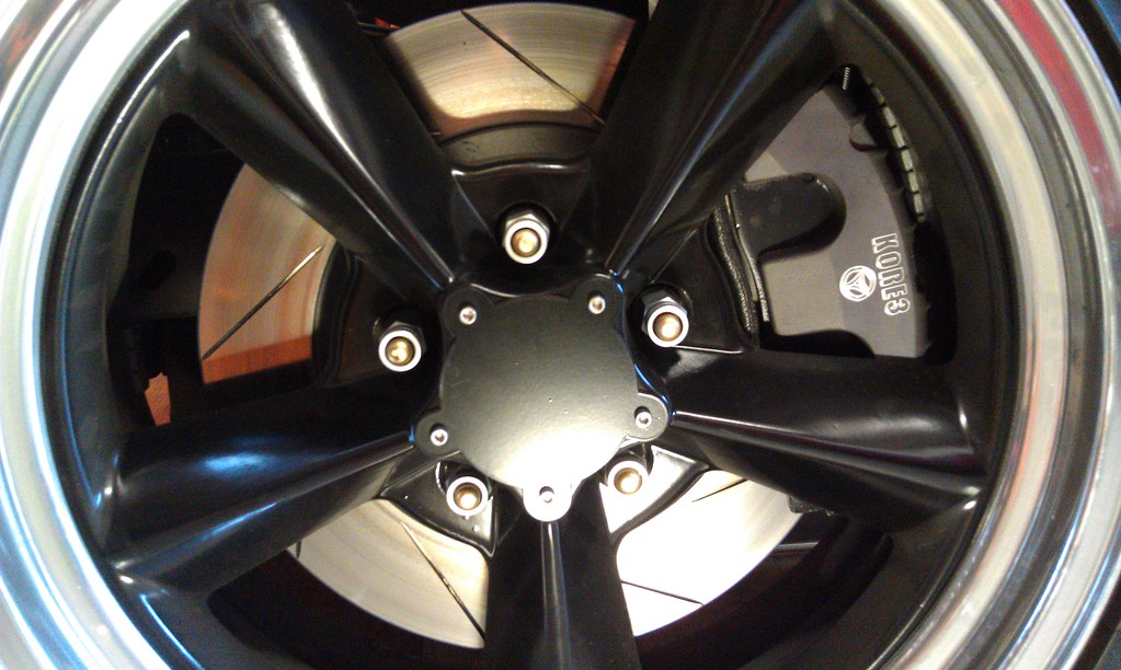

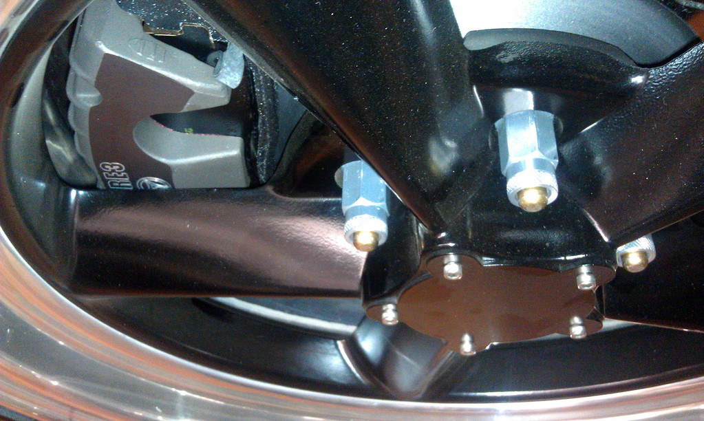

How's the spoke to caliper clearance in your new wheels?

It's about 3-3.5mm.

Thanks for the pic. Im looking to order a set of VWW also.

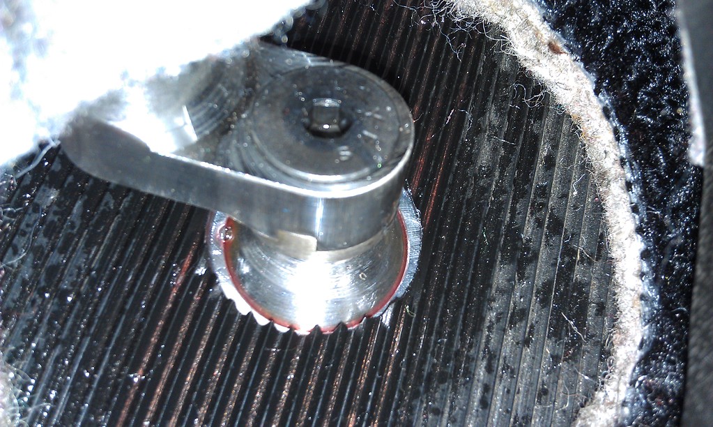

Got a break in the weather tonight!
Pads bedded to rotors
Big improvement in clamping power, Kore3 set-up definitely exceeded my expectations. Even with the rear drums they'd suffice for a recreational track day.
The Lee steering box mods (12.7:1 and 32 lb. valving) are exceptional. Lock to lock is 2 1/8 - 2 1/4 and I like it!
The American Powertrain White Lightning shifter felt very good but..........
See the bubble at 9 o'clock?
In twenty miles it's already leaked more than the Hurst unit in 500.
So is it me and my trans or

Sorry to hear about your t56 issues. On your wheels with the 3-3.5mm clearance that's without any type of spacer correct? Would you say that's enough clearance even under spirited driving and wheel flex?
No spacer and it should be plenty of clearance.
