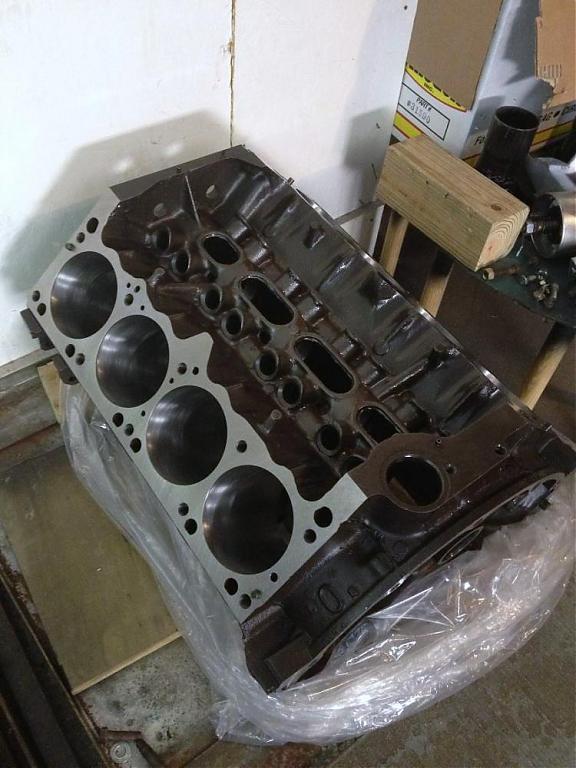

Very nice build. I really like the fact that you're using the 'LA" block.
Great revving motors. Can't wait to see more as the build progresses.
What heads are you using on the motor (I am asking because I had the W2 heads on mine) and yours in the pic look like the original style exhaust ports.
Thanks,
I am using Edelbrock Performer RPM that have been bowl blended by Compu-flow, the supplied edelbrock springs have been swapped out in place of a set of Comp Cams set to match the cam and also went to a 10 degree lock in place of edelbrocks 7 degree.

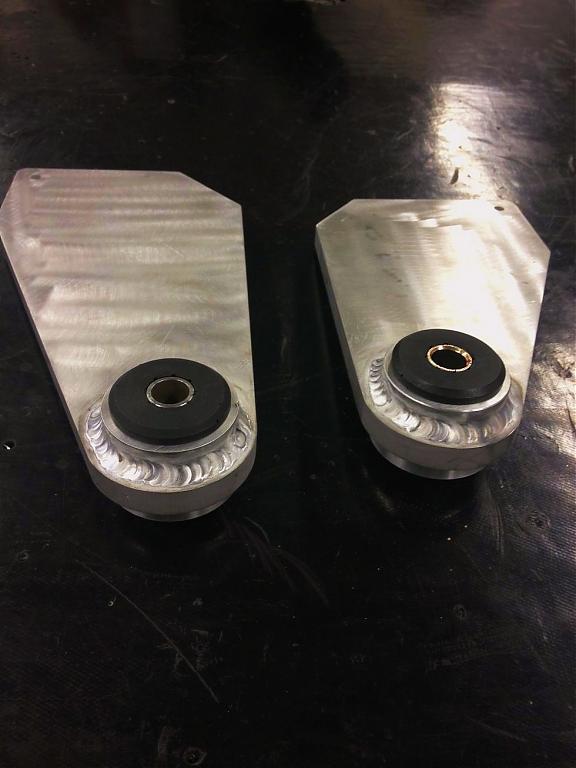

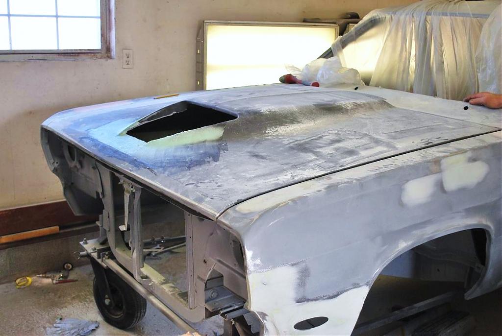

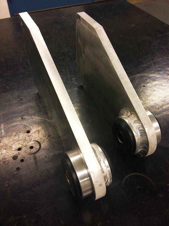

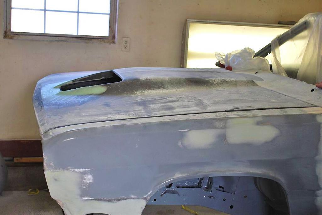

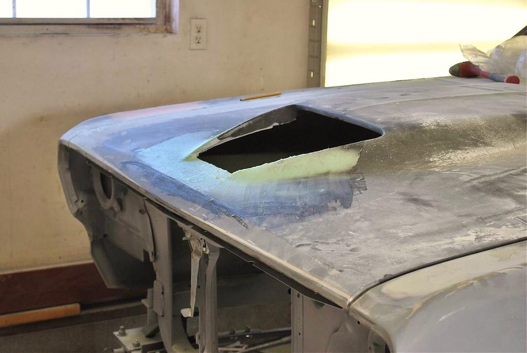

Well, I decided to open up the AAR style scoop and change the front lip design, it not completed yet but here is some progress pics. the original opening was 1.25" and the new one is going to be 3". I also made the motor mount extensions, there .500" thick and with a 1.5" dia bushing I should have the timing cover done in a few more weeks. Also test fit the holes for my shock tower coil over supports

I like the hood design. Keep up the good work!
