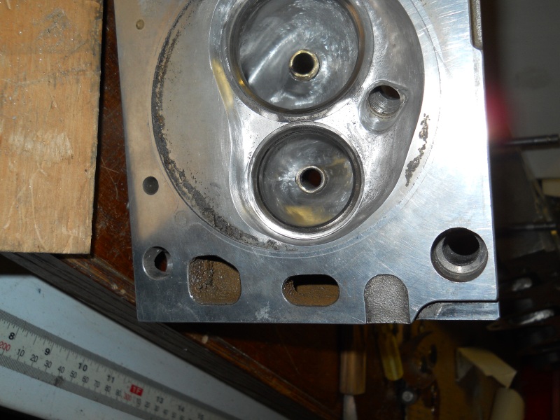

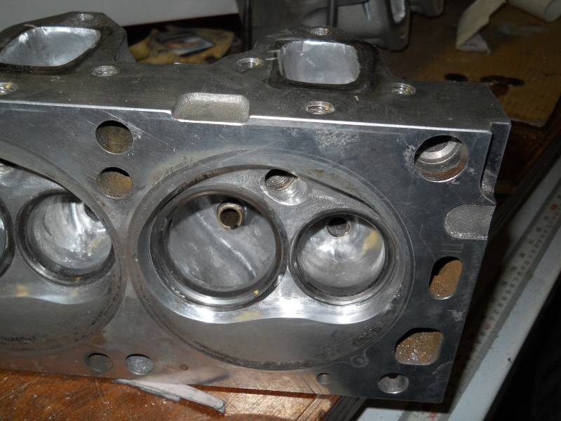

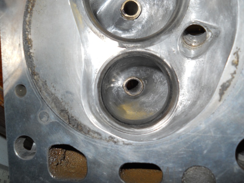

Anyhow... I worked the exhaust ports, mostly working on the bowls, on one head.
Started preliminary polishing.
I'm fairly happy, with how they are shaping up.

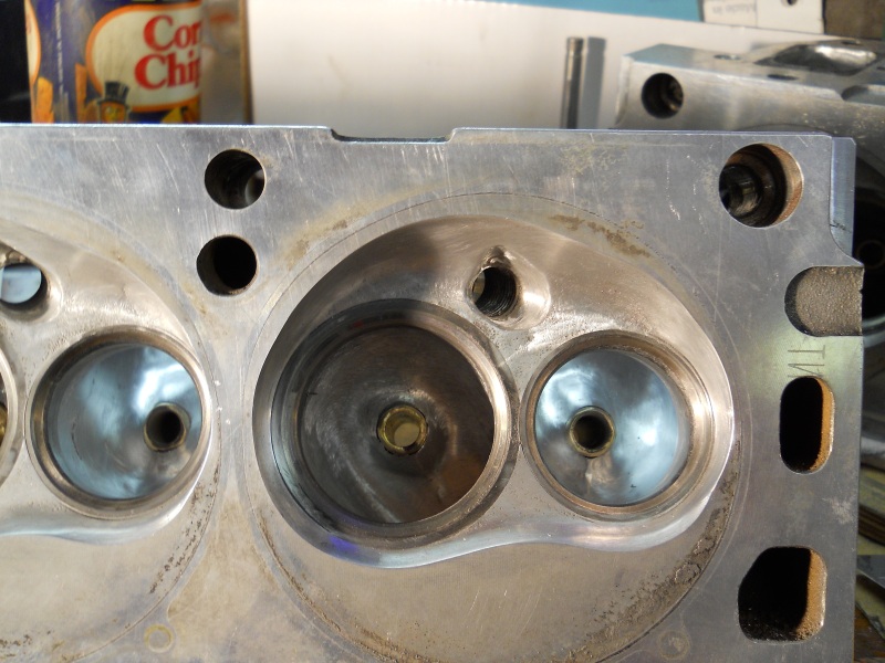

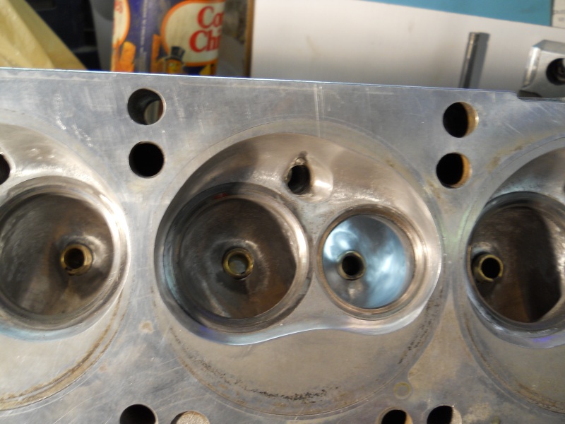

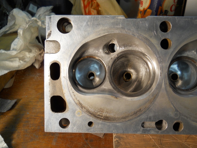

Exhaust are pretty much where I want them. Size wise I cannot go much bigger, based on the header opening, but I did radius the roof a little, incorporating a turn down, in the head itself.
Next I am revisiting the combustion chambers

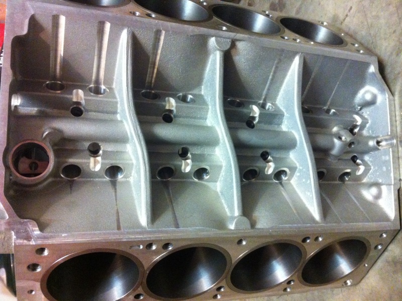

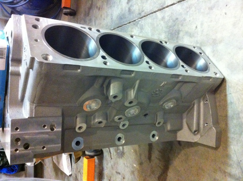

A chunk of aluminum arrived.

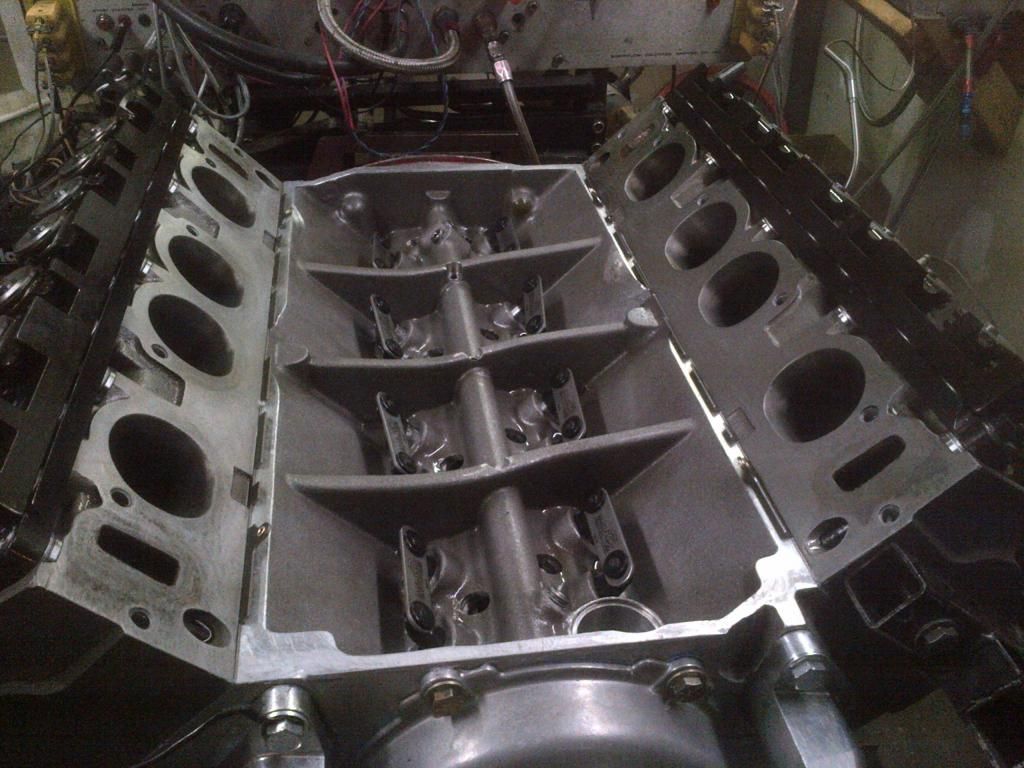

Nothing like being able to lift your sideoiler block over your head.
It looks like Robert changed some of the casting around the lifter bores.
Did you order your crank yet?

Hmmm, yeah appears so, but I haven't had the luxury of seeing many Pond blocks.
Thos intake ports of yours look "holy cow massive!"
