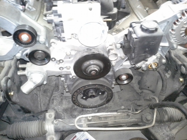

Russell, what frame number do I have? Always feel free to comment on what I'm doing wrong. It will save me time when I get this baby on the road. Here is a pic of the LS1 I put in. It has the LS6 intake, cam, oil pump, and injectors. I also put on the batwing oil pan. For exhaust I am starting out with LS7 manifolds. The accessory drive system is from Holley. I like it. Have had no issues during mock up and the surface quality is good. It will only take a small amount for work to smooth them completely.

Scott, you have Nerd Rods TriFive C4 Frame Number TFC4-0021. Just sold #33 and I'm working on the mild redesign to place an order for frames #34-36 to have on the shelf.
I need more photos to see where to give advice Mmmmmm, more photos.
I will say I'm not fond of bat wing oil pan. It can be a royal pain in the butt hitting on the front cradle. You really need the body on to make it fit and clear the chassis. They also get in the way of the exhaust most of the time making it hard to route.

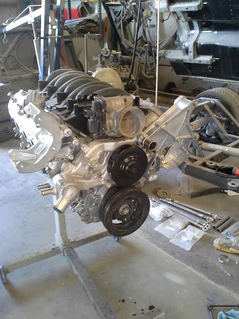

Here is a crappy cell pic of the motor mounted in the frame. The corvette cross member has the motor off set to the passenger side. I am going to modify the motor mount stanchions to center it up some. May be a half an inch.
