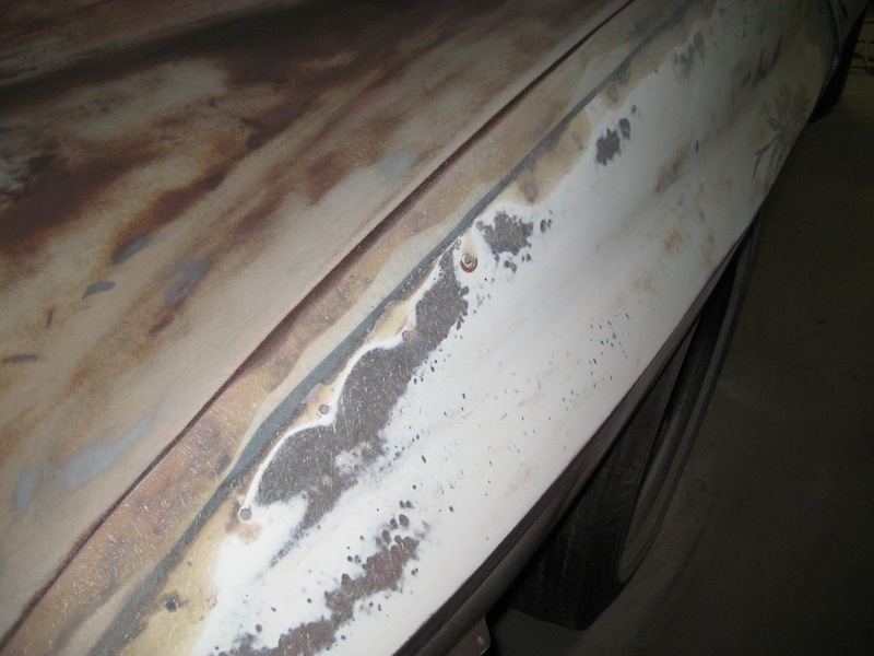

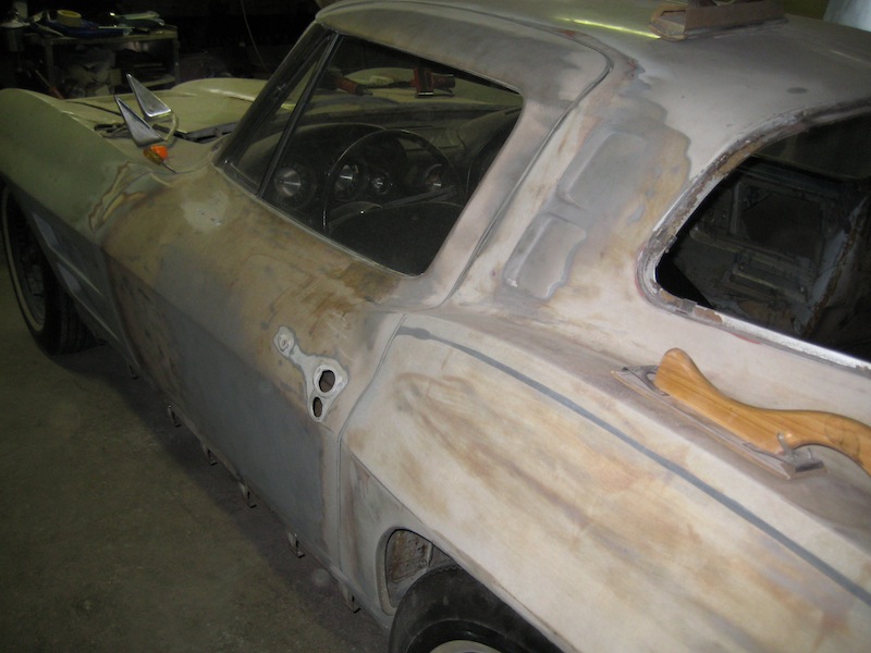

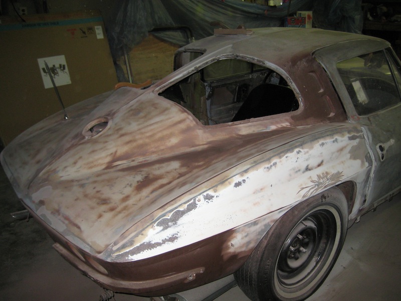

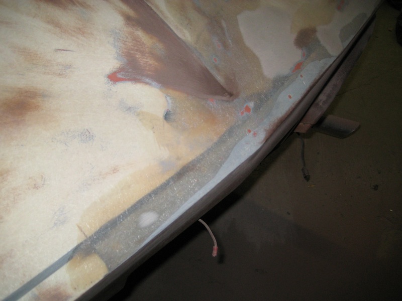

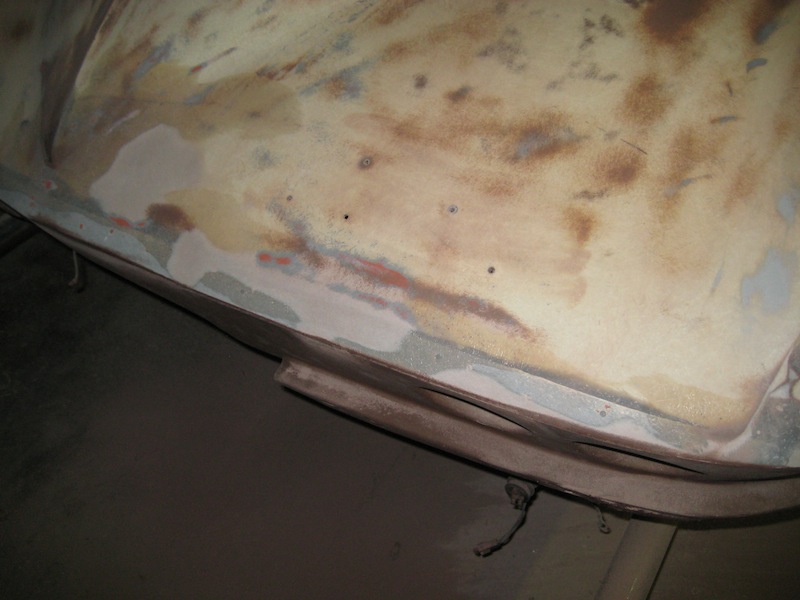

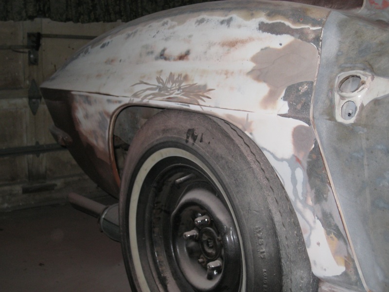

Default Some body/fiberglass work taking place
Name:  dave 63 052.jpg
Name:  dave 63 053.jpg
Name:  dave 63 054.jpg

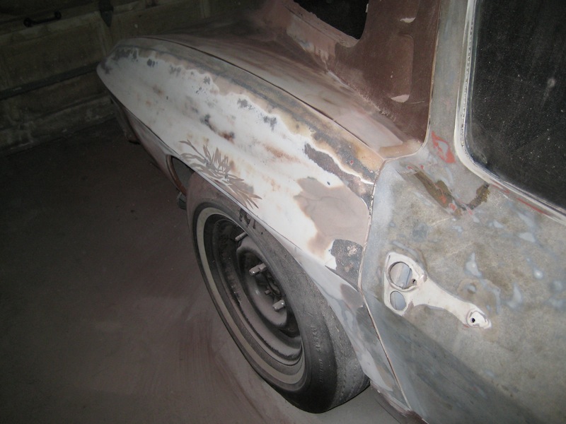

Found out that the entire right rear was hit and fiberglass repaired previously. Vette must have been hit hard from door back on that side. Repairs look good but will grind out and make sure so that no issues show up after paint and we say we should have done it. At least this way we know it is done right.

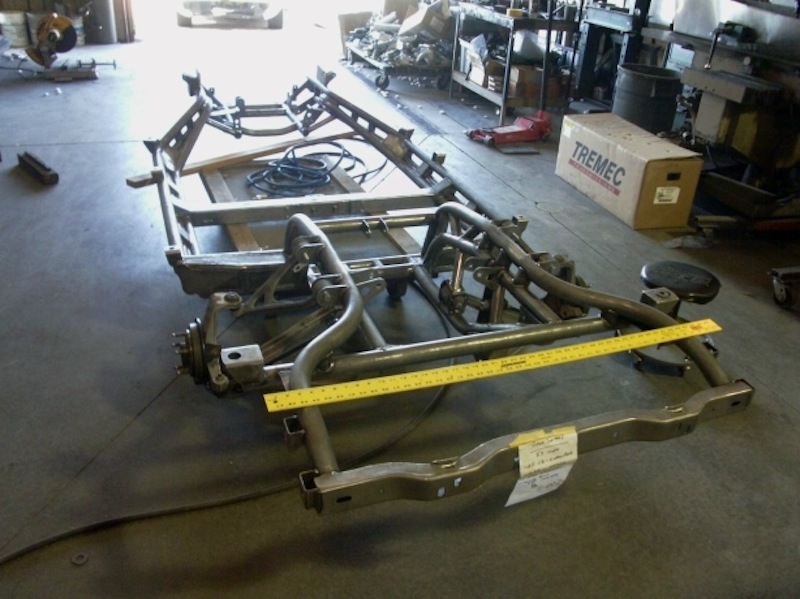

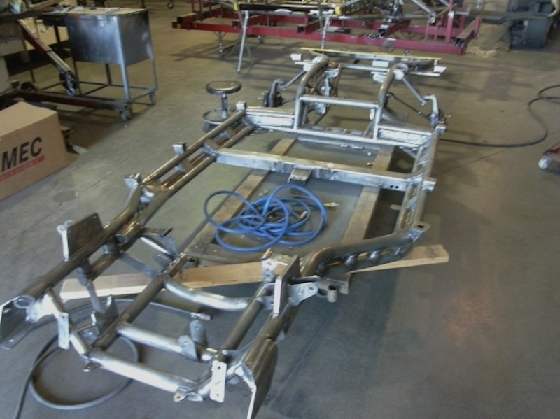

Default SRIII Motorsports custom frame
SRIII is building the custom frame.
Will powder coat frame black.

Old 07-10-2013, 08:43 PM
Nice looking frame.
  #55
Old 07-13-2013, 05:34 PM
Semel1's Avatar
Semel1 Semel1 is offline
Join Date: Jun 2013
Location: Saylorsburg PA
Posts: 102
Default Frame
Nice looking frame.
Thanks for the comment.
Mike Stockdale of SRIII Motorsports does an amazing job with custom frames.
I met with him in New Lenox IL to discuss what I was building and this is what he came up with. It will accept all c6 corvette suspension, coil overs on all four corners and I will be adding the corvette Z06 brakes and rotors.
That should be able to stop that LS9!!
We will add the currie rear and 3.55 gear and add ss700 transmission.

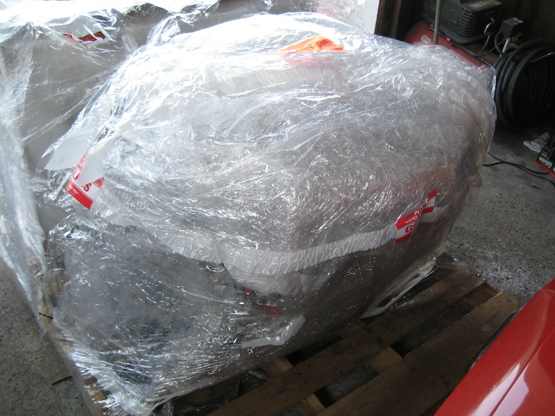

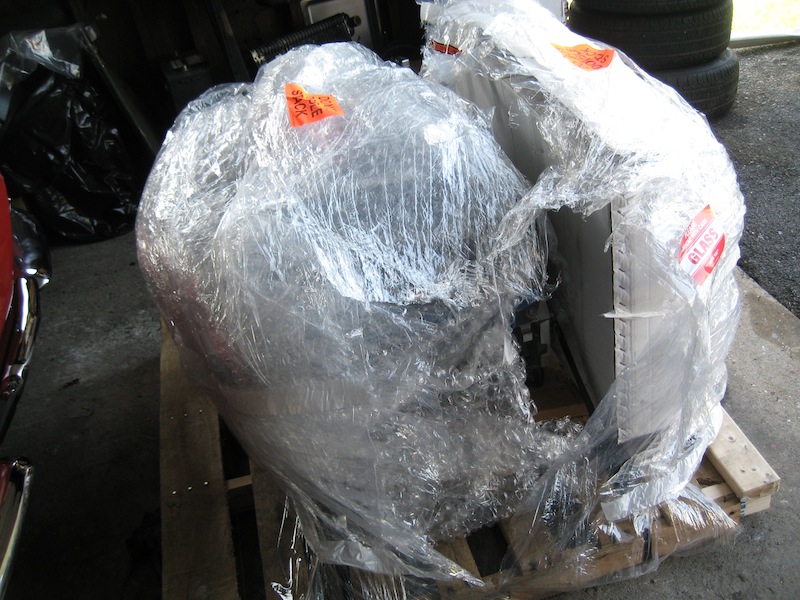

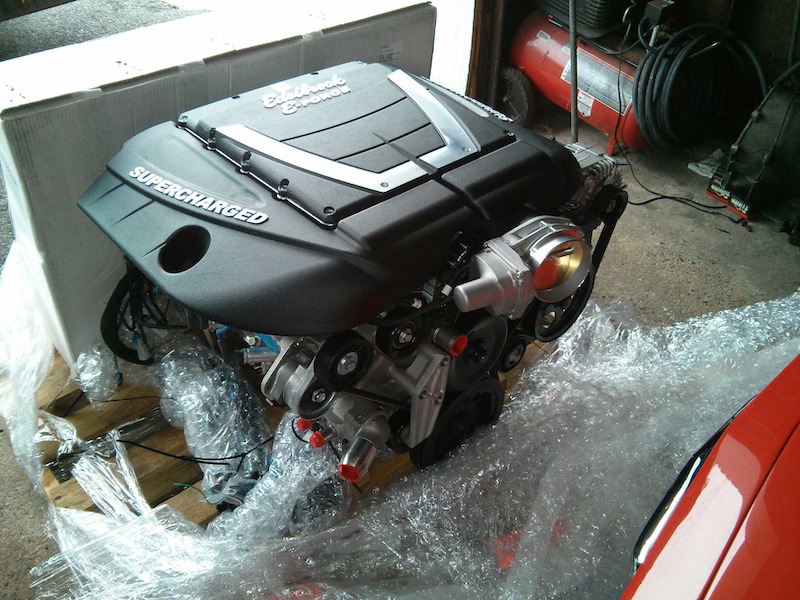

Default LS9 and Dewits LS conversion radiator and dual fans is here

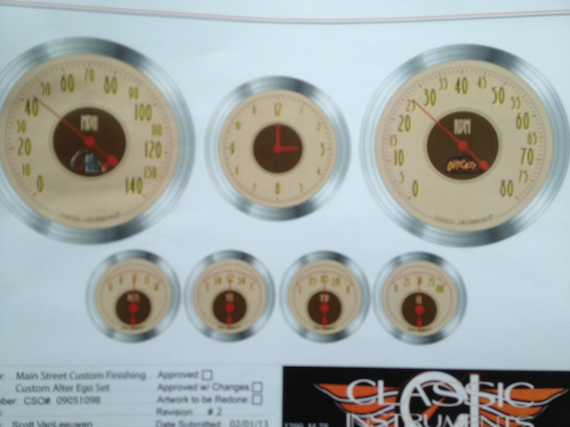

Default My custom designed gauges that Classic Instruments will complete
Will have the logos of ALTER EGO(center of speedo) and Outcast Precision Muscle Car(center of tach)

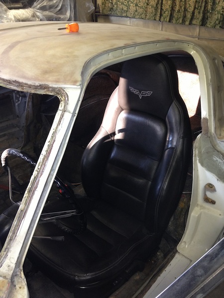

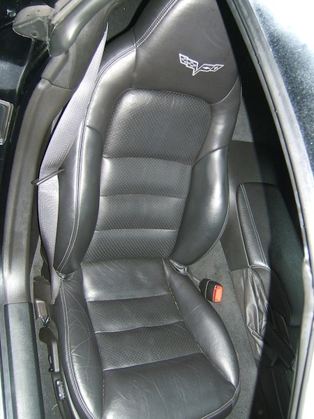

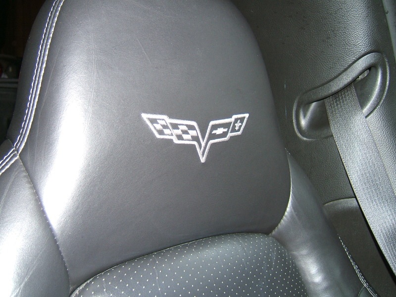

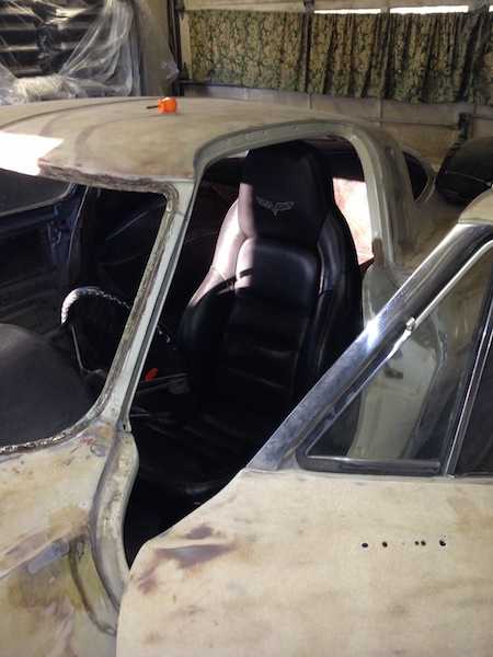

Default 2011 Grand Sport Corvette Seats

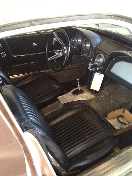

Original 63 seats
2011 Grand Sport Corvette Powers driver and passenger seat
Getting them mocked up

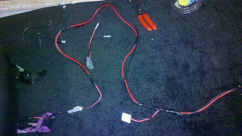

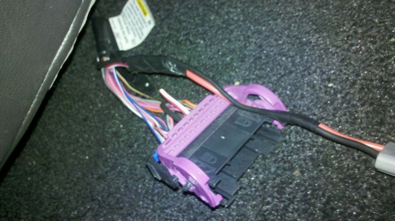

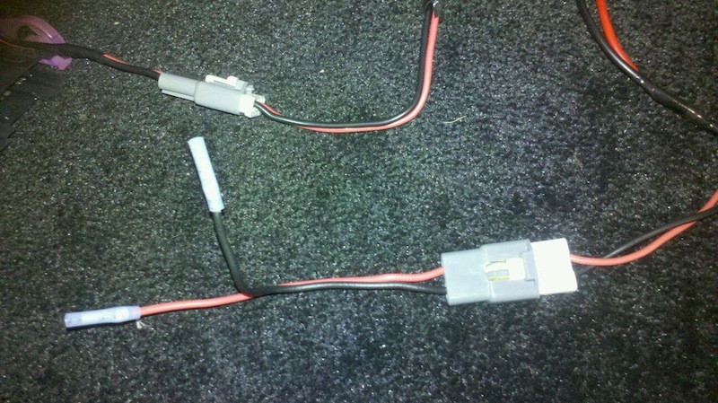

wire harness made to still be able to use powers seats/lumbar etc.
