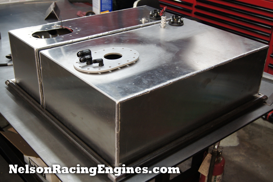

Heres the play by play on the twin tanks for the Octane on demand system we are incorporating in the car.One 91 octane cell and one 116 octane cell the computer will run on the 91 octane cell until the car reaches boost at 130 kpa I start to transition the second to come on injecting 50 percent race gas mixing with 50 percent 91 octane.So we will be able to run a much higher boost level in the 20 pound range but still run 91 octane for just cruising around town.

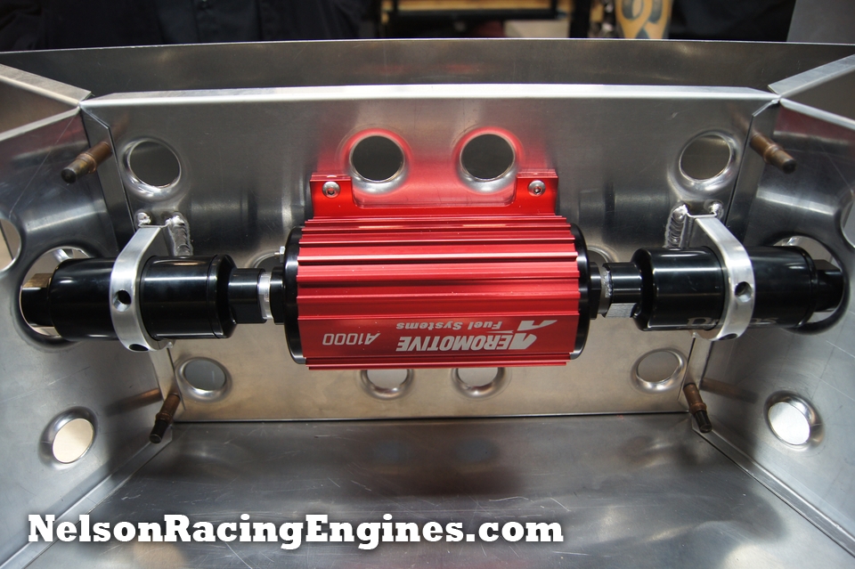

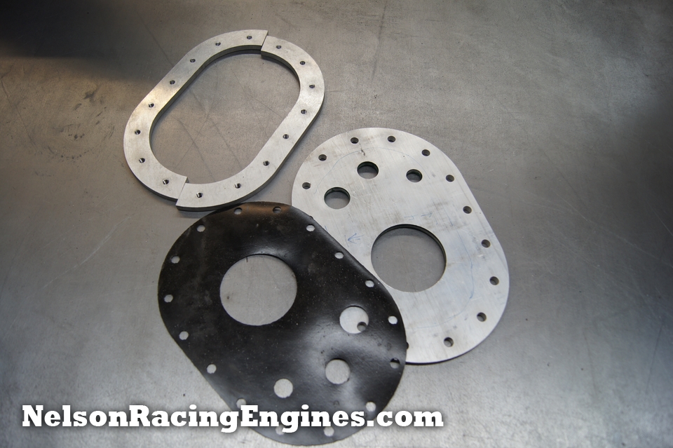

I thought this was neat to point out

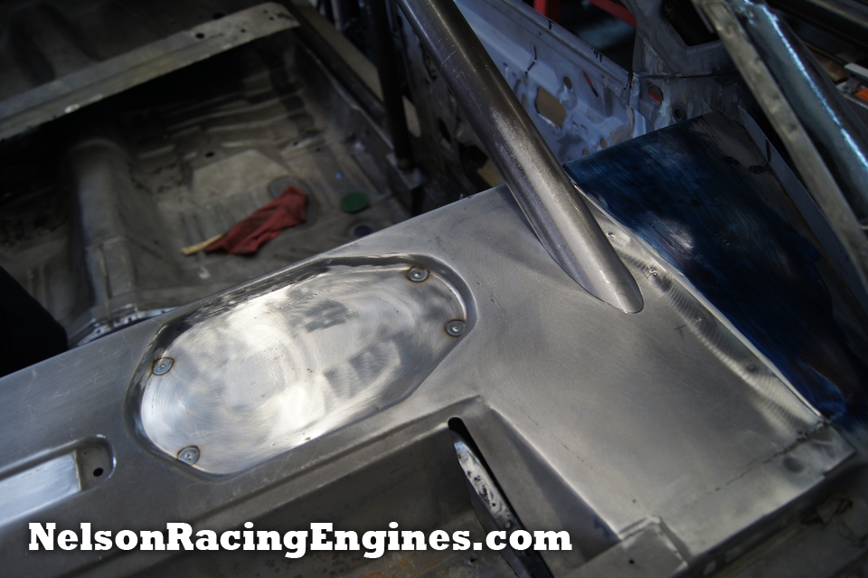

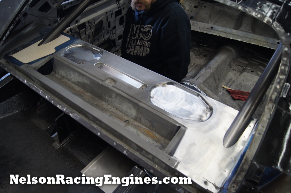

We bought this material from McMaster Carr and water jet both it and the aluminum For fuel lids so we could incorporate the feed and returns and roll over tank vent threw it and still have access into the tanks

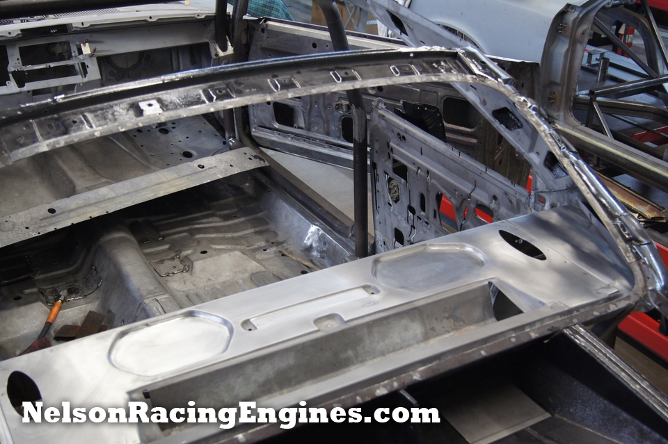

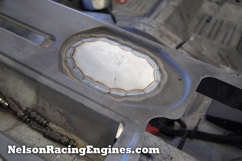

Default Maximus rear package tray

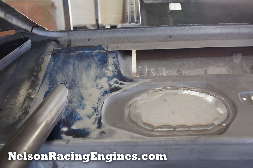

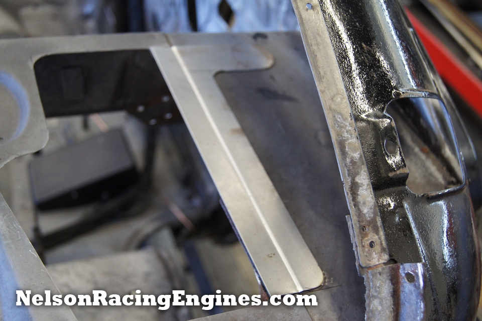

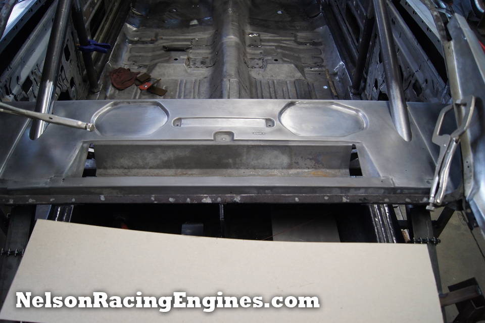

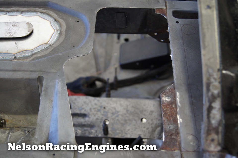

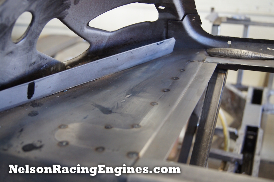

Well here is some shots of us putting the cage bars threw the package tray into the trunk.and filling in the speaker holes because to be legal to go 8.5 in the quarter you need a sealed firewall and just some of our insanity making everything fit tight and metal finishing it.

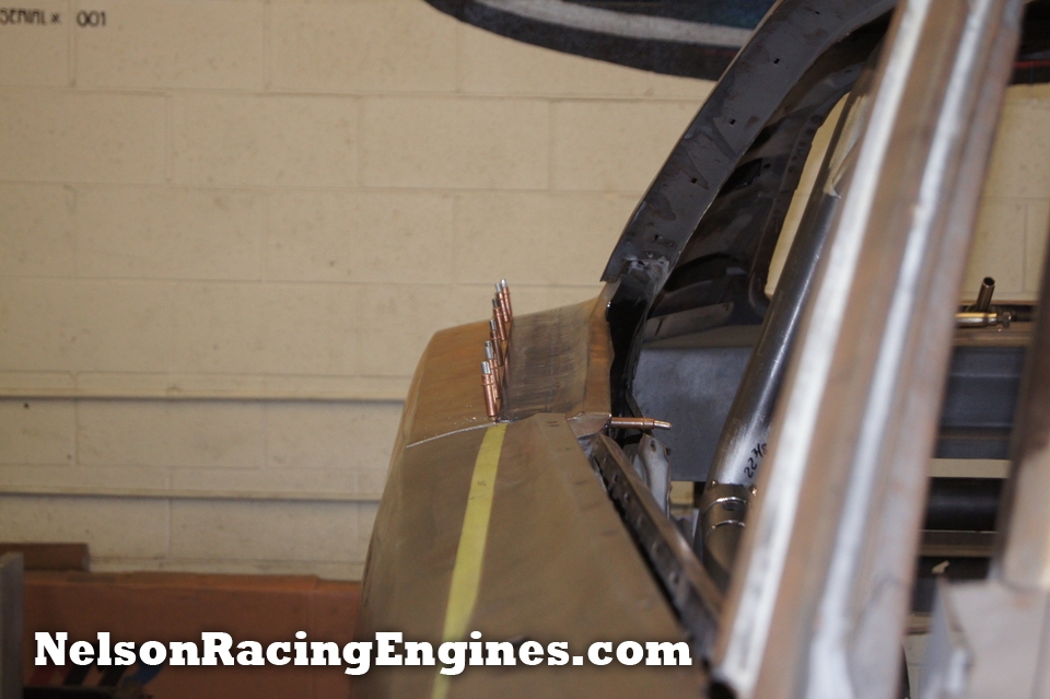

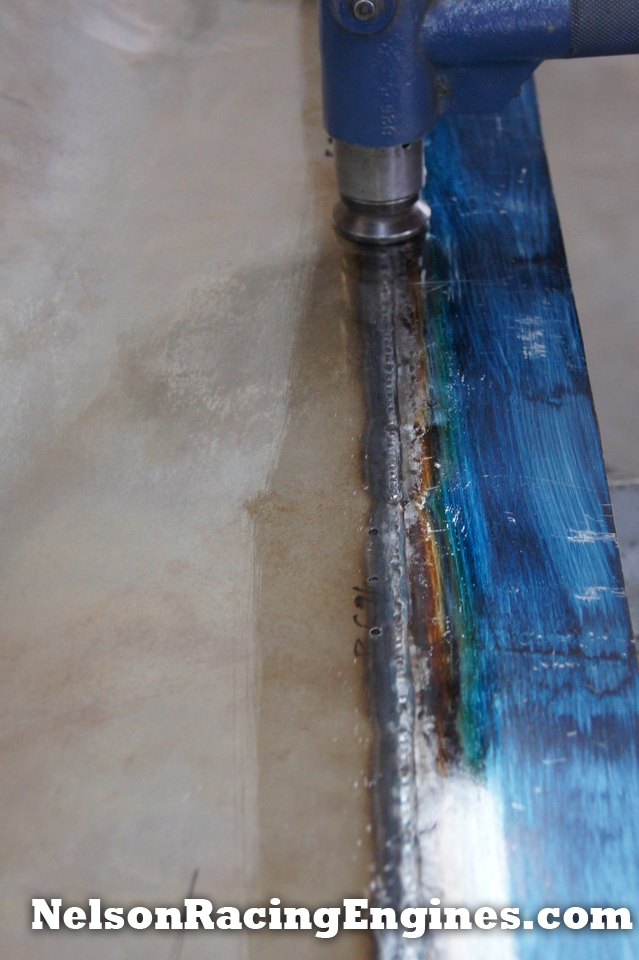

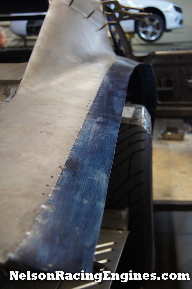

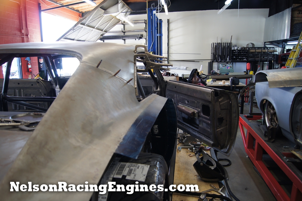

Default Starting the Wide body

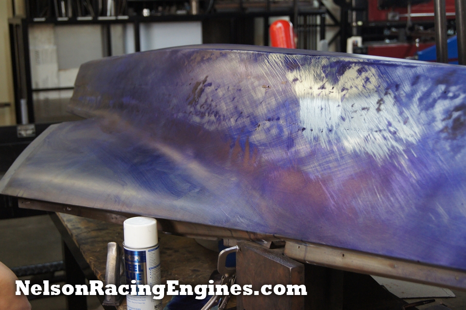

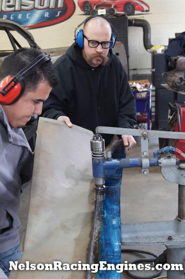

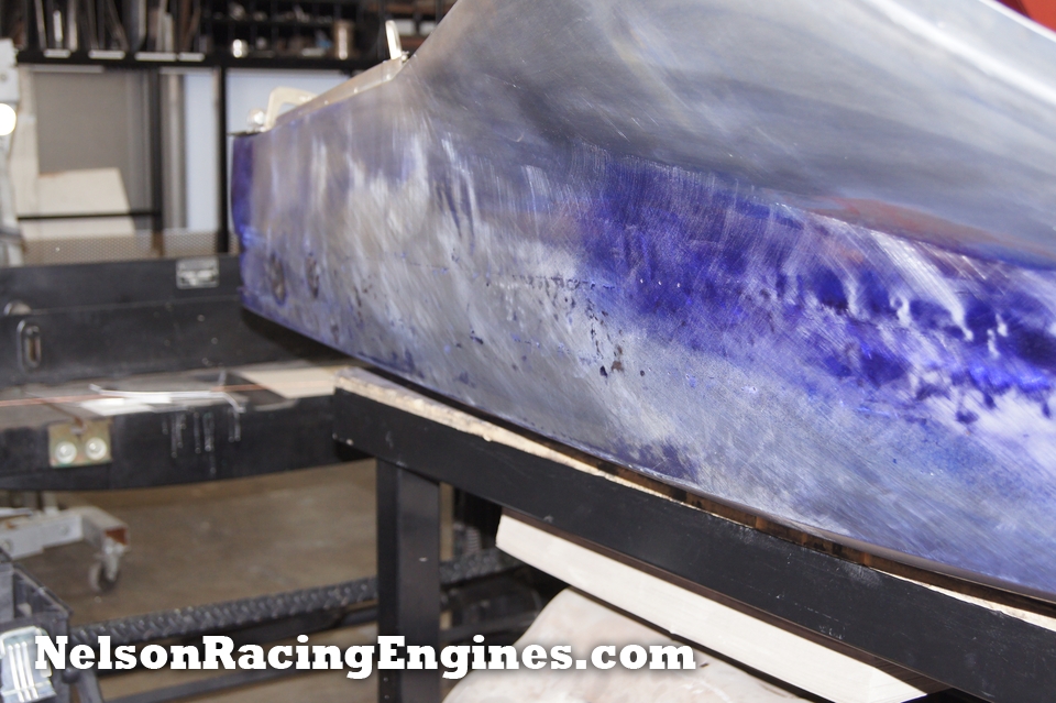

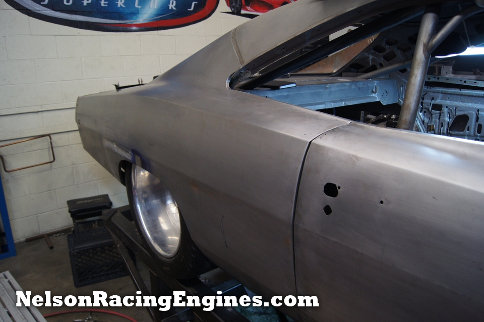

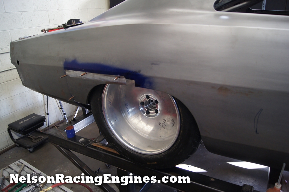

Heres a row of photos of how we started the wide body operation
  #58
Old 08-16-2013, 08:00 PM
Nelson Racing Nelson Racing is offline
Join Date: Jul 2013
Posts: 85
Default More Photos of the wide body coming togethor

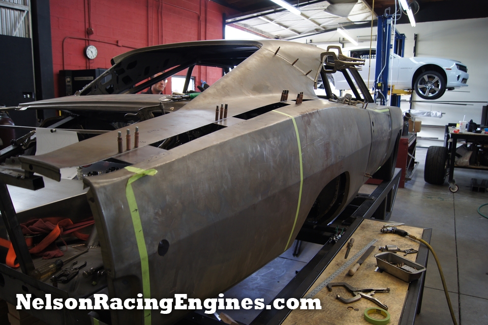

Heres some more really coming together nice
What an Immense amount of work .One of the bigger metal projects weve tackled.Very proud of my team at NelsonSupercars
