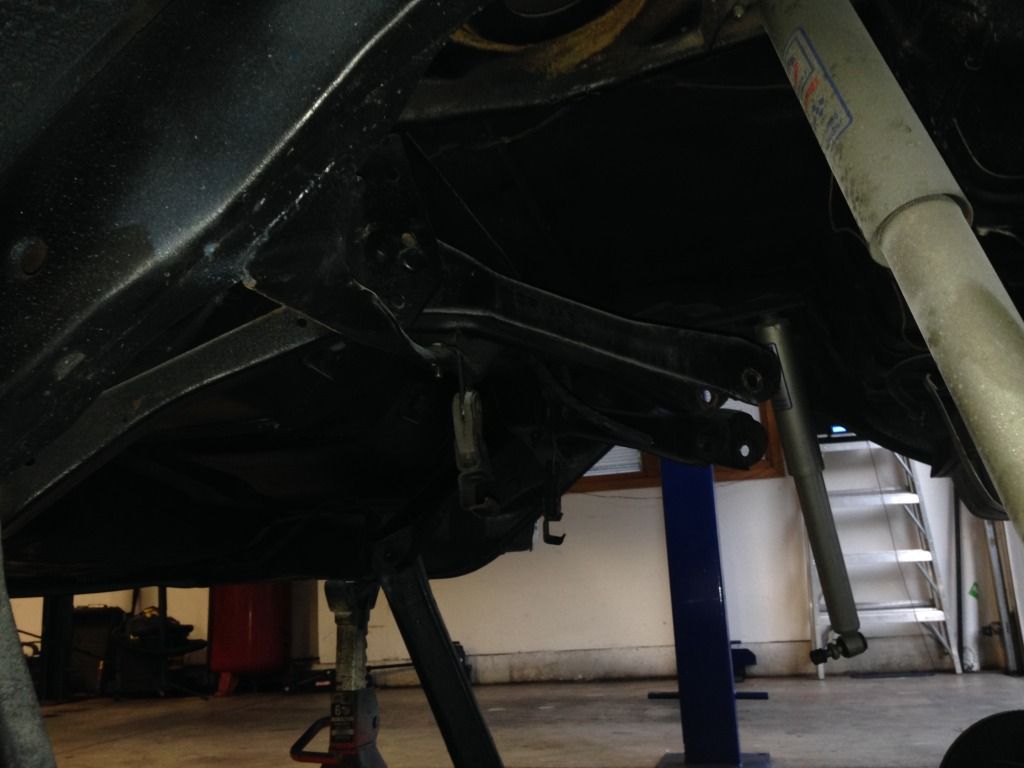

Lot's of balls up in the air.........waiting for the firewall insulation to show up........and the Rotors were picked up from the plater today.....so we got the front brakes installed......I also got a call from the transmission shop and the 4L70E trans will be delivered tomorrow............so after getting the brakes installed I decided to get the rear end out of the car and take it over to Jimmy Quinn at Chassis Service to get the posi unit installed and get the ring and pinion replaced if needed....seems to have a lot of backlash.......I should get all the Ridetech rear suspension parts in tomorrow and have the engine install going in a day or two........

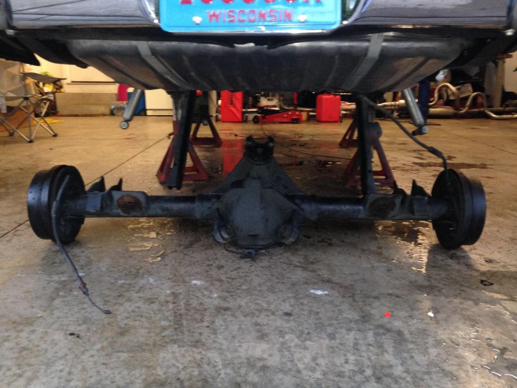

A couple things showed up today......Posi unit and rear axle assy was taken to Chassis Service for rebuilding.........also my Level 6 4L70E trans and converter showed up also.........ordered new brake lines also..........Gonna be a busy weekend
  #59
Old 10-03-2013, 08:42 PM
kwhizz's Avatar
kwhizz kwhizz is offline
Join Date: Nov 2005
Location: Kenosha , wi
Posts: 1,138
Thanks: 761
Thanked 440 Times in 165 Posts
Well......I guess I was Lucky that the car didn't have a posi unit in it when I bought it (if it did I probably wouldn't have taken it apart)
.......After getting a posi unit and dropping the rear end off at Chassis Service for installation........... .........I go over there today and I was shown what was going on in the assy...........In disassembly the shaft that has to be removed to get the axles out was marred and scored so bad it to be cut off with a cut off wheel to get it out......also the rear was filled with motor oil rather than heavy weight oil.......and both axles are shot in the bearing area..........so......New Ring and pinion, bearings , and axles are on their way........Darn$$$$$$$
But.....after getting home I got the rear coil-overs installed waiting to get the rear axle assy back next week........
Ken

Motor oil?
