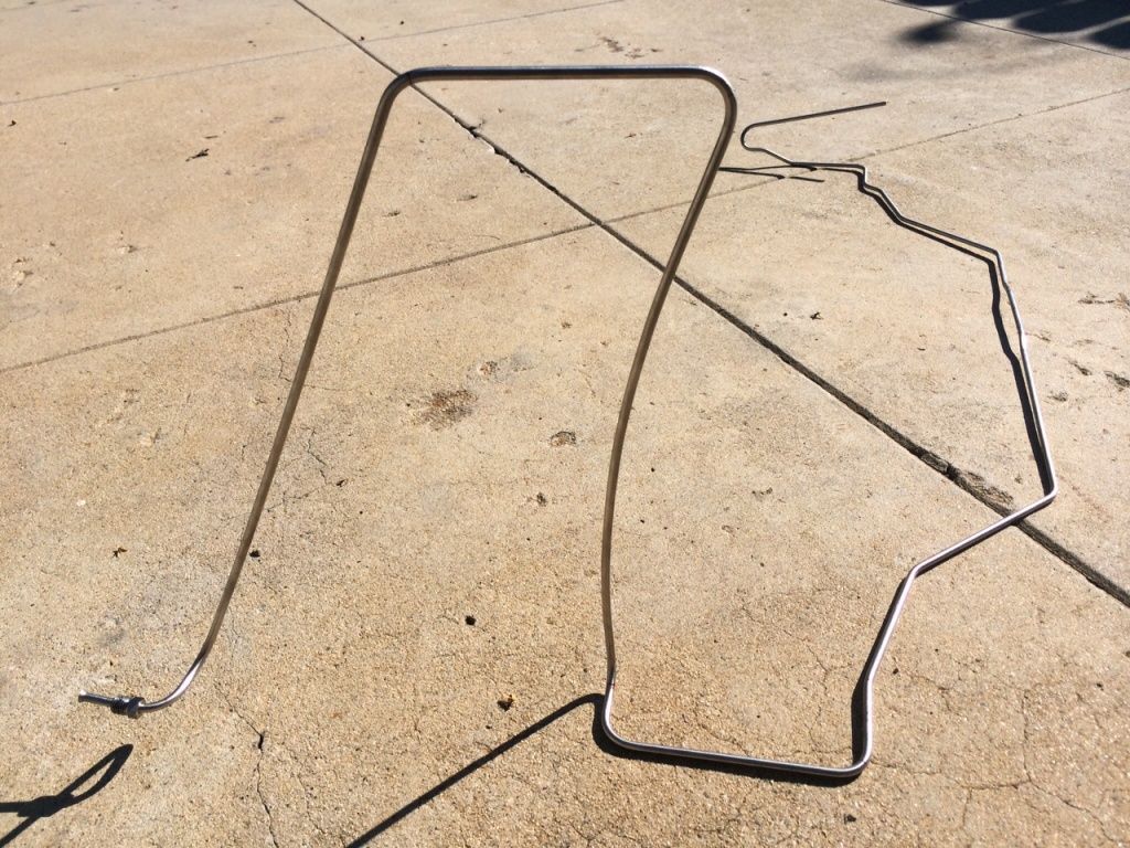

Yes, but tight space stuff comes out nicer if you mock it up first... especially when trying to connect two points in space (like an apron to a master cylinder) with multiple lines and make it all look nice.
Agree with both of you. In my case I used mock up because it saves a ton on Ss material and wanted lines to run through very specific points. For example on picture below. That line goes from MC to front passenger wheel , undisturbed ( one piece ) it follows weld line on sub cross member and very tigh on all places. With multiple bends , on multiple planes and odd degree bends ( 13s , 17s etc )
There is no way I could have done it any other way.
The see through protractor was indispensable for me also.

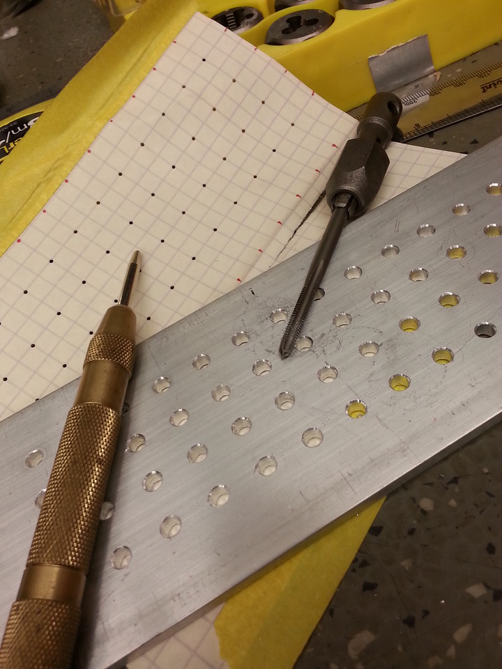

I need to make some carburetor jet plates yesterday for 1/4" 6061 aluminum, when laying out grids graph paper comes in handy, just center on the material and use a self-loading center punch.
I also made a fuel capture tube out of mild steel.

V blocks FTW!!
Nicely played.

Those jet plates are nice, gonna make room for ALL the jets and air bleeds?
Add magnets, so you can have it on the fridge!

Graph paper is a great idea Seig!
-Sean
