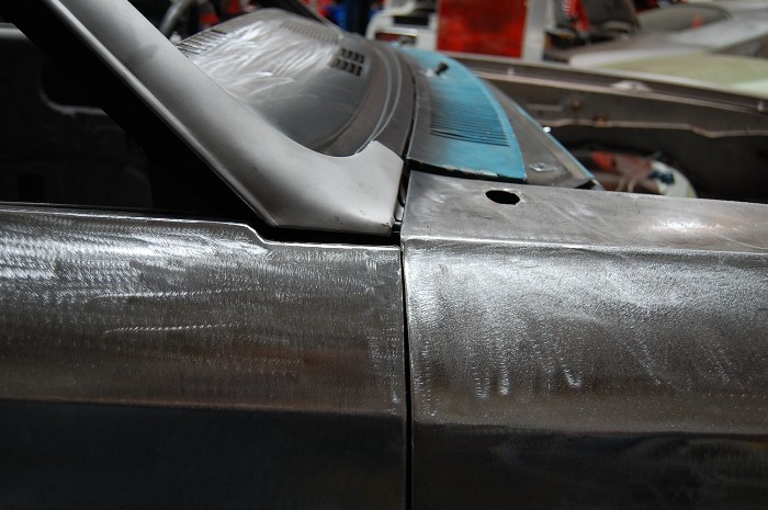

its been a long week and its only Wednesday. Have an issue with the passenger side door. It never fit right from the factory. Perfect gap to the rear jam, perfect gap at the rocker and perfect line up on top, nice and level but yet the front gap to the fender is at an angle. It has to be the skin, but I can finagle with some cutting, grinding, welding then more grinding.

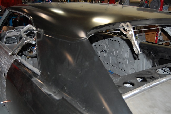

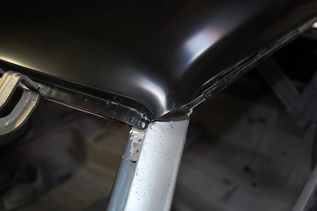

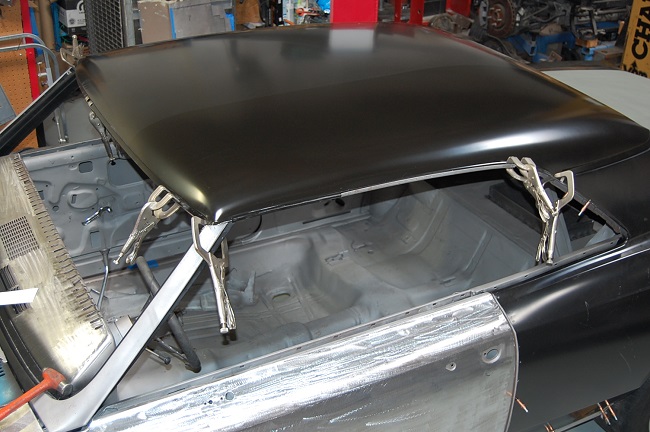

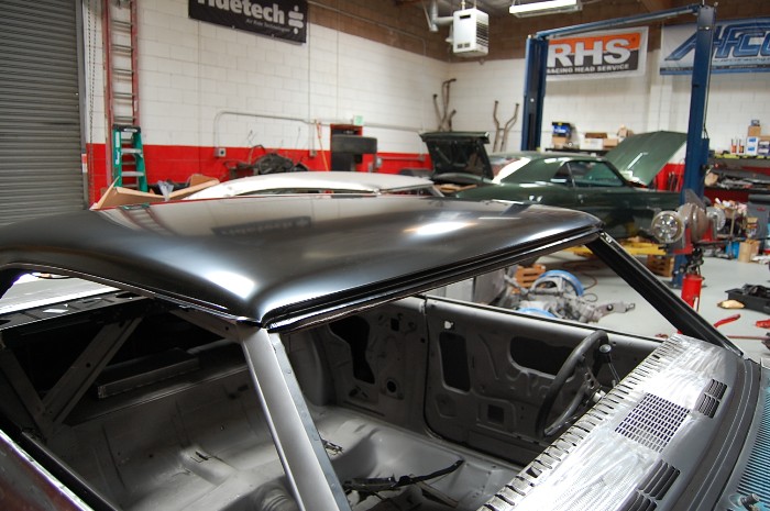

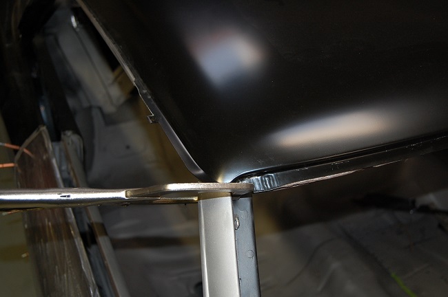

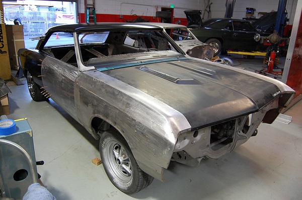

Spent most of the day getting the roof to sit nice. The joy's of aftermarket sheet metal.
The only tough spot is going to be the drivers corner. But should be ok since we will be shaving the drip rail and mould in the a-piller panels to the roof.

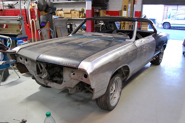

Since I had the roof on I thought i'd at least drop the hood on to, just to make it complete.
Don't get too excited...once the car gets checked for square I pop in about a hundred cleckos, a few under panels get tacked on, the whole thing comes apart and then welded in reverse.
