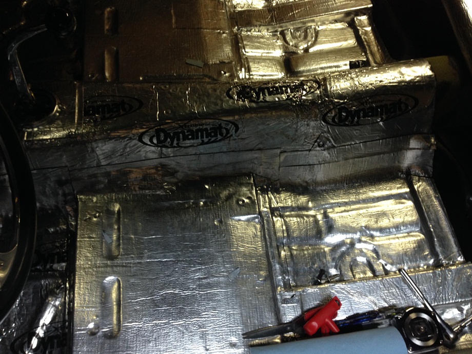

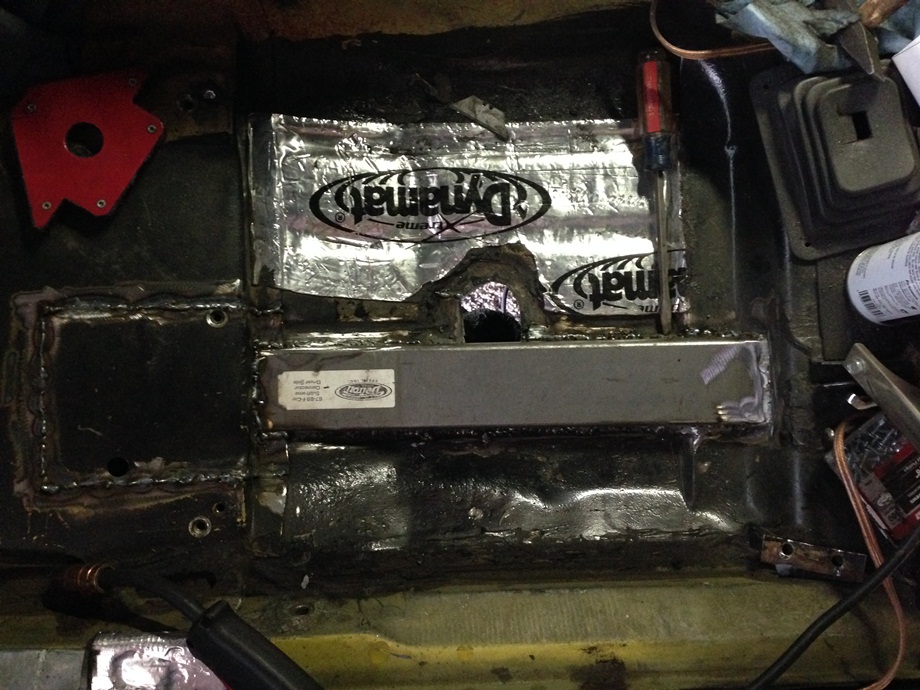

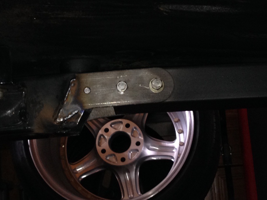

Thanks tubbed69 and Wayne.
I debated which sub frame connectors to use and decided that I would not use the bolt ins and cut the floors open and used the DSE connectors. burned them in, tied them in to the front sub by welding it on to the frame and bolting it to the connectors, cleaned up the welds and laid down some sound proof material.

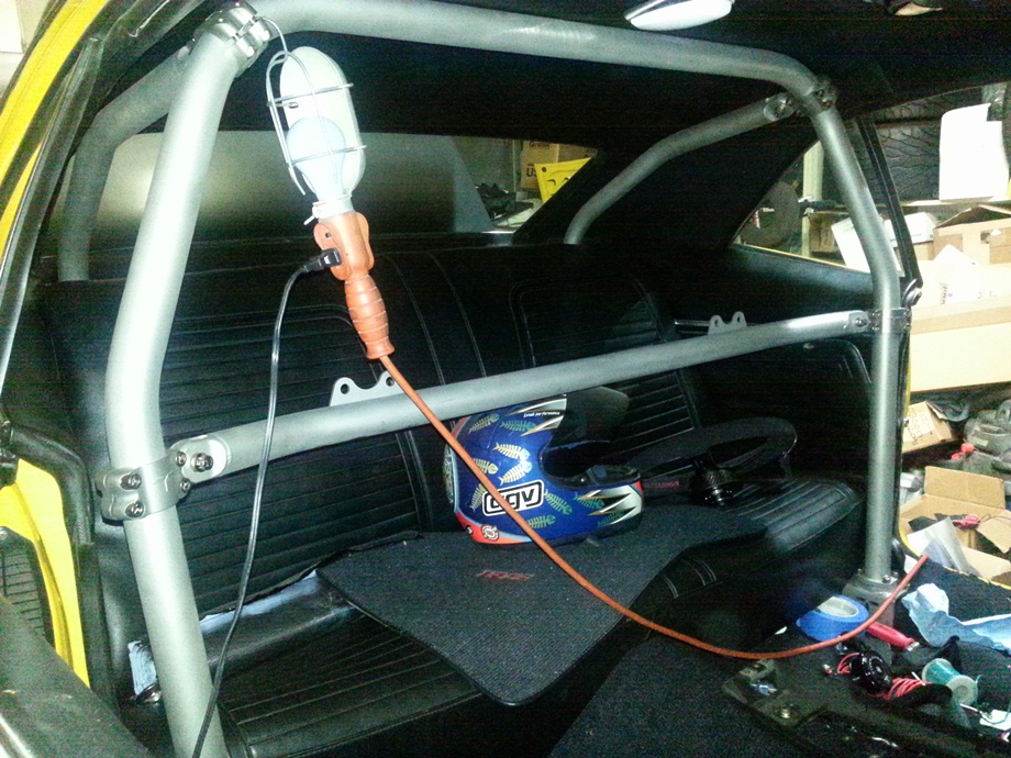

The little woman must have seen how much time I was putting into looking at roll bars and cages and she got me a gift.. a Tiger Cage
It is a nice looking piece. I really wanted to go welded but looking at this and the way it tied into the structure, it was like no other bolted cage I have seen. Besides I can always get one welded later if I step up my plans.

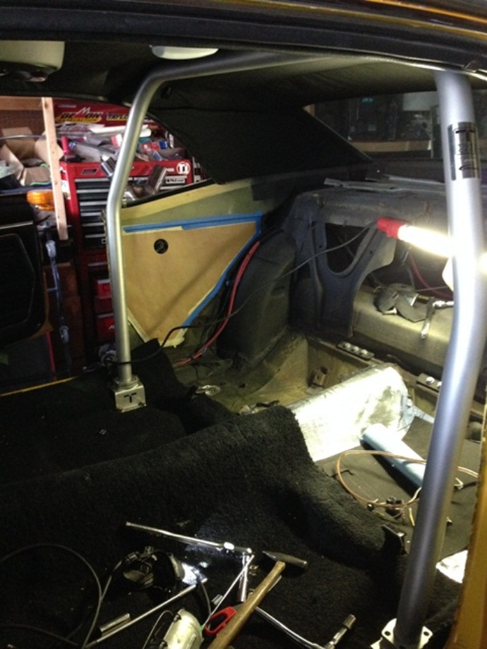

Posts: 253
Getting the Tiger Cage installed seemed straight forward but it has its challenges. I had some fitment issues that i have to work around. Overall with this tied in the the floor box sections and backed up with 1/4 inch pates under the car it feels really solid but it is one thing I hope never to put to the test.
