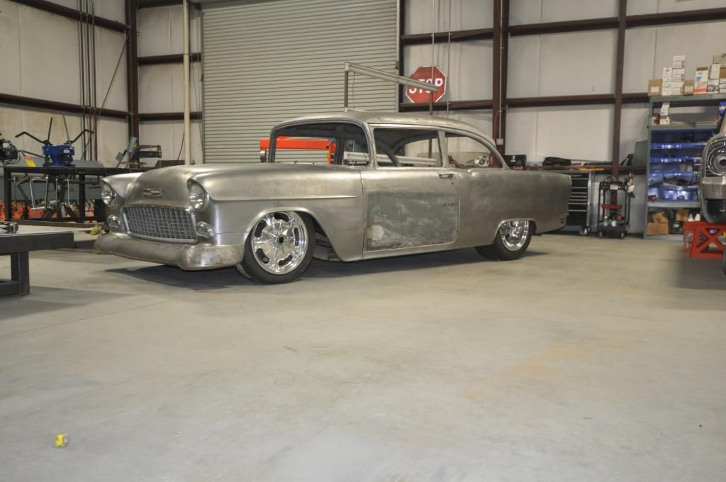

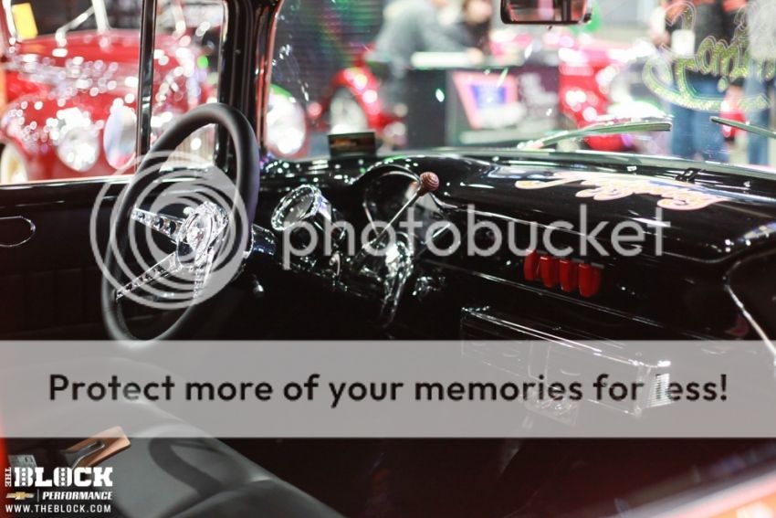

Sorry I'm just getting around to doing an update. Things have been pretty busy around here with SEMA and everything else.
This 55 is going to be one bad ass car. Everyday I get more and more excited about this project. The wheels and stance on this car are really cool.
We got the Dash moved back to clear the large engine set back.
We are getting the transmission and driveshaft tunnel set up.
Here is the direction we are going with the engine compartment. We are working with Vortech Superchargers on doing a complete custom blower housing to get the old school look even more. We are also working on the valve covers to get the perfect something that should have been done but never was vibe.

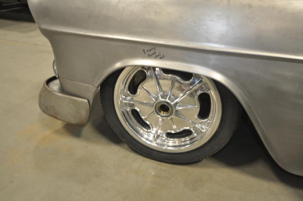

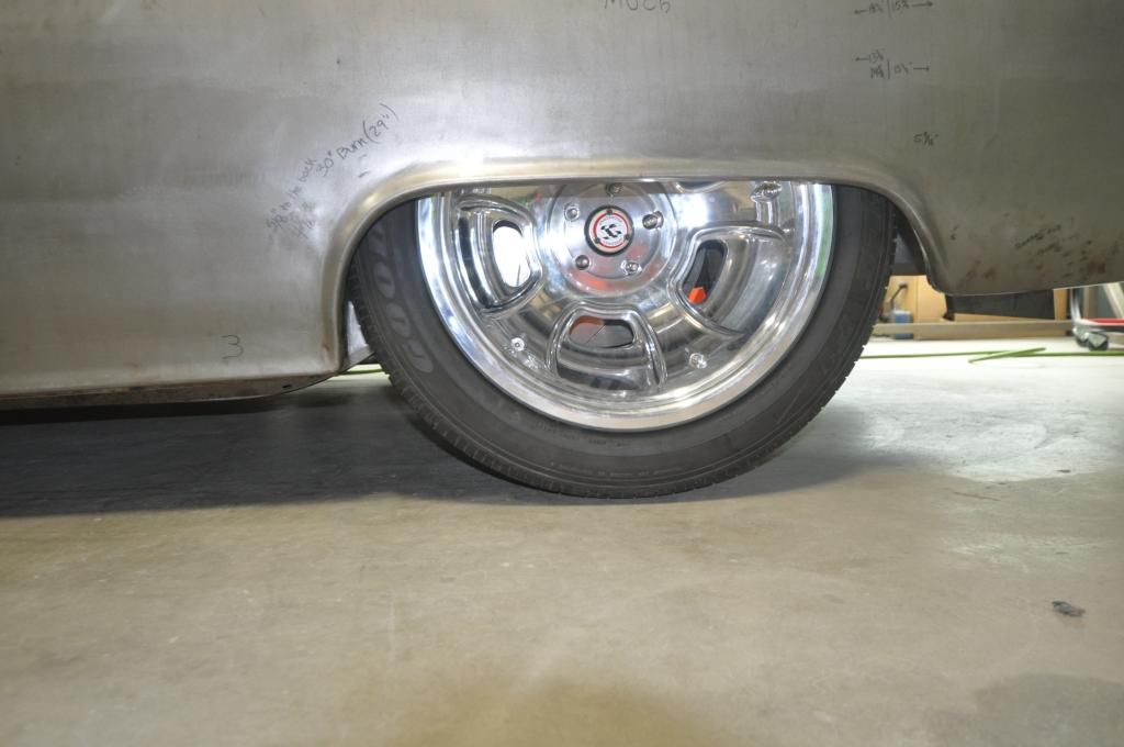

The wheels on this project were designed by Eric Black and myself. The front are supposed to look like 18" spindle mount wheels. The rear are build to look like the wheel that would have accompanied the Spindle mount wheels on a Gasser in a 19" wheel. The front half of the wheel hoops were machined from solid chucks and the rear hoop is from a 3 piece style wheel.
The Stance
Time to get to work fitting the doors and building the new door skins to align with the shape of the body and get the under hood stuff dialed. The plan is to display this car in bare metal with all the billet parts at GNRS in January.

I wanted that wheel concept in the larger diameters for my patina'd 64 Chevy truck but couldn't afford to do one-off's. I wanted 19's & 20's but an 18/19 combo looks just as nice. I love the rolling stock set-up & the underhood plans. I'm assuming you used the GT40 tire size 315/40-19 for the rears?

Yes sir. This car needed side profile in the rear tires. So we down sized the wheel size to keep the overall height the same but add more side wall. Looks awesome on this car.

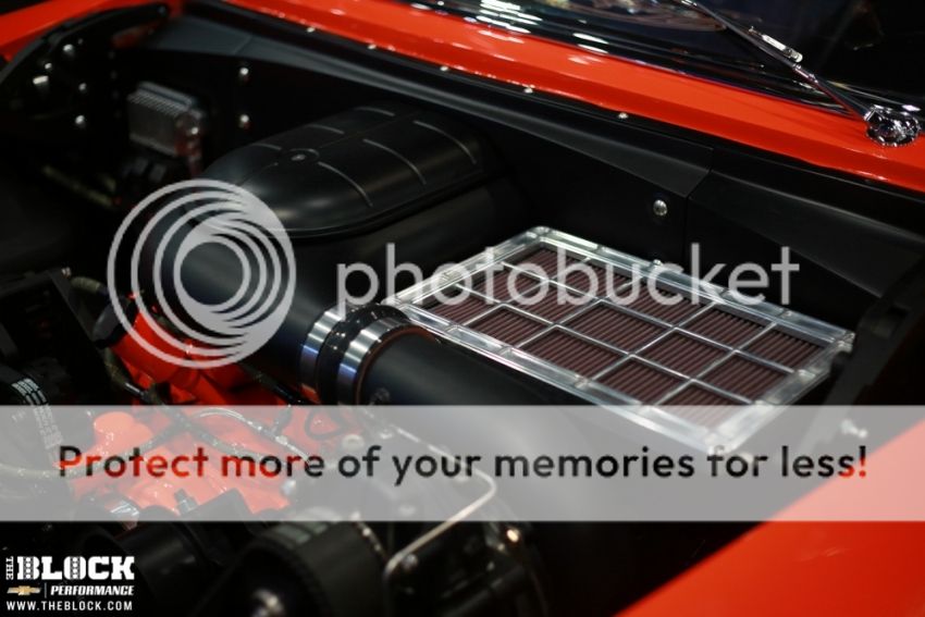

The engine air box & 'under dash" a/c set-up is freakin cool.
Very nice!
