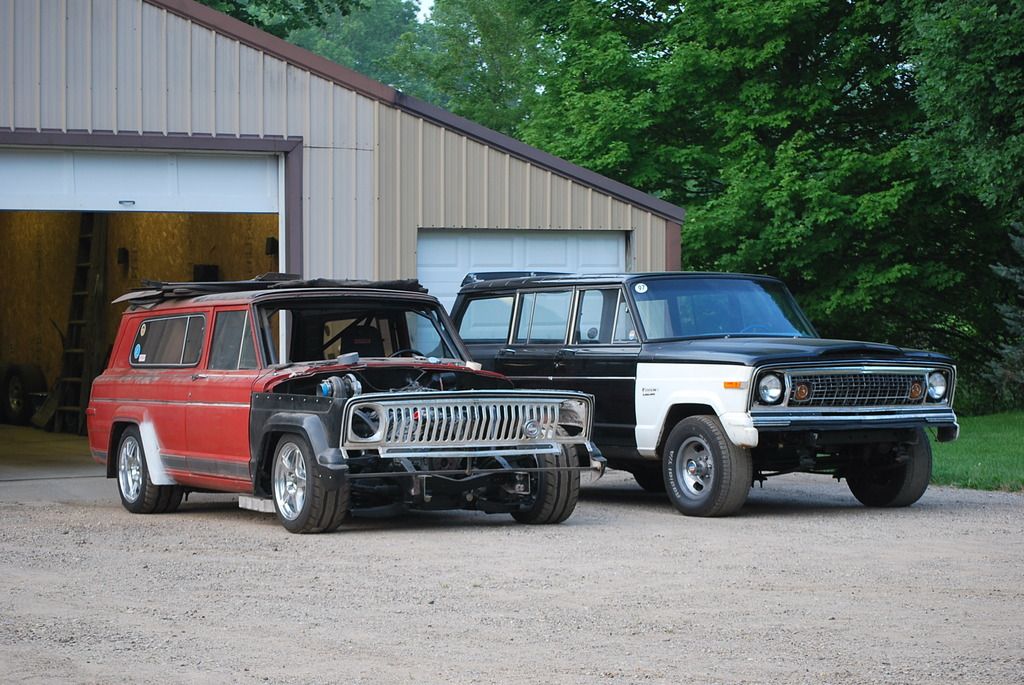

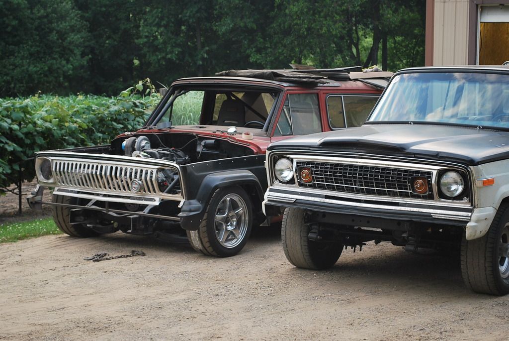

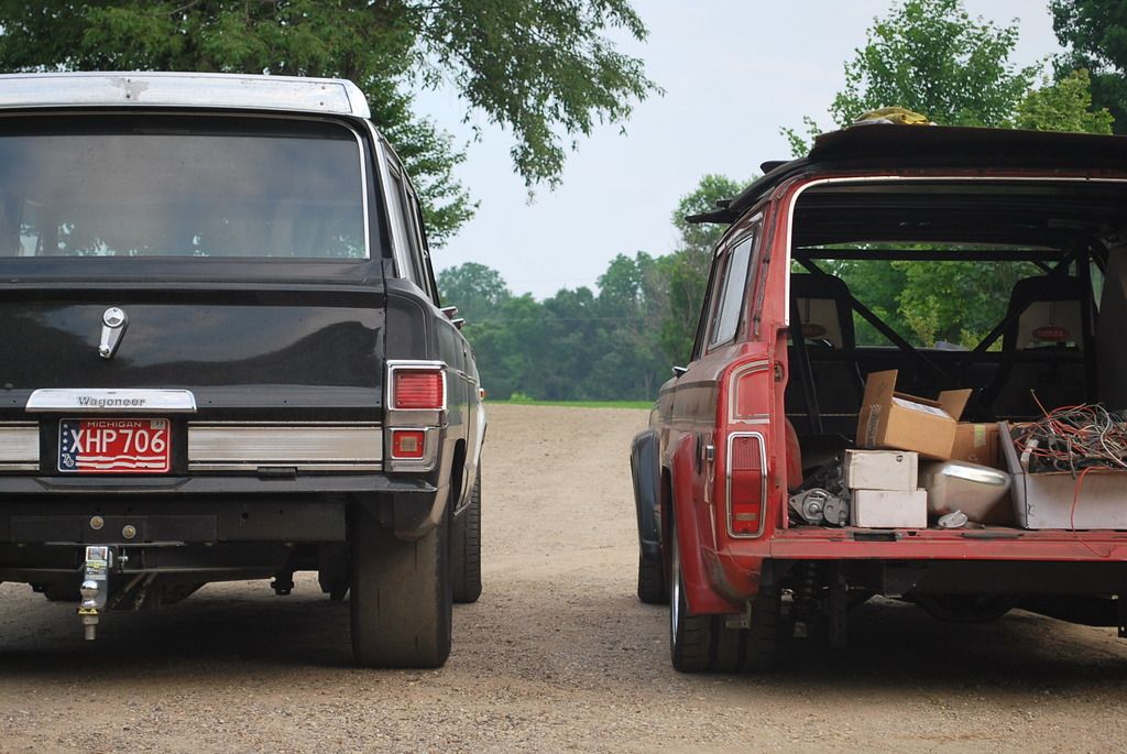

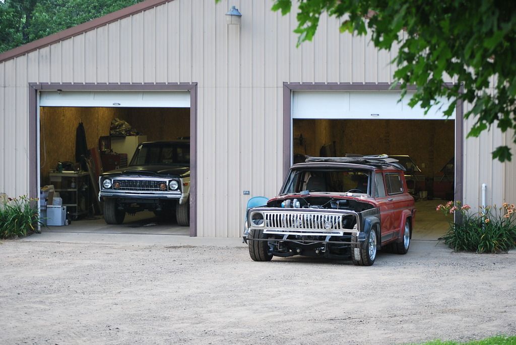

So, the other Jeep has been stealing all my time. Finally got it running and have been racing and driving it a bit for the past few weeks so now I get to start on the Cherokee again. Used the 700ish whp Jeep to drag the Cherokee outside for pictures and to move it over to the next stall. Kind of interesting to see how much different they are, considering they're basically the same body and used to sit at the same height.

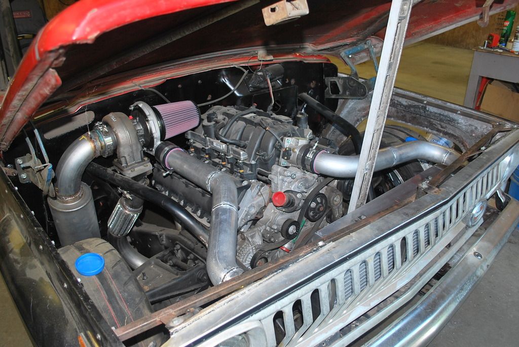

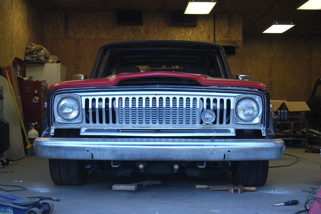

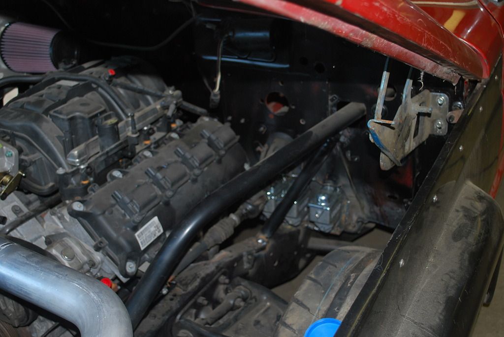

Downpipe and exhaust.
Got the floor mount pedals figured out. Had to cut out a lot of floor and firewall. Made it sandwich the new firewall between the pedals and masters. Makes it easier to work on. Sorry the pictures are kind of crummy.
Got the rear bumper mounted. It's aluminum and pretty light.
Front bumper mounted too. I built the mounts with sliding tubes so that it comes off quick and easy to access the front clip mounting bolts. The whole deal probably weighs under 10 pounds.

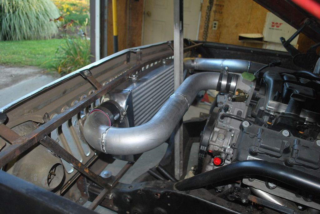

And the intercooler is mounted and piping done. Also had to modify the fuel rail mounting hardware to accept the taller Ford injectors.
