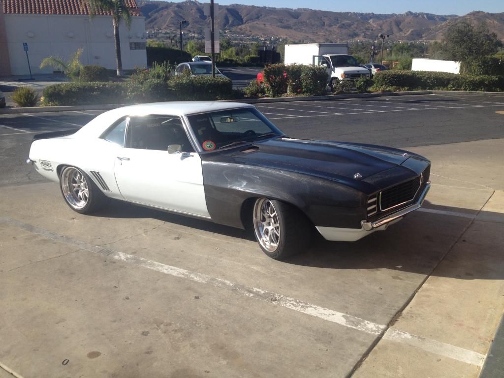

Making the decision even easier was the option of running Anvil fenders which would bolt on and not only drop weight but allow us to fit a 315mm Falken front tire setup. Anvil's headquarters is less than half hour from our house so my dad and I met up there after work one day and did our best to clean out their 69 Camaro inventory. The owner was cool to work with and we ended up getting a good deal on everything by picking up 'blem' items which was fine with us since we would be covering all the panels with wrap or paint anyways. In total we left with a Carbon cowl hood, carbon flared fenders, carbon valence, carbon cowl panel, carbon trunk, and carbon rear spoiler which completely filled my dads truck and my mustang.

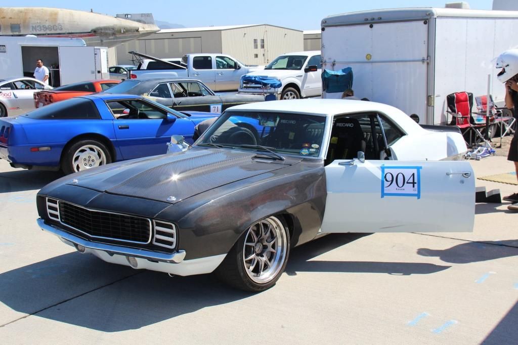

After talking with Matt A. about his experience with the Anvil stuff we decided to have the fenders fitted up and run them for awhile unfinished to allow any settling of the material that would cause changes in fitment. Best of Show in Escondido took care of fitting all the panels for the first time for us and did an excellent job. We then ran the car like this for a month or two which was fun since driving around southern California in a 69 camaro with a carbon clip definitely gets some funny looks.

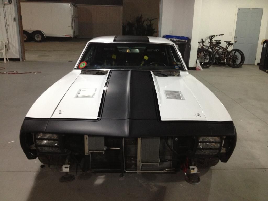

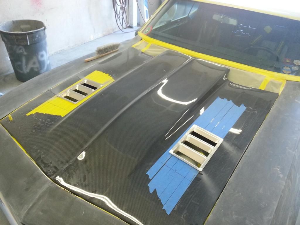

After testing was complete and with SEMA fast approaching we sent the car to JCG for bodywork and prep. As it always seems things were happening way too last minute and Cris and the crew only had 3 days to refit all the body panels and prep the body for its wrap appointment. Somehow they got the whole car straight and looking perfect and also found time to make hood vents that we requested out of aluminum and epoxy them in place.

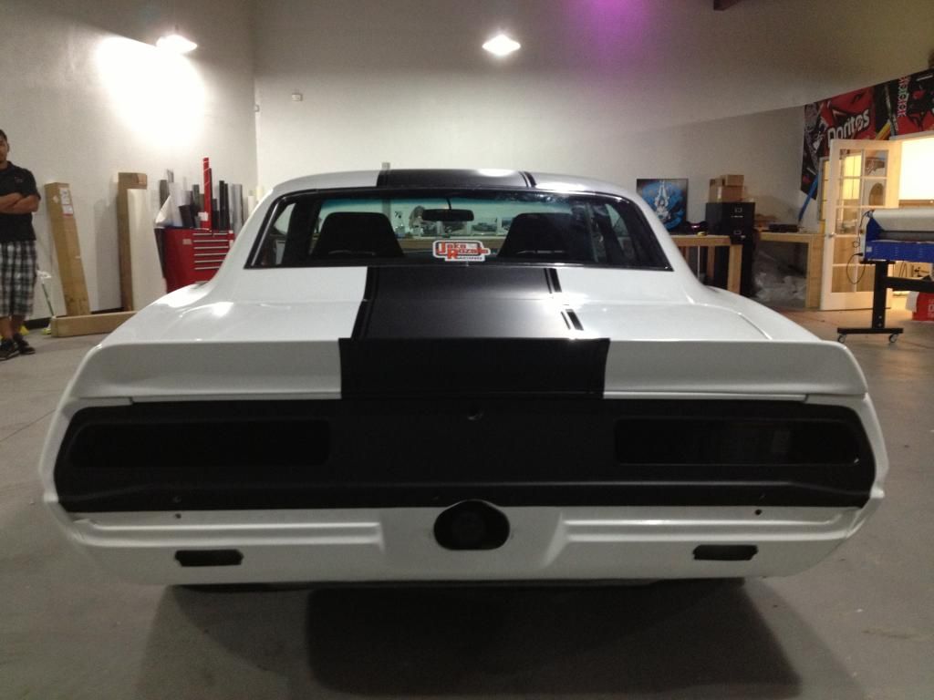

Here are the pics of the wrap process done by Troy Weeks, we collaborated on the phone and tried to create a design that was different and mean looking while also having the feel that it could have been an actual design option in 1969. I really like the Baldwin Motion cars in particular and you can see that influence as well. The colors are primarily white and matte black with gloss black accents. The whole wrap was completed in less than 48 hours and sent back to JCG for final assembly.

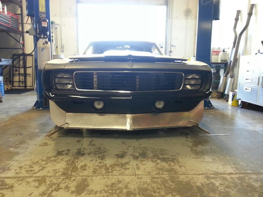

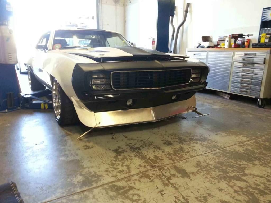

To help aero Primo at JCG quickly knocked out a new front spoiler out of aluminum which went down significantly more than the stock spoiler and went out wider to hopefully keep some of the air from lifting those big 315s up front. Since it is a streetcar it was still high enough for speed bumps and what not.

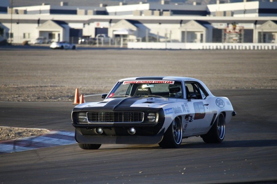

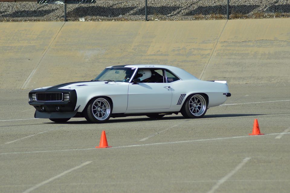

Completed shot:
Huge thanks to JCG, Troy and Best of Show for doing such a great job on the car and especially to Cris and the guys at JCG for knocking out an insane amount of work in a completely unreasonable time frame right before SEMA. Some day we'll bring them an easy job... maybe.
