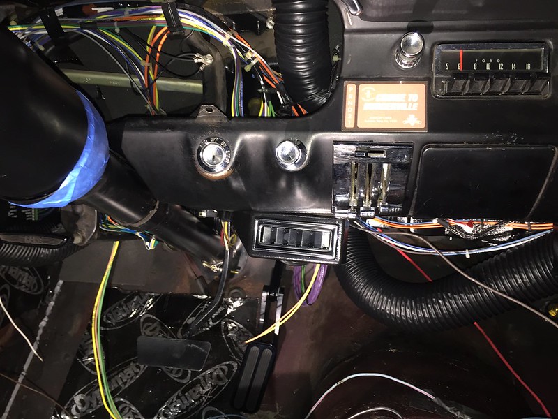

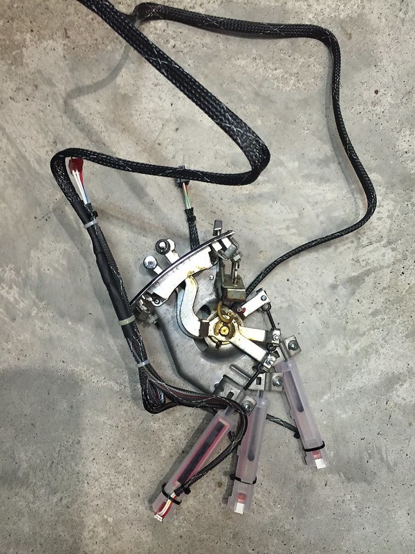

I'm really behind on updates for this Mustang.
Got the VA HVAC controls modded and installed in the car.

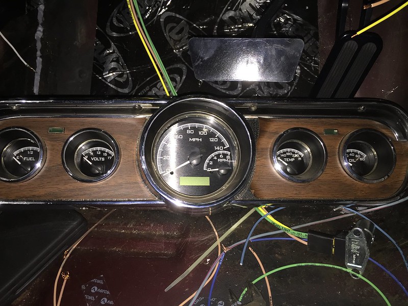

Also installed the Dakota Digital VHX guage

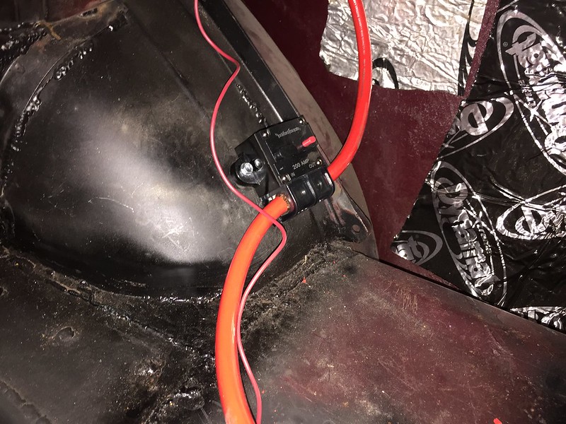

Installed the battery/200A resettable breaker on the main pos wire.

Need to check the wiring as the VHX gauge acted strangely when I powered up the electrical system. At least I did not blow any fuses.

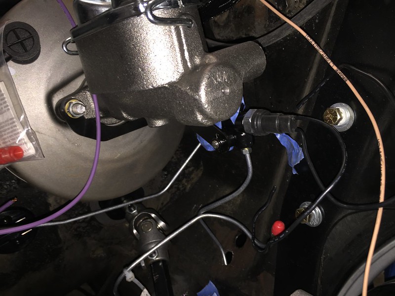

Got a 70 Mustang 1" m/c installed with Wilwood proportional valve/dist block and ran the front brake lines.

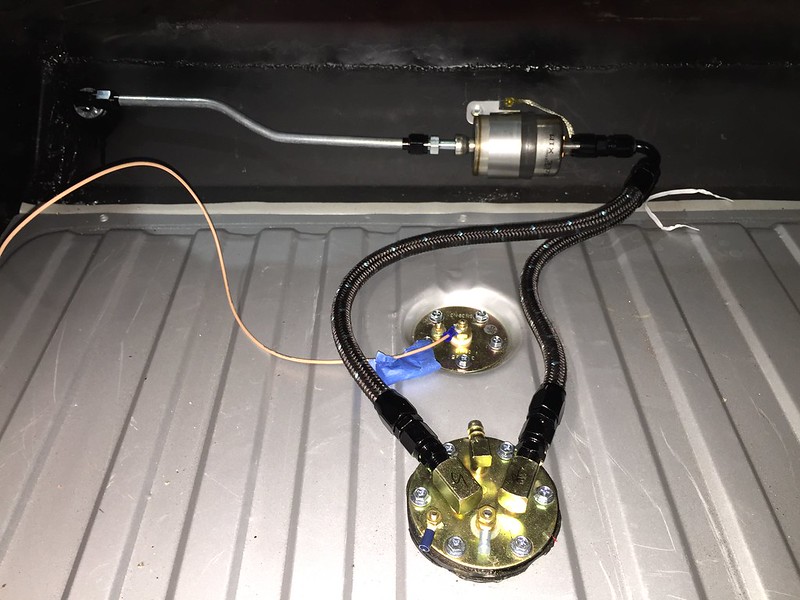

Aso finished up the fuel system/lines. Corvette filter/regulator, 3/8 hardlines and AN fittings with flex lines. Hardline runs the entire length of the car, with AN flex lines running from the trunk bulkhead to hard line, and from engine fuel rail to hard line.

Do you have a part number for that fuel pump? It looks like I could use that style in my Torino tank.

I think it's Walbro 255. It came as a complete fuel tank/pump/sender package from Tanks Inc.

Sorted out the issue with the VHX gauges. It would randomly turn on by itself whenever it's connected to the control box with the key off, and would not turn on with the ignition on. Plugged the display to the control box in my Firebird and it worked fine. Turned out that I was using the power on/acc on terminals on the control box to power the GPS speedo module, and the gauges did not like that. Moved the power leads for the GPS module off the control box, and voila, problem solved.
Display powered up, all functions operated correctly.
