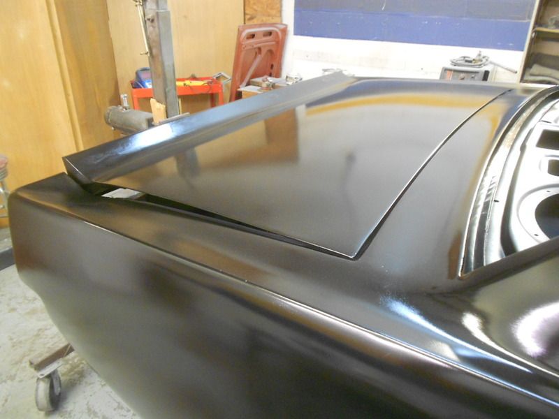

Ready for epoxy primer
Two coats of SPI black epoxy primer

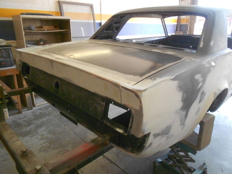

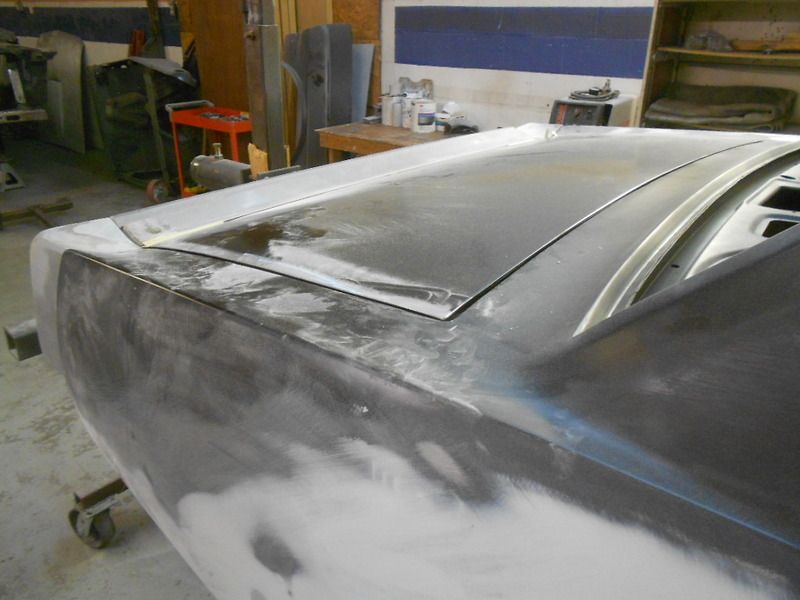

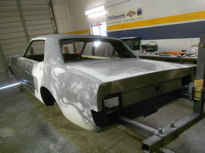

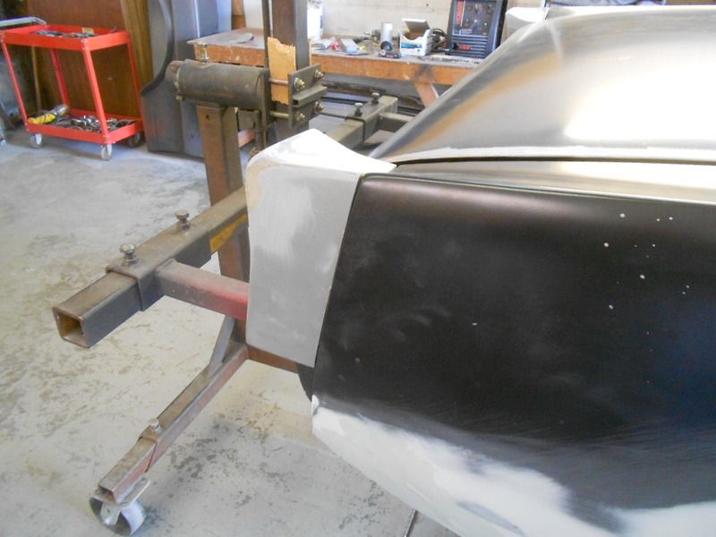

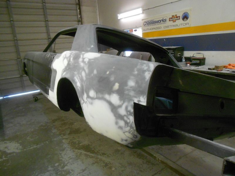

Brian is tack welding the last piece

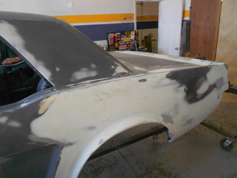

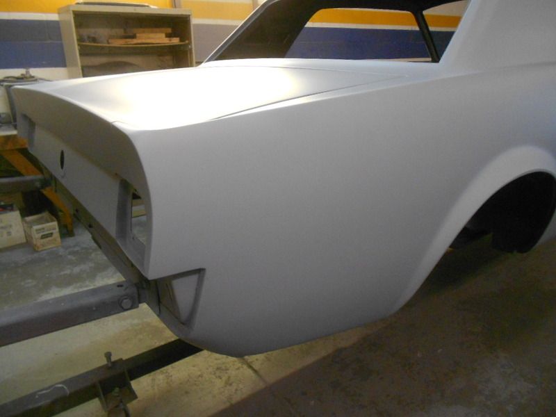

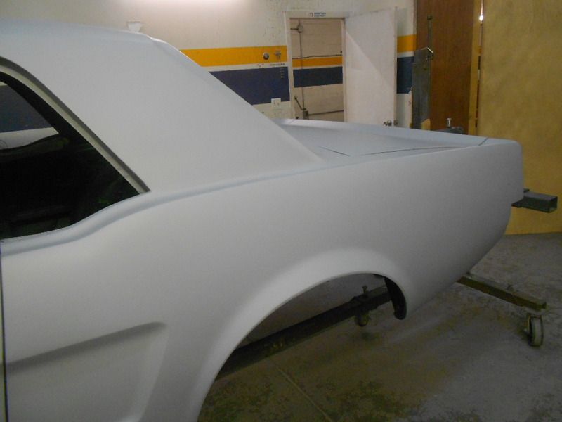

Brian finished the outside of the right quarter panel flare.
