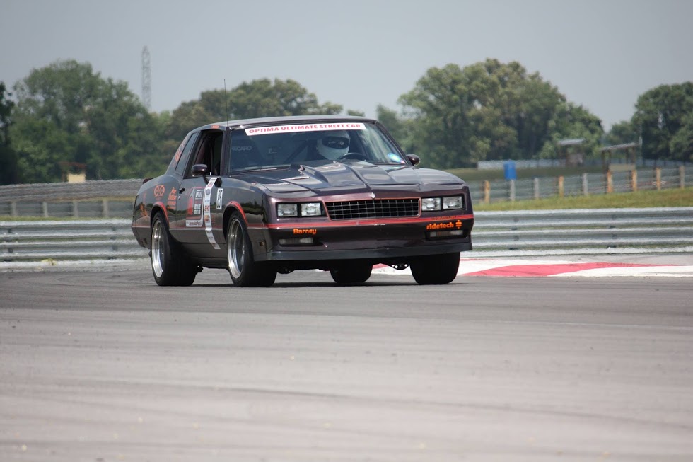

3550# fat car with 40 year old suspension technology underneath it...except for a modern soft spring big bar setup.
Car runs a 600# spring up front with a 1.5" diameter 0.375" wall front sway bar.
List of cars it beat in last Sunday's autocross in Raw time:

Same car finished 16th out of 64 of the best of the best CAM cars and drivers at CAM East a few weeks ago, with less tire, less brake and less horsepower than a lot of the cars behind it.
This particular car would not finish like it has shown it can many times over...without a finely tuned SSBB setup.
Other cars and setups may be different but to say autocross is a one trick pony that only a stiff spring car can run well at is just incorrect.
