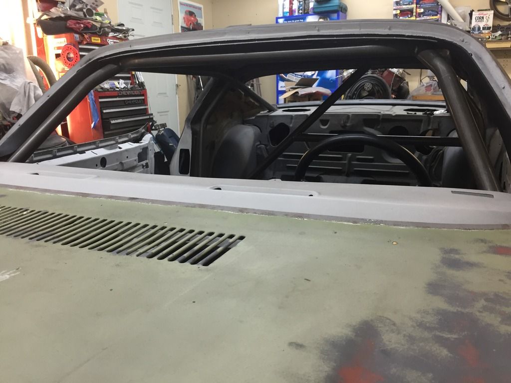

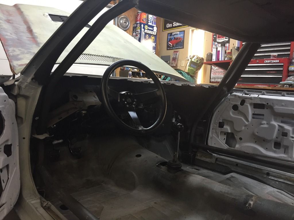

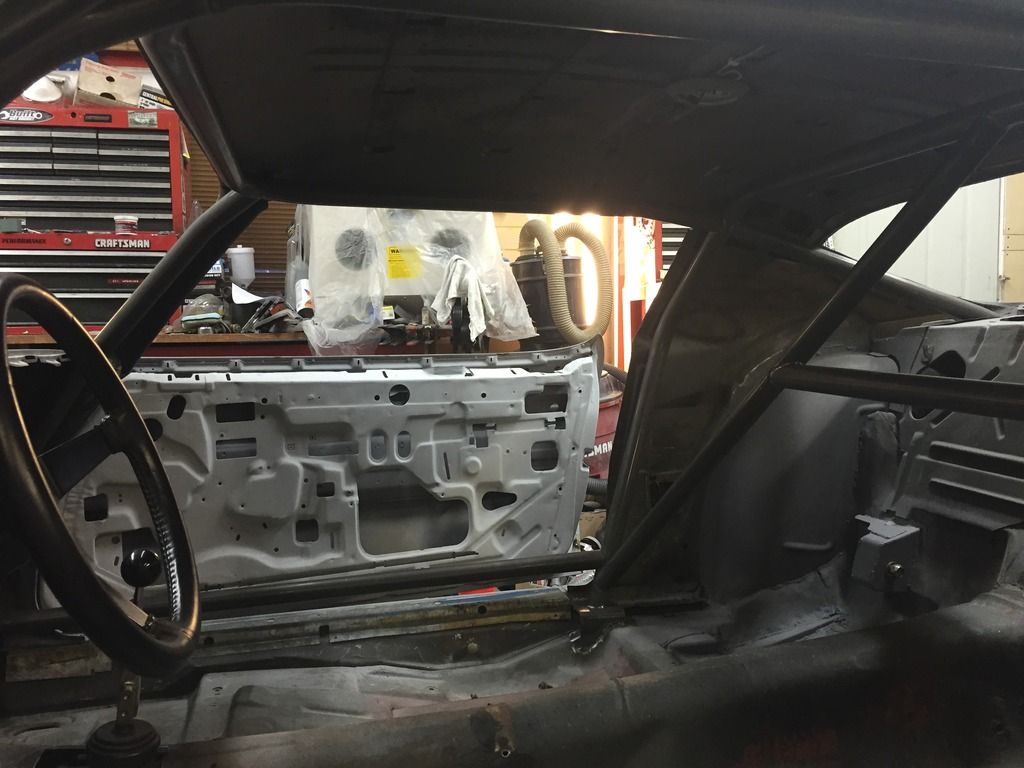

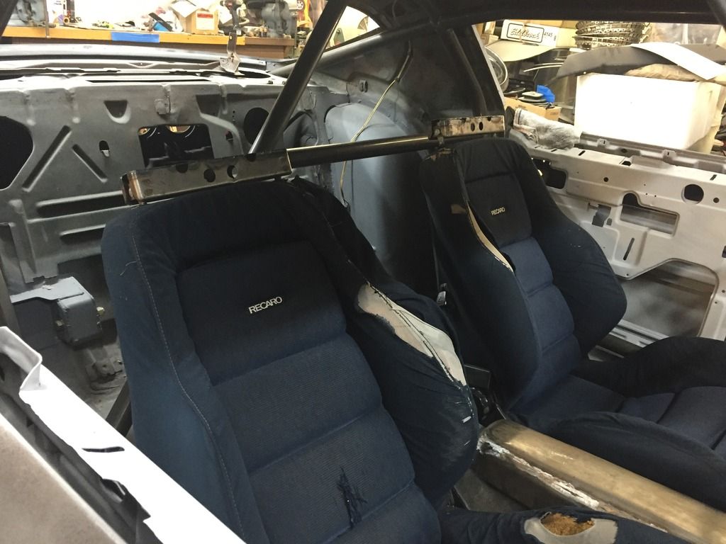

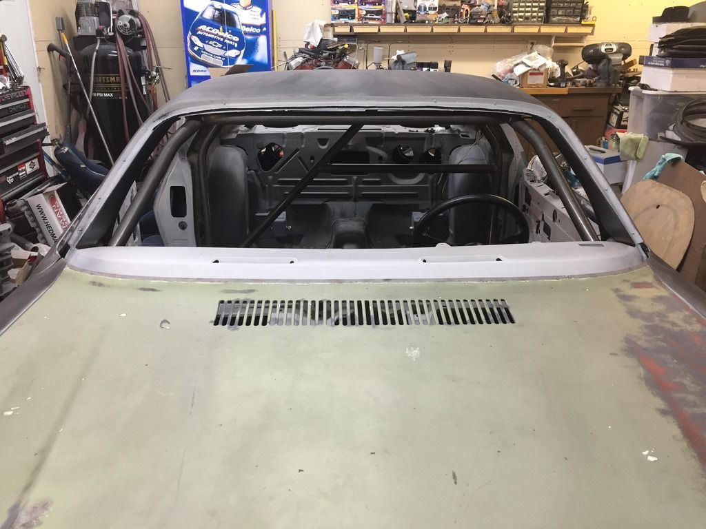

Here are some pictures of it bare and with sheet metal going back on I already had cut for the mini tubs at this point once it got home I finished them up and its time for the Quadralink and mocking up the front suspension and motor and transmission.

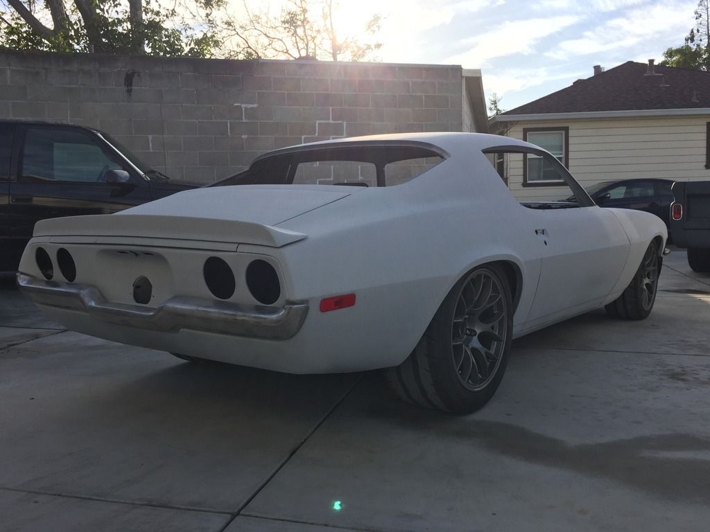

Interesting build.. what size tires?
It has a 245 40 18 on a 9 and a 295 40 18 on an 11
