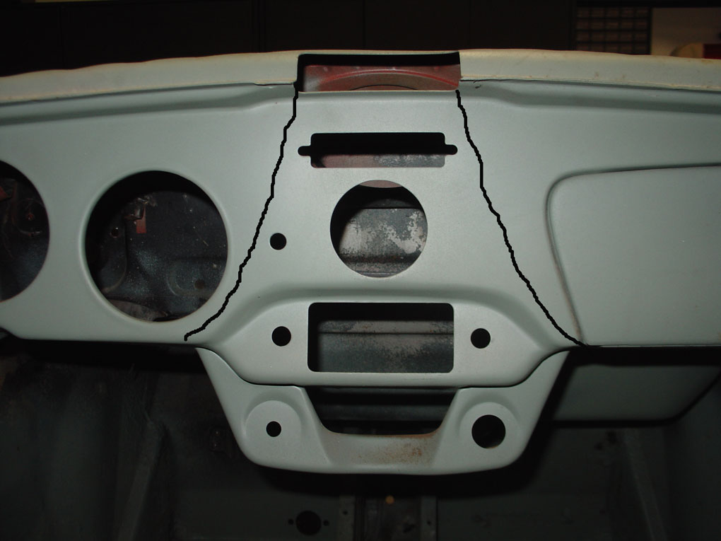

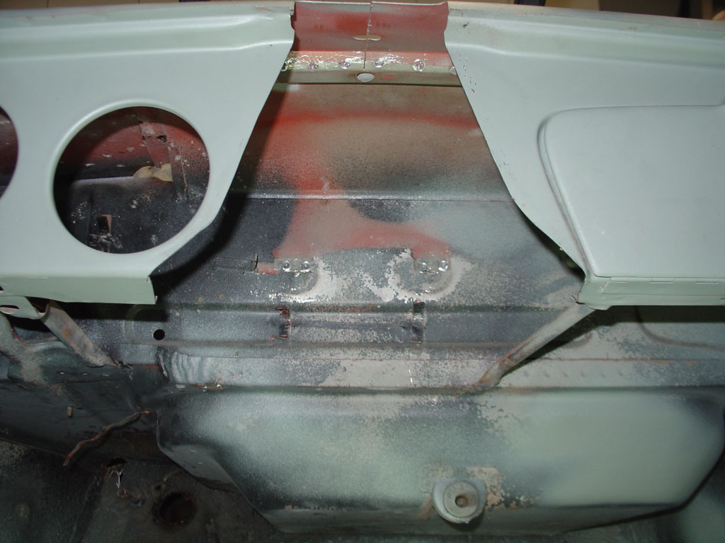

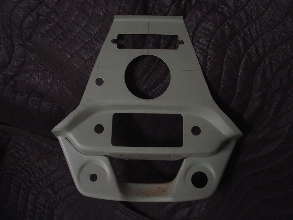

Default Dash Cut

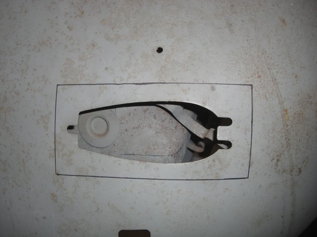

Need to cut the middle of the dash out. The original radio openings in these cars were very small. Plan is to v cut out the dash - then widen the cutout 2 or 3 inches to make room for a current sized radio (CD/DVD/LCD/IPod/Shower Massage ... ) and fill up the rest of the space between the gauge and glove box (widening the car 9-10 inches).

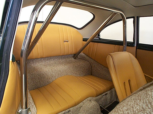

Thought about doing an electric flip down front on the radio and use the standard Porsche radio blanking plate, so when the thing is off - it fits the period of the car. Plan for the interior are to keep it looking stock as possible and use the high-end carpets and leather.
Thought about doing 2 interiors - 1 plush touring with the stock seats, the other with the Porsche GT interrior (racing buckets, bolt in roll bar, etc). I have both interiors - - hummmmm....

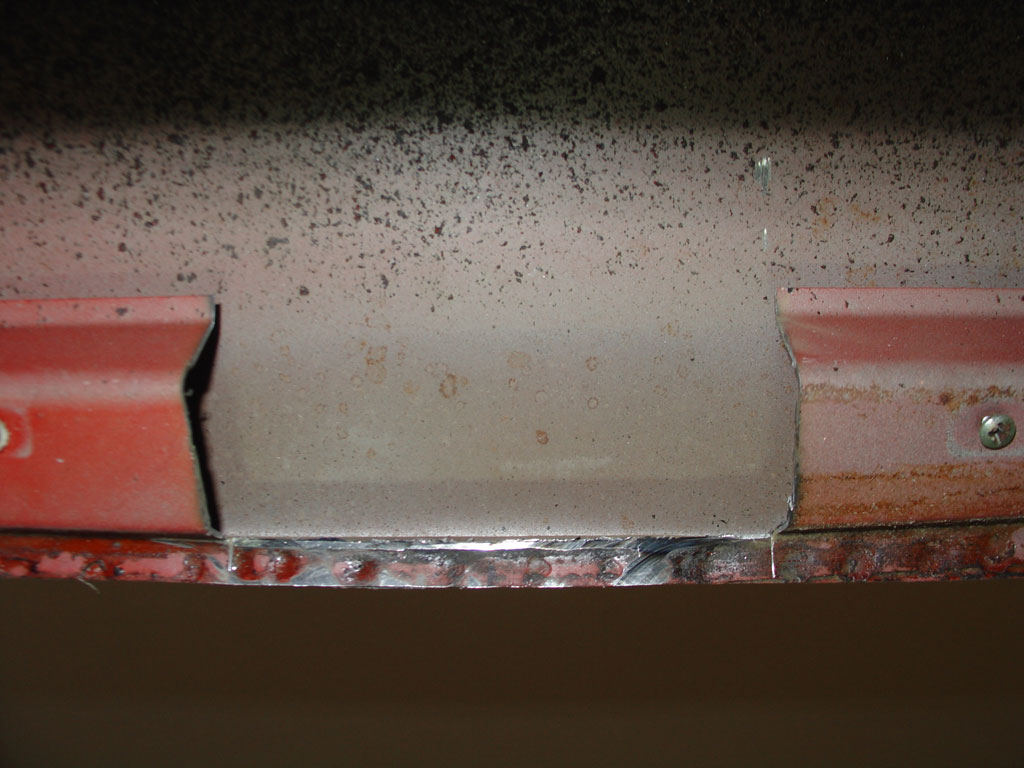

Default Dash Cut 2
Marked and removed the center of the dash. Removal also provides access to the wiper motor bracket. A few spot welds to drill out - then I can cut the dash top and firewall down to the console structure.

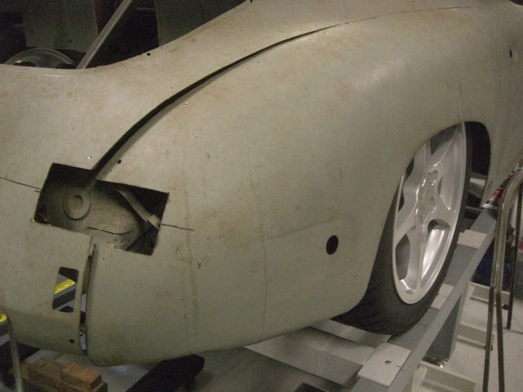

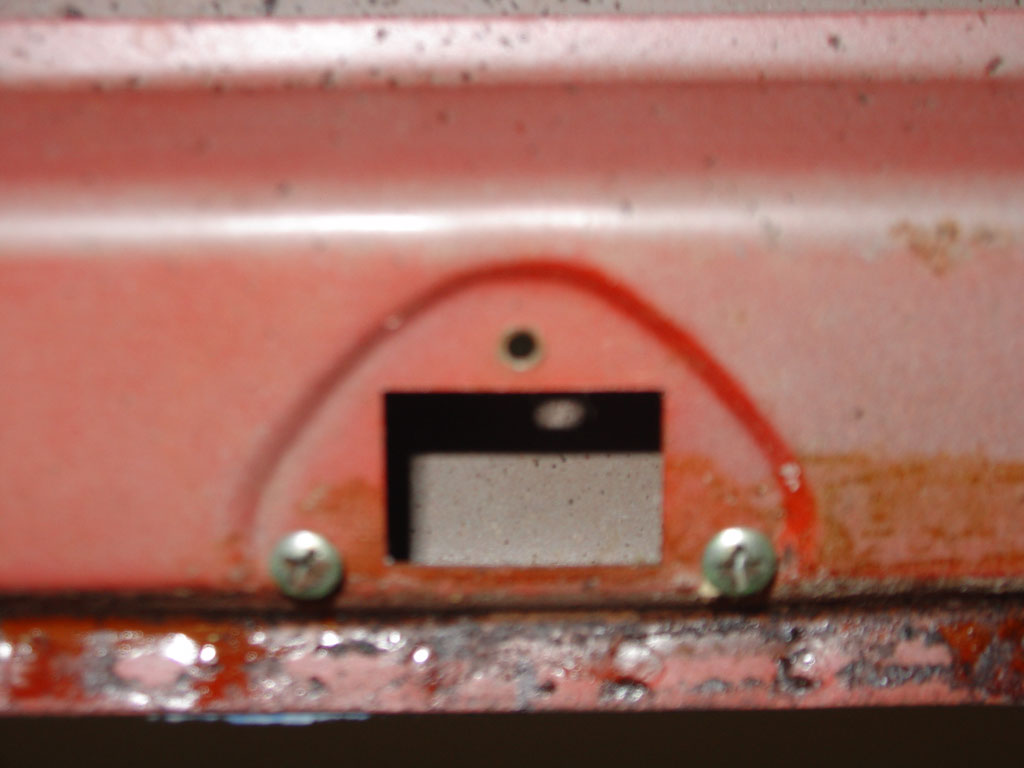

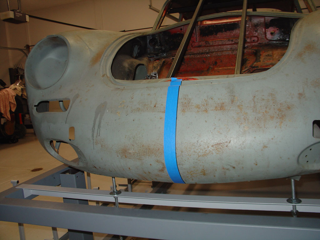

Default Saturday Part 1

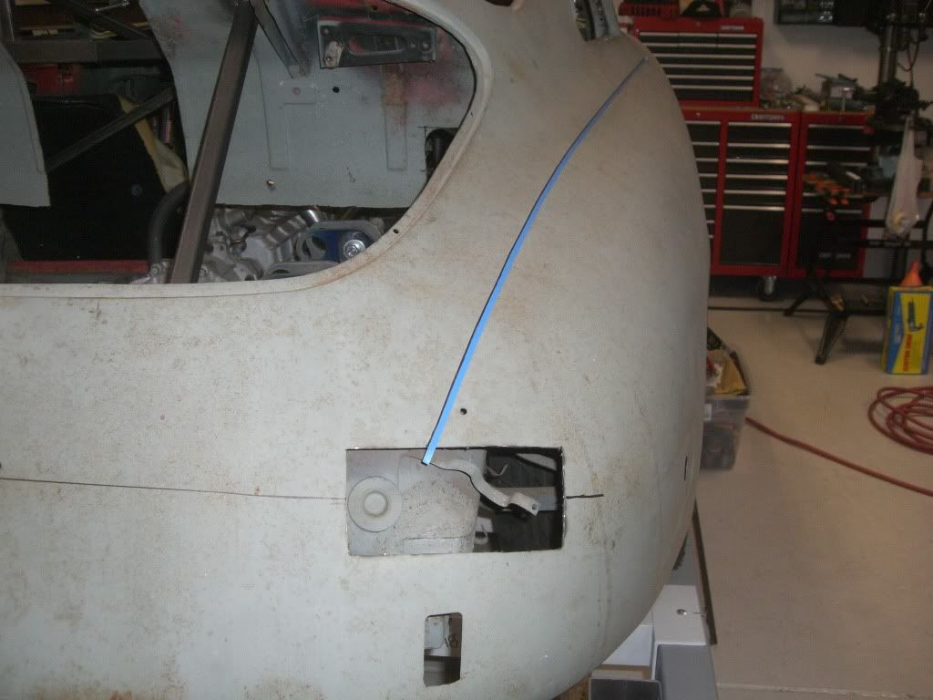

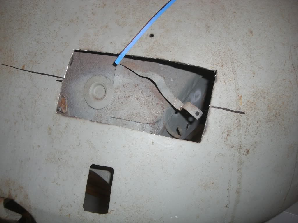

Removed the wiper mount, backup light surround, and rear view mirror mount base.
  #56
Old 01-27-2007, 05:02 PM
Garage Dog 65 Garage Dog 65 is offline
Join Date: Jun 2006
Location: Indianapolis IN

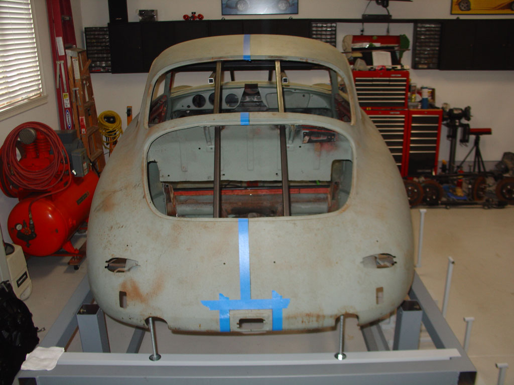

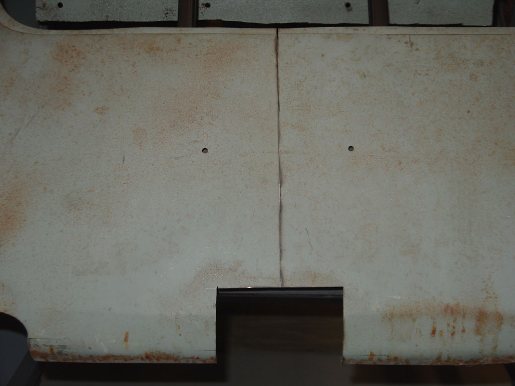

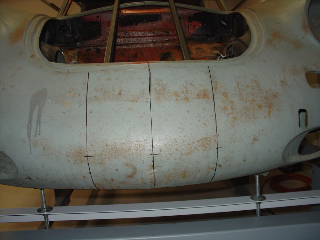

Posts: 1,207

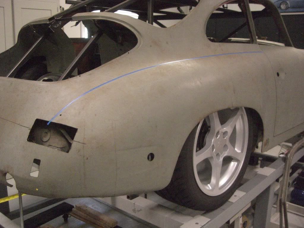

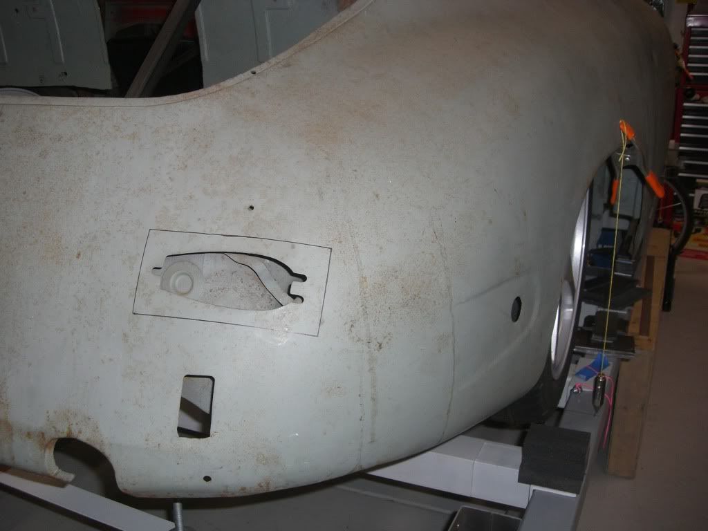

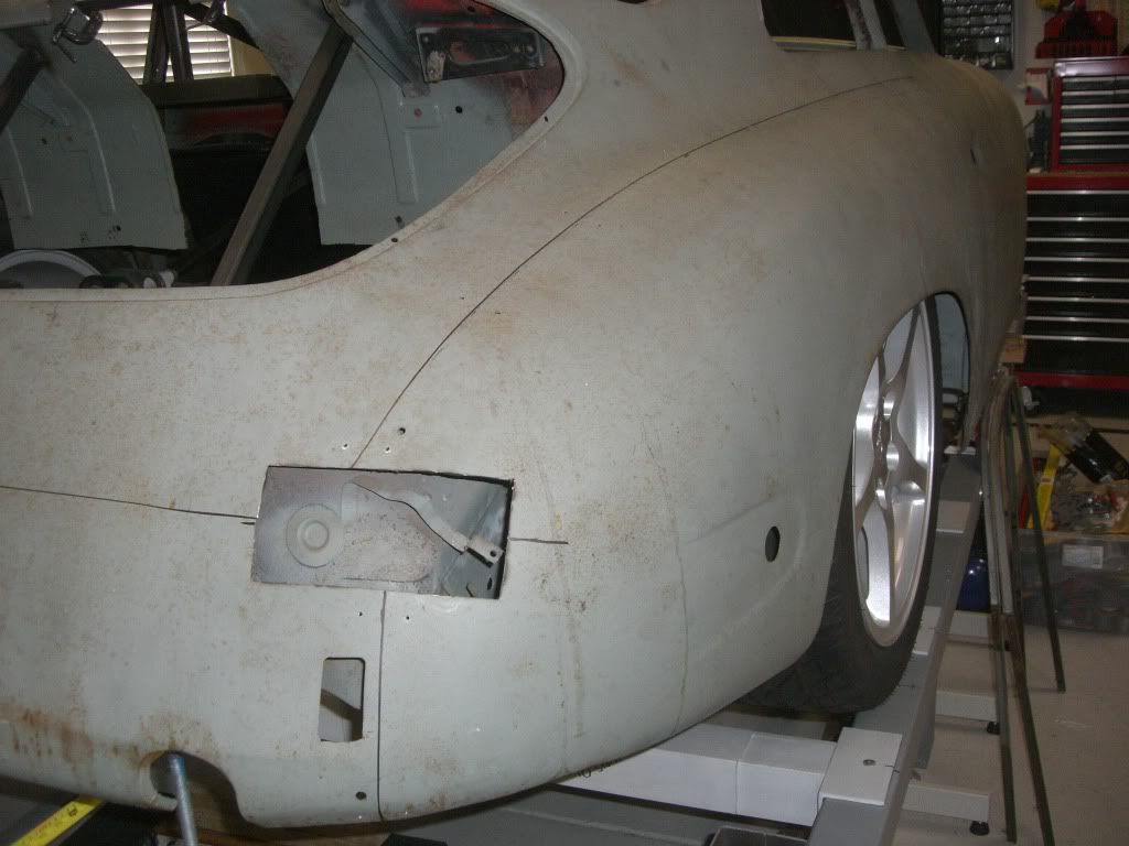

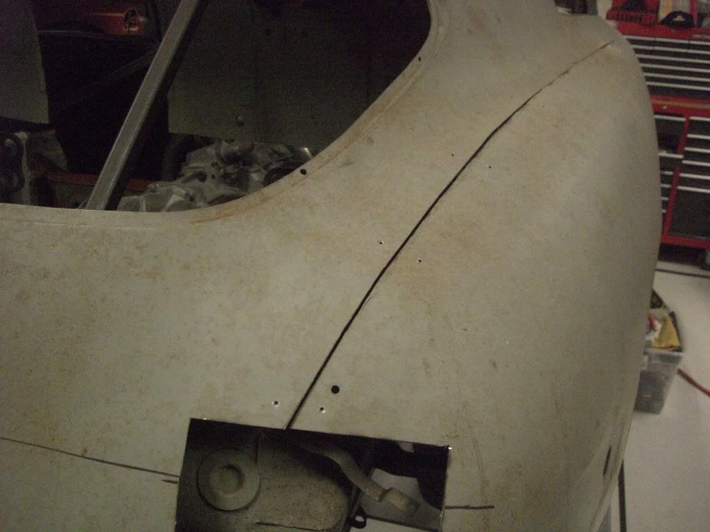

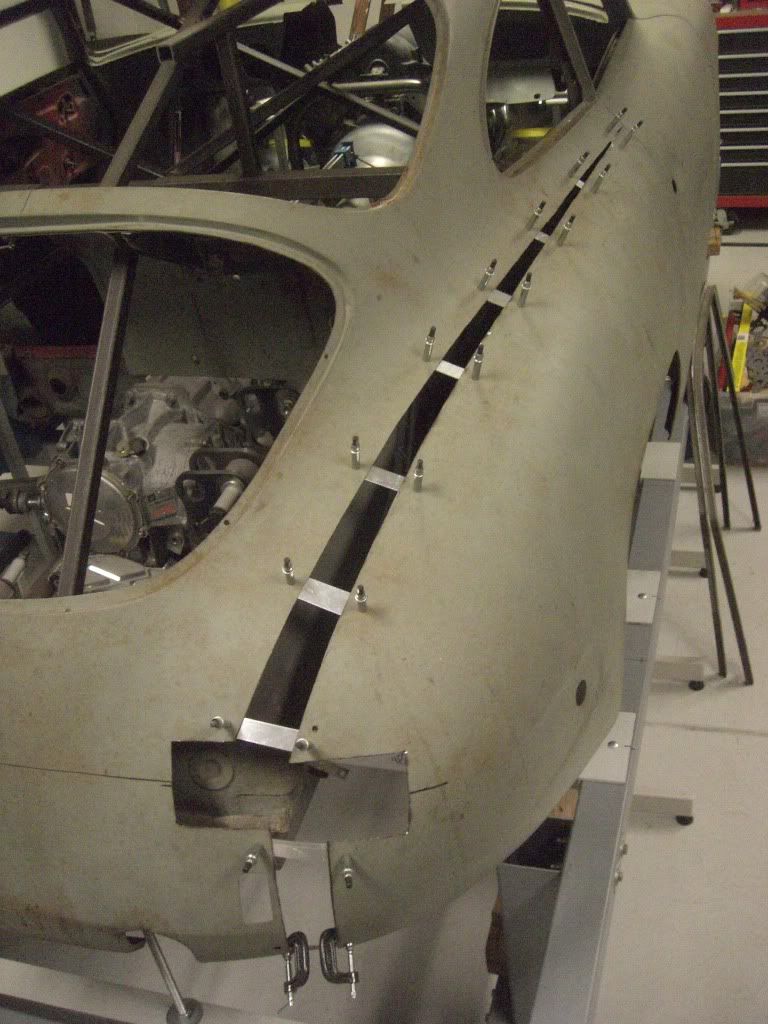

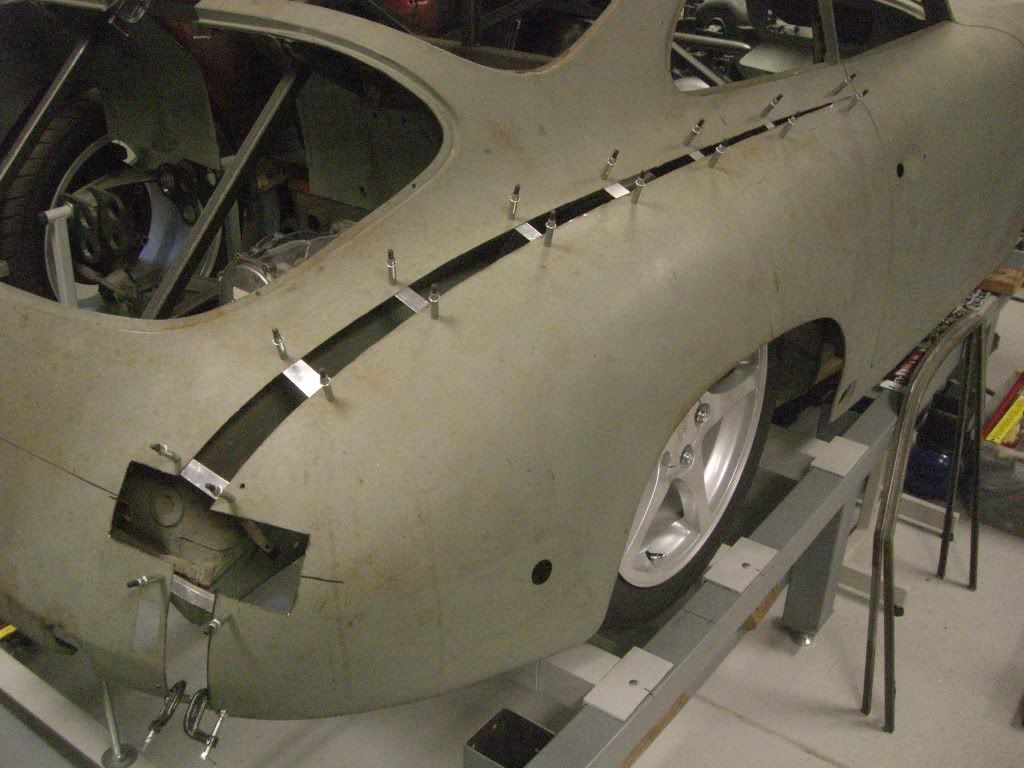

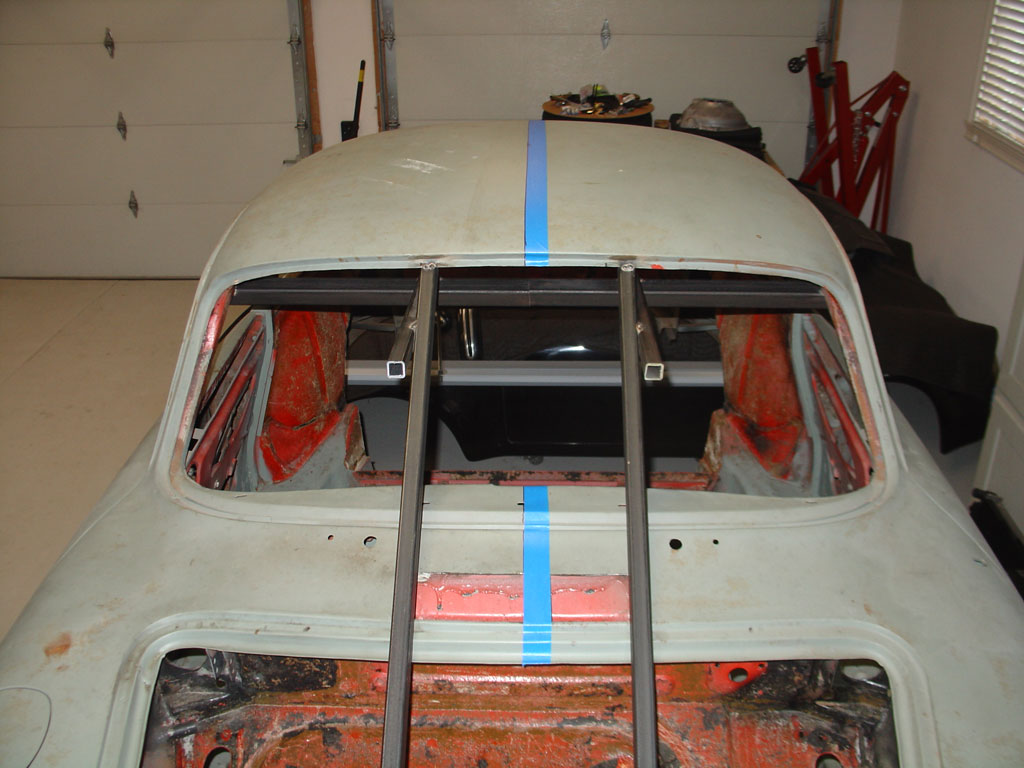

Default Saturday Part 2
Made some front and rear paper profile patterns so I can get the same curvature when I put the extra metal in. Then I split the front section (backseat to bumper). Split the rear section (dash top forward to bumper). The only thing left is to split the roof and then the floor - then bottle jack it apart and shore it all up. Might be done by tomorrow nights update....

Posts: 6,478
Great project!! I'm in favor of leveling the rockers and loosing the bumpers. Also, I'd do a high end interior using leather, but use safe seats as well as a roll bar/cage. This car is at the point of power to weight not to think safety first and include it into the design...but you're a smart guy and have already considered this I'm sure....
