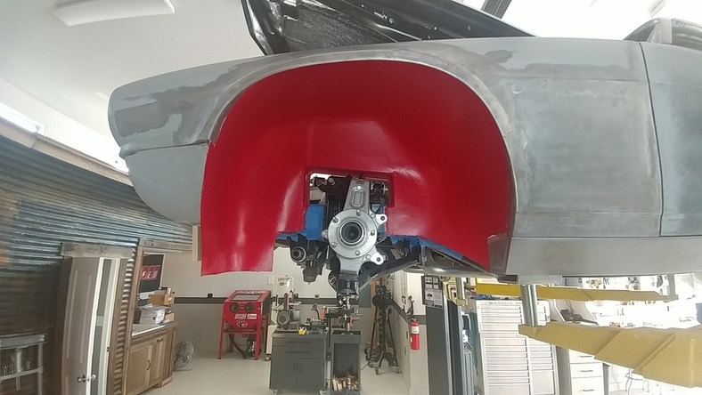

Masked and ready for Lizard Skin. Decided to use it on roof, not sure if I will use it elsewhere.

Done.
