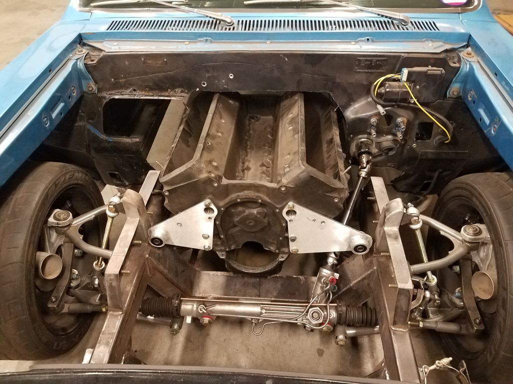

It’s been a busy summer but I finally found some time to work on the Chevelle. Over the last few days I finished cutting out the floor and firewall.
10097 by Yelcamino, on Flickr
10100 by Yelcamino, on Flickr

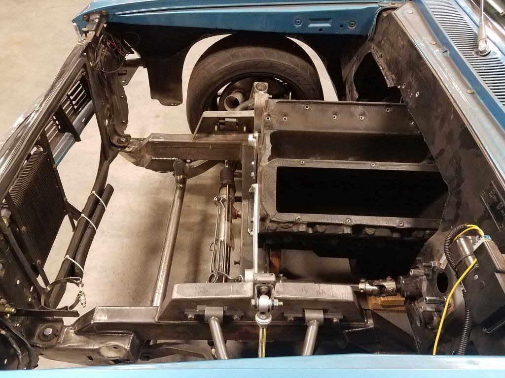

Then I added in the two 2x2” rails to connect the front and rear chassis sections. More bracing will be added but this is just to get me started.
10101 by Yelcamino, on Flickr
10102 by Yelcamino, on Flickr

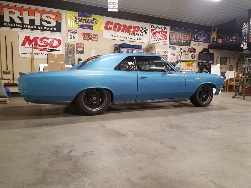

Once all that was done I put it on the ground for the first time in about two years! My curiosity was killing me so I scaled it just to see.
10103 by Yelcamino, on Flickr
Notice the driver side is heavier and the front bias is pretty light, but I’m sure the hood sitting on the roof skewed things a bit. Now that I have a baseline, I’m going to weigh it after each major change, such as the cage, engine & trans, etc. My goal is to not exceed 3400 lbs.

It's looking great, Herb. It seems odd that the driver's side is so much heavier. That steering column and wiper motor must be really heavy, lol. Are you fabbing a complete new floor from scratch?
Thanks Ric! I didn't level the scales beforehand and the hood is on the roof, so I'm sure that skewed the results. At least I have a place to start so as I add things I can try to keep it balanced.
And yes, I'm building a new floor because I want to run a belly pan and keep everything above the bottom of the frame.
