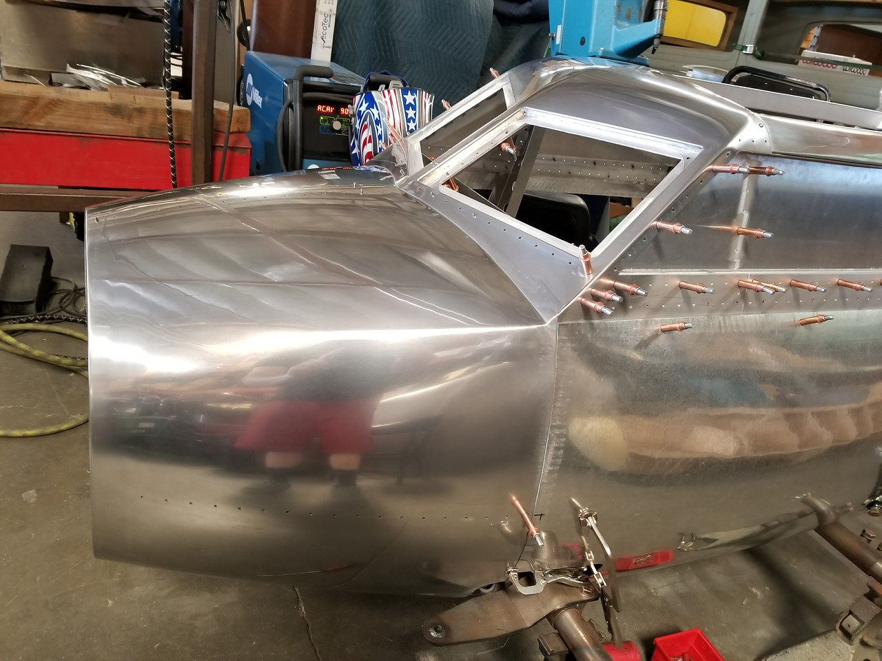

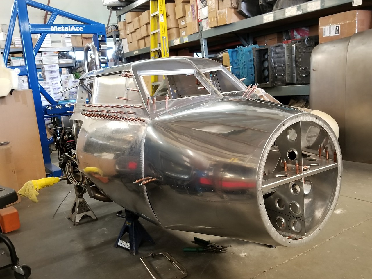

Amazing work Brycen, all the seams disappear. What does it take to bring back the shine?
Thanks! Once all of the welds are metal finished out I DA sanded every panel starting at 150 grit then step up to 220, 400, 800,1200 and then used metal polish from ShineSupply called Cloud9 to bring out the luster. A lot of work.....

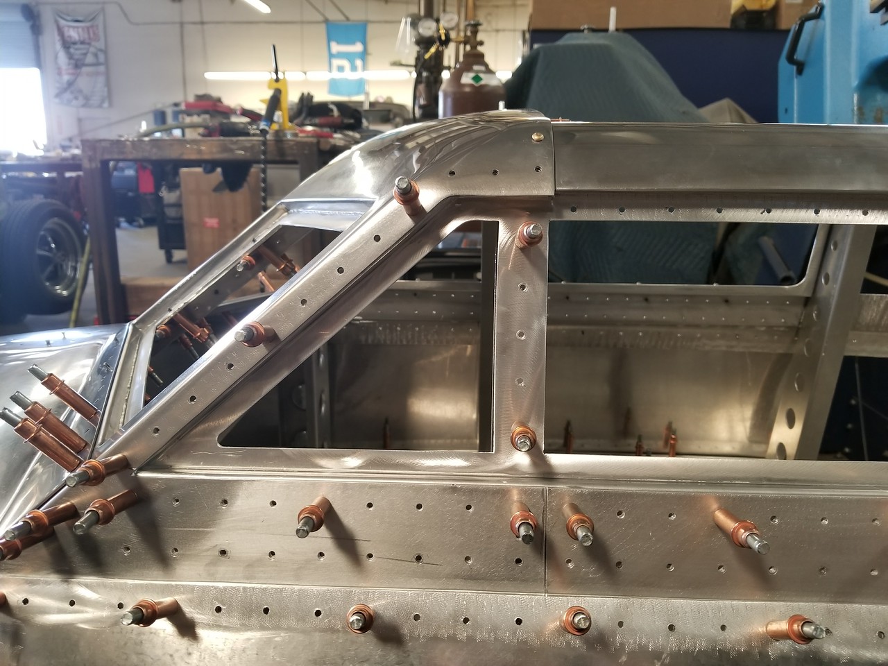

Absolutely amazing, your collection of Clecos that is....and the sheet metal work is pretty good too!
