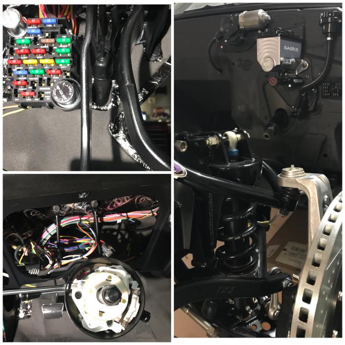

AAW Classic Update kit going in, ididit steering column fitment, hydraulic clutch installed and pedal modified for proper angle. I went back and forth on the wiring for the wiper motor. I wanted to integrate it into the AAW harness but didn't wanna run the wiper harness over to the fuse block. Instead I opted to run it thru the firewall at the back of the engine. Re-wrapped it in some better Painless Wiring classic wiring wrap. The woven material looks far better and cleaner than the cheap plastic stuff. All of the wiring except what's under the dash will get wrapped in the same stuff. Now to get the brake lines plumbed.

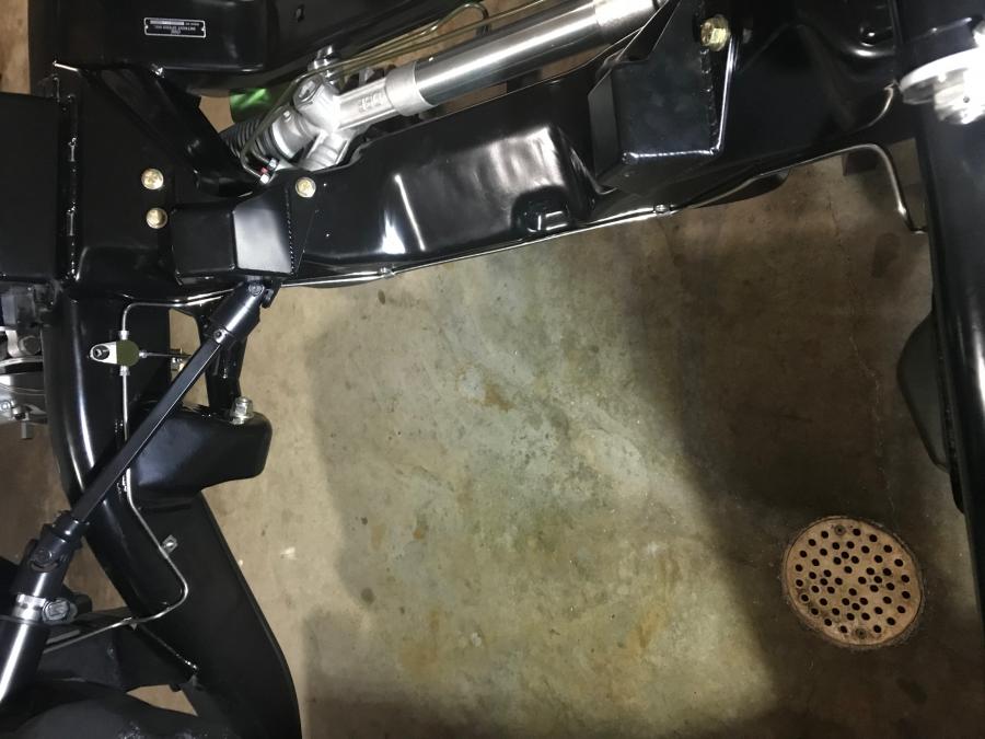

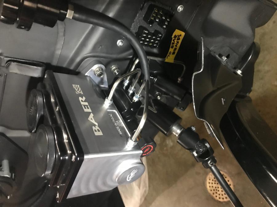

Thanked 375 Times in 252 Posts
More brake lines...I bought the Eastwood line flaring tool and I must say it does a great job. The stainless is tough as nails but makes for a good workout!
The goal was to keep the lines as symmetrical and close to the firewall as possible without interfering in the removal of any parts down the road. It's crazy how much time (and money) I've spent just searching for/buying small detail items like clips, clamps, etc. if anyone has a source, I need some 3/16" twin brake line clamps preferably aluminum that will hold two lines side by side. I've seen them all over but for some reason they've been avoiding me in my search.
Side note: like an idiot, I never did delete the wiring harness holder from the firewall. That's from all the back and forth on the wiper harness. Indecisiveness is the enemy of progress.

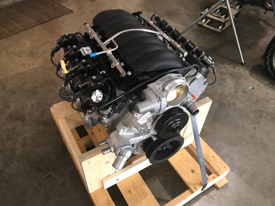

Alrighty, Friday was a good day for progress. It started with the delivery of my Pace Performance LS3 376/525 and BFG Rivals! I've been eagerly awaiting the motor partly because, well, it's pretty cool, but also because it's a big piece of the puzzle needed to move the build forward. I also got a few other necessities such as the engine controller, starter, etc. Currently, my Mast oil pan is on back order so until I have that, I can't put the engine in the car for test fitting.
I'll post some detailed info/pics on the engine fitment, engine mounts, headers, etc. just because in my research, I seemed to see a lot of different info and opinions but not many pics to show as examples of the various components. With that said, my setup is as follows:
DSE Hydroformed subframe, DSE 1.5" setback motor mounts, LS3, Mast Motorsports oil pan, Tremec T56 with Quick Time bell housing, DSE stainless headers and Holley Mid-Mount accessory drive system.
Just FYI, I paid to have the "dyno break-in" service done on the engine to ensure everything was seated and had a decent tune on it so I was curious to see where the horsepower actually landed as compared to advertised. Pace basically takes a GM crate LS3 376/430 and installs GM's ASA cam. For $1,000 less, the only difference is that the warranty on Pace's version is now a 12 month parts only (you provide the labor) instead of GM's standard crate warranty...a risk I was comfortable with given the nature of modern engines and the fact that this is all stuff GM provides themselves so it's not like it's a radical setup. Anyway, the dyno results on mine were peak corrected HP of 525.2 @ 6,200 rpm and peak corrected torque of 495.0 @ 5,200 rpm...not bad considering the big block I had didn't make that much HP and weighed about 500lbs more!

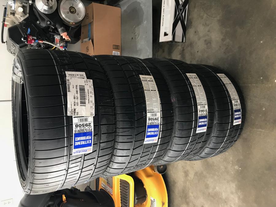

So Friday was a big day for some goodies! Got my Pace Performance LS3 376/525 and some BFG Rivals. I opted for the "dyno break-in" service as well to get the engine rough tuned and broken in under load. As advertised, the engine had a corrected peak HP of 525.2 @ 6,200rpm and a corrected 495 ft-lbs of torque at 5,200rpm.
Got some other key items such as the engine harness, starter, Mast Motorsports oil pan, DSE headers and Holley Mid-Mount accessory drive kit. The drive kit and oil pan are on back order but that'll give me a chance to get the wiring routed.

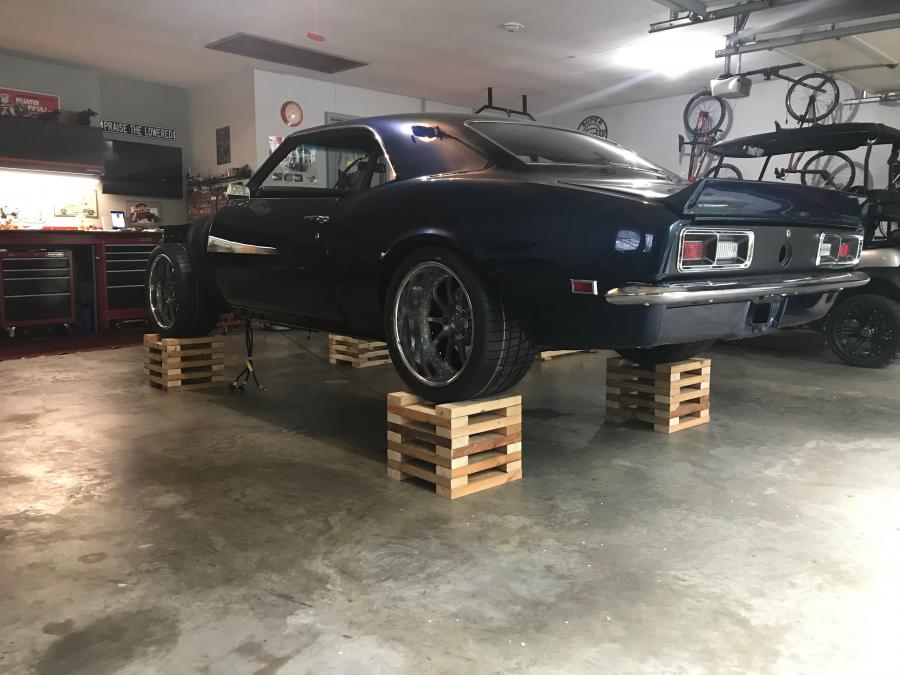

  #60
Old 04-23-2018, 07:27 PM
Gmachine1911's Avatar
Gmachine1911 Gmachine1911 is offline
Join Date: Oct 2017
Location: Southern IN
Posts: 473
Thanks: 69
Finally, after much anticipation, my Forgelines arrived! Got the tires mounted and looks good to have it sitting on it's suspension again! I've gotta say, these things are quality thru and thru...I'm running 315's in the back and 275's in the front.
