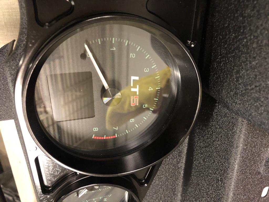

Here we go again..... Another 1969 Camaro California Black plate all original sheet metal donar Car.

Got to have an LT5 and BIG Brembo brakes.
