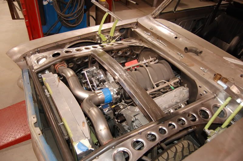

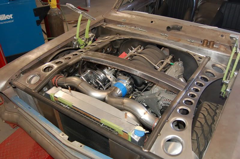

OK......just crawling along trying to get everything sorted out but a couple of things to report!
Got the gussets fitted and tacked along with the supercharger plumbing! Killer work Brycen!
John

one question how will the center arch over the motor attach..bolt on from underneath to hide bolts? i had to guess

The bolts will be accessible from the top. I will have a 1/4" tab on each top tube that the bolts go through.

LOL! I hear ya! Rodger used to complain to me that the LS7 was like trying to fit 10 lbs of crap in a 5 lb bag but now that he was able to fit 5 more lbs I gotta give props to Rodger and Brycen for figuring out how to do it! It looks so KILLER!
