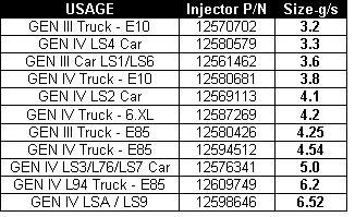

Not to get this thread derailed too much or off-topic, but what is the highest flowing GM injector? Stock Ls9?
Common LS injectors sorted by size (flow rated @ 3 BAR or 43.5 psig)
So yes, LSA/LS9 injectors are largest stock GM port fuel injectors.

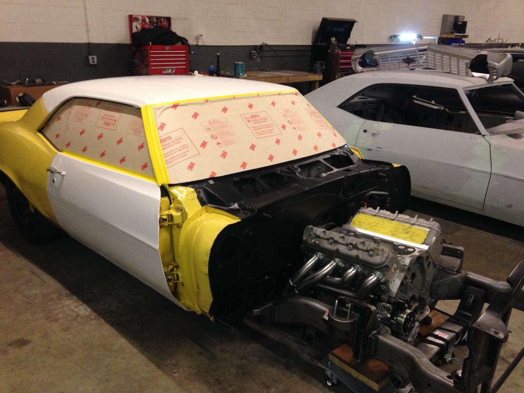

The plan is coming togther. Matt at Sled Alley is working on JA and Thomson Auto has the short block just about done.
Prepping it for a vinyl top?
