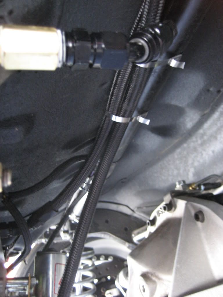

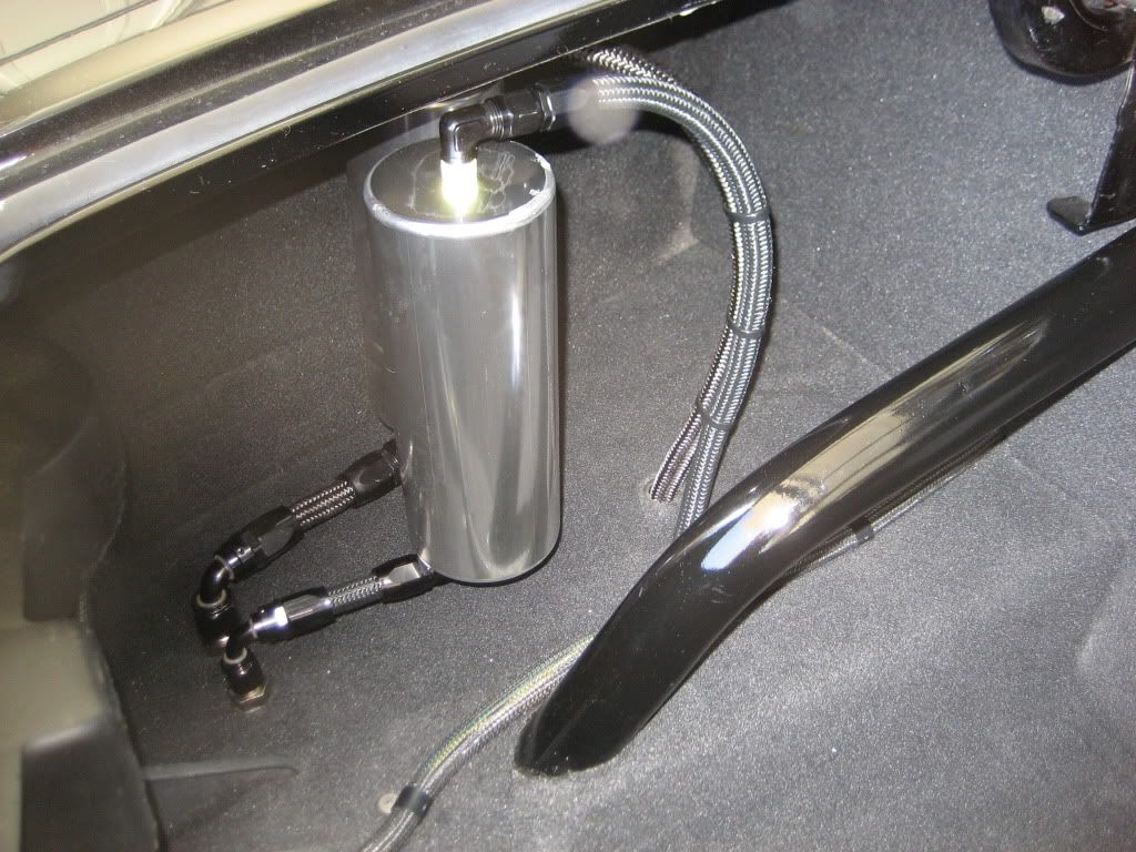

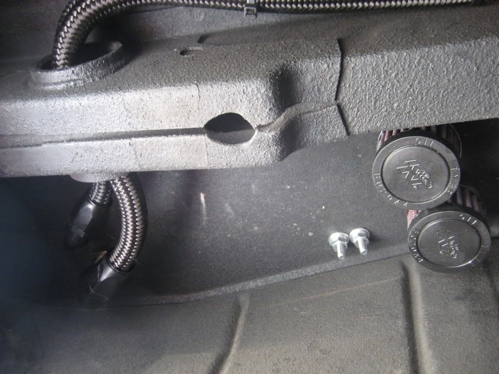

Venting a rear end and fuel tank on a 69 Camaro is very difficult. I should say it's very difficult if you want to vent your fuel system correctly without vapor lock or overheating the pump. I've been running K&N's for both as high as I could get them which wasn't good enough and I knew it. I know I was losing some gas at a little grease. Of course autocross and plans to road course really forced my hand. Plus at no miles per gallon it's not fun losing a few ounces here and there. So anyway, I designed a venting system for both the rear end and fuel tank.
I was very important to me that I kept my 8 an vent. Your fuel vent is supposed to be equal to your feed line and I wasn't going to compromise. I picked up a couple plan jane coolant overflow tanks and tapped them for 3/8 npt top and bottom, the rear end tank got tapped 1/4 npt since I used 6 an for it. I ran all AN fittings, bulhead through the trunk, then vented the tank at the top through grommets into a 1/2 and 3/8 K&N. This will hopefully allow me to top off the tank with no spillage and I'll have a quart capacity in the overflow tanks. The gas tank and rear end are well below these tanks so it should solve any spillage and it look pretty damn cool too. I even used the leaf spring shackle bushing hole for support. That's really a pretty tight spot between the frame rail and quarter, it looks large in the photo. Just to give you a feel those K&N filters are 4 inches across together. Probably have about 10-15 hours in design, fabrication, and assembly.

It looks like it turned out very nice Todd. Have you had a chance to "test" it out on the local twisties yet?

Looks nice Todd! Do you have any fuel smell in the garage (while parked)? That is one thing I'm needing to avoid!!

I only checked the fuel mileage once on a cruise out of town a ways and got 10mpg. That was highway. I've never really got a strong fuel smell Anthony. I did use hard line the length of the car where the fuel probably sits the most.

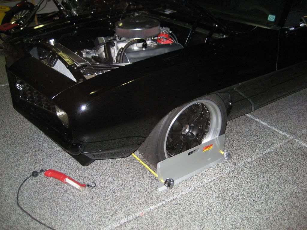

Ever since I mounted up my Forgelines I've had a pull to the right. I've been meaning to add some negative camber to the car since it was set up at a conservative .5 on both sides. Somehow I now had R.375 and L.75 degrees on negative camber. Clearly the almost .5 degrees is the problem. I haven't got out and bought that swamp cooler yet, so I've been spending more time talking about cars than driving and working. I decided to head out there tonight and play with my new bubble gauges and toe plates. I had the camber set at 1 degree per side in like 10 minutes. I have 3/16 toe out currently which is a probably a little to much. I'll save that for another rodeo. Took her out for a 30 mile cruise and she drives beautiful and straight again. The extra turning radius is a bonus. I'll probably lift the front a hair when I reset the toe.

thats a cool alignment gauge...its simple and looks to be a much better option than the spc one. i really just wanna do my own alignment since we dont really have manys options for shops out here.

I can get different hub adapters for it as well. I ended up getting it from a race shop downtown. They were nice enough to change out the adapter to fit a corvette at no charge.
