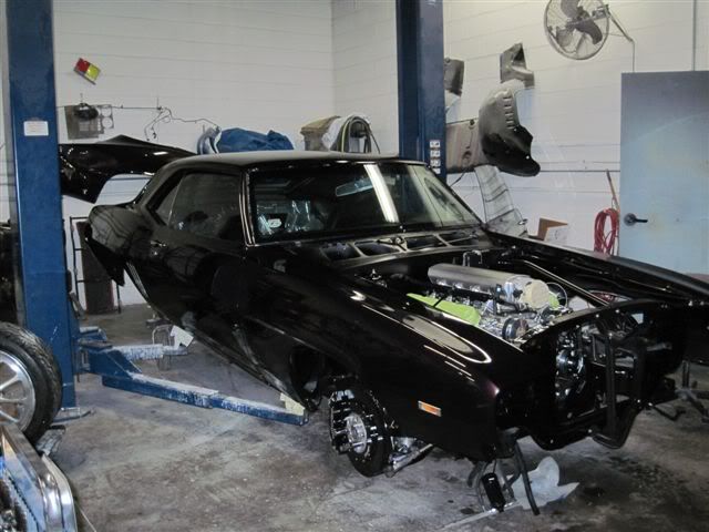

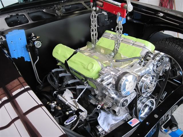

The engine and trans was put in place tonight..
That is all....
That is all....
I know, Dick sent me some photographic proof. I think all of your engine swappage over the last year has really benefited me. This probably only took them 15 minutes today.
Matt
