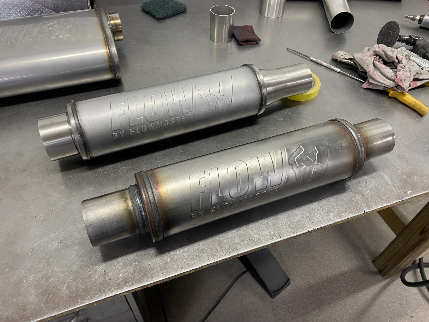

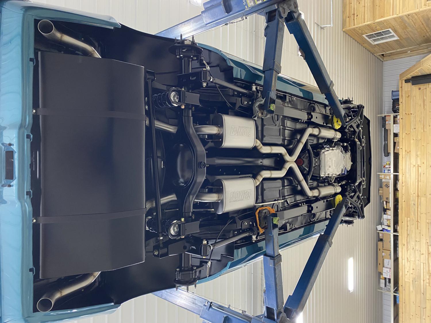

What is the reasoning for the mufflers right after the headers. I'm genuinely curious.

Curious minds want to know??
Since I've lost mine, I still want to know,

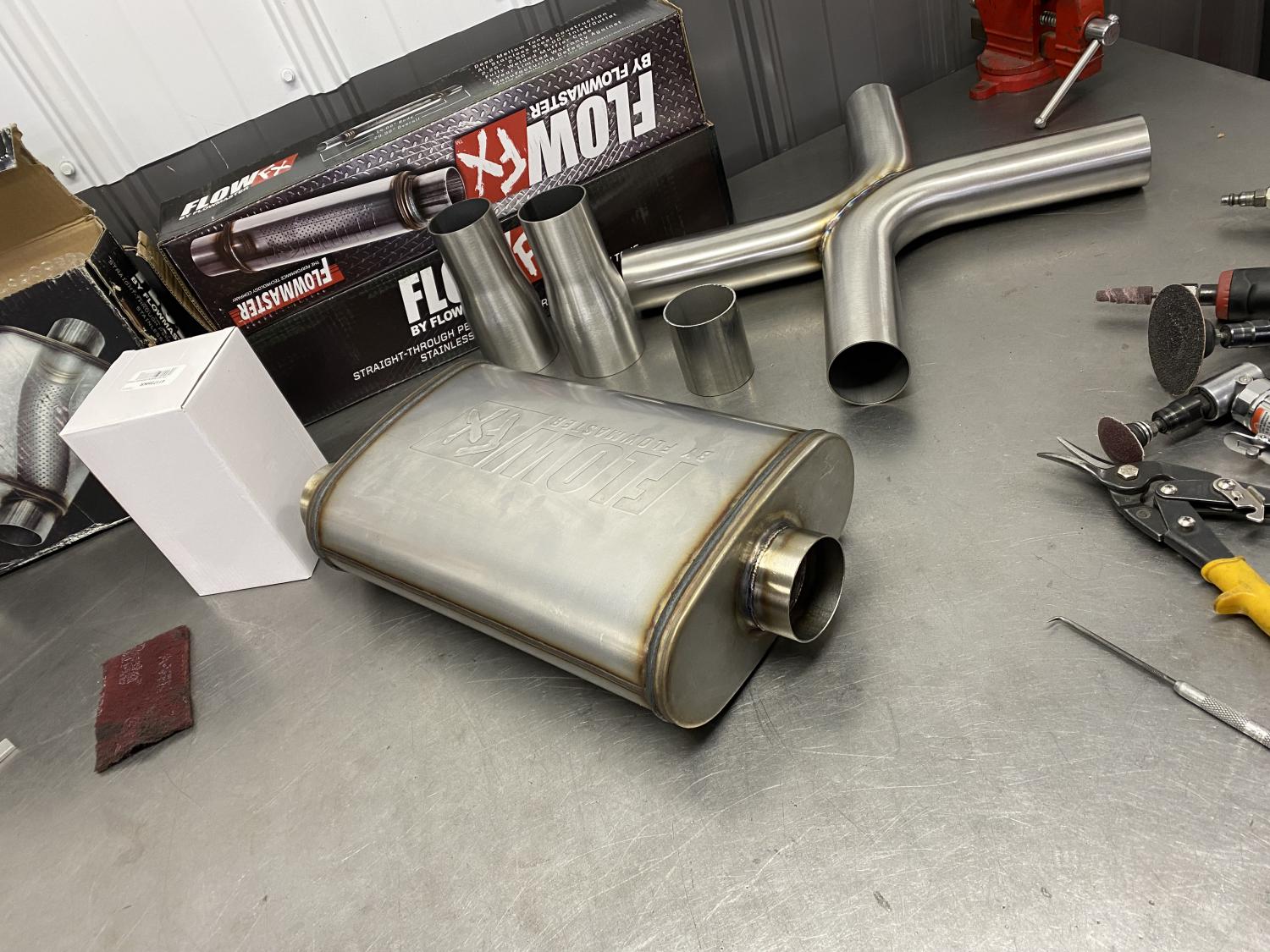

Pretty sure the larger resonators at the front are just to add volume and a bit of absorption to reduce (harsh/high frequencies) noise. And placing/packaging them up front allows for more volume (eg. larger resonators).
I would think that placing larger resonators near the headers, before the X-pipe and mufflers, would reduce drone and potentially offer a small performance increase by slightly improving exhaust gas flow.
Some other shops place small resonators at the rear of the system (for exhaust note tuning) but my guess is that Charlie is just after a mellow and refined exhaust tone.

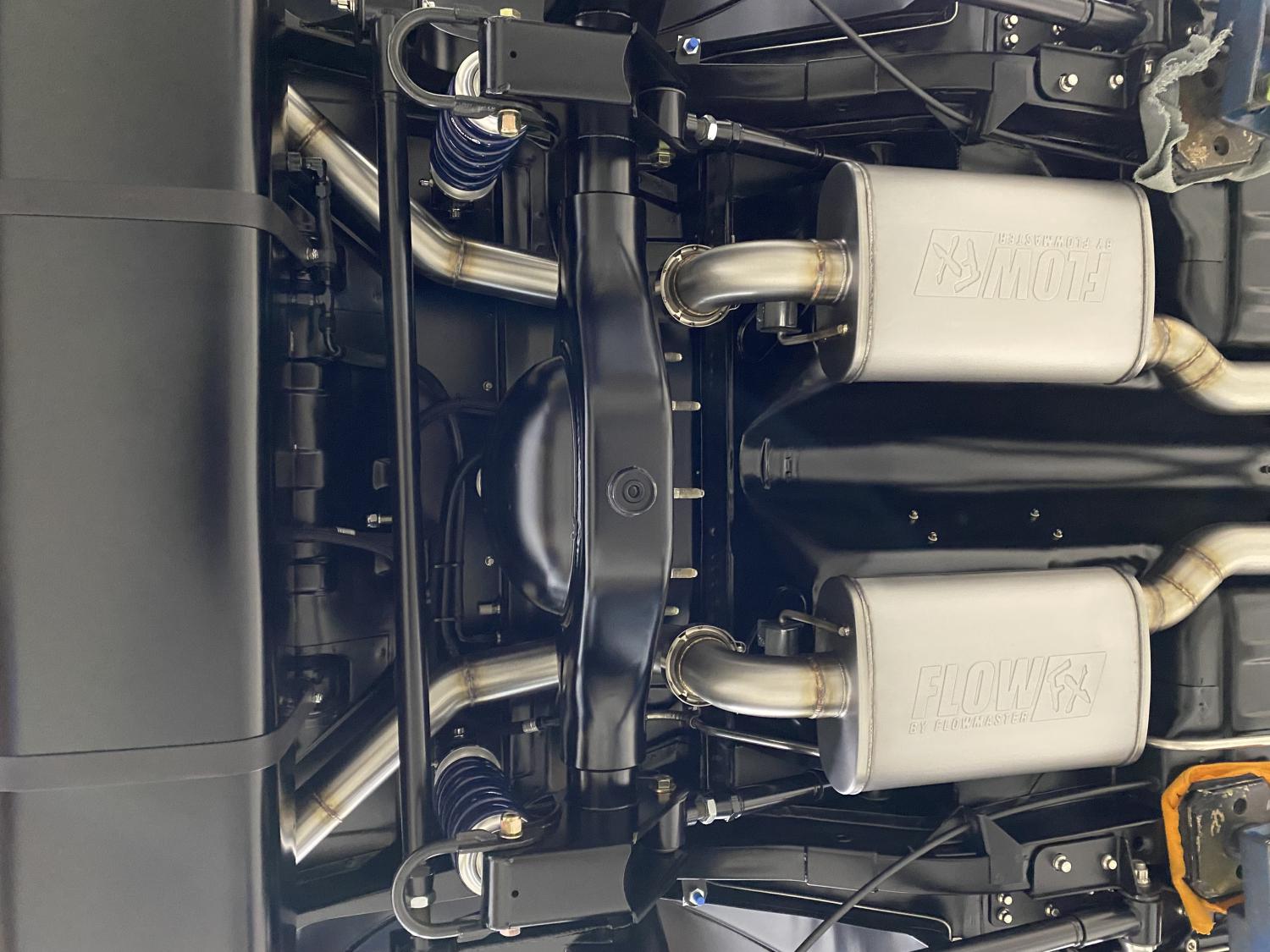

Can we get more details about the round mufflers at the front and the mufflers at the rear?

FLOWMASTER FLOWFX SERIES MUFFLERS
FlowFX mufflers feature a straight-through stainless steel perforated core surrounded with high temperature sound absorption material, delivering a deep mellow tone. The internal flow design is reversible, so the muffler can be installed in either direction to best suit the application and offsets needed. Fully MIG-welded Bright 409 Stainless Steel construction with the FlowFX logo embossed on the both sides of the case. Available in oval and round configurations.
Key Features
Fully Mig-welded for maximum durability
Bright 409S stainless steel construction
Reversible “straight-through” design
Compact case fits in tight spaces
Deep mellow performance tone
