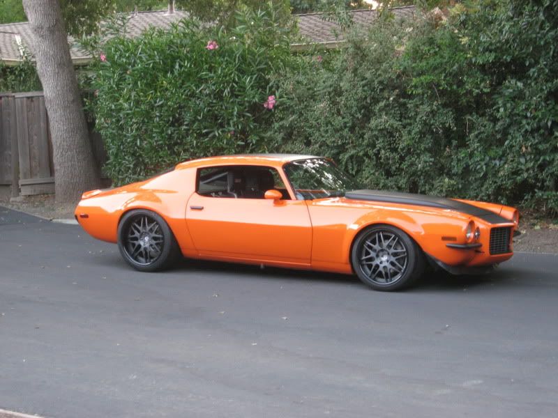

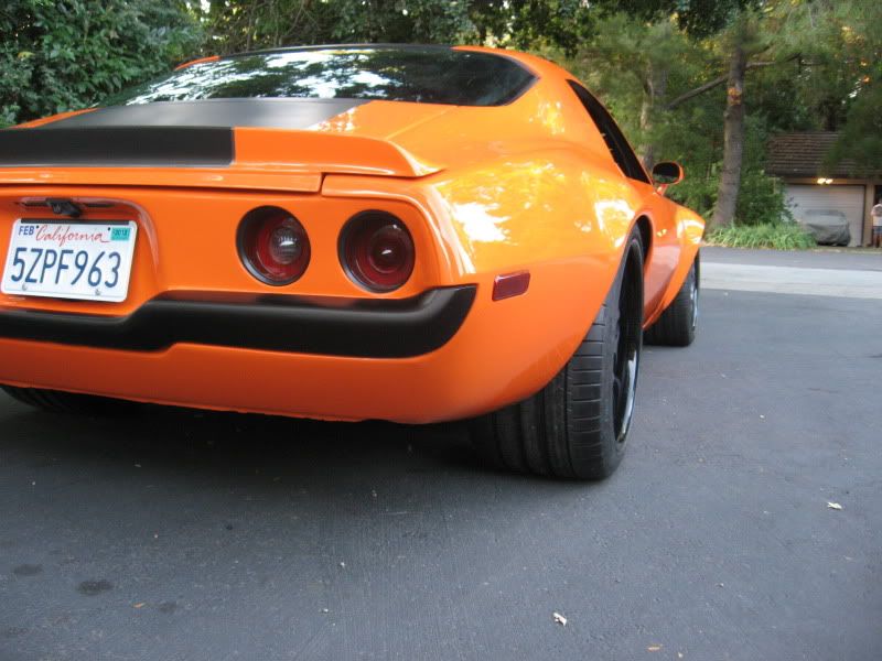

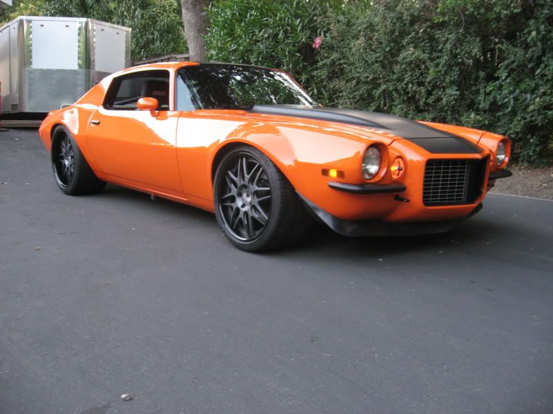

My new DPE Wheels are built and installed and I am ready to get the car ready for the Optima Challenge. We are going to have some center caps machined in the next few weeks. I wanted to get the most tire possible under the car. 20 x 13 in the rear with a 345-30-20 and 19 x 11.5 fronts with a 305-30-19. The 305 front is wider than my 315 NItto NT05.
