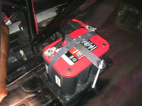

battery relocated and power kill added for easy access.

In addition to the sway bar we made a battery tray behind the passenger seat, placed a battery shut off switch near the passenger side window, made a rear tow hook, and changed the air filter set up.
