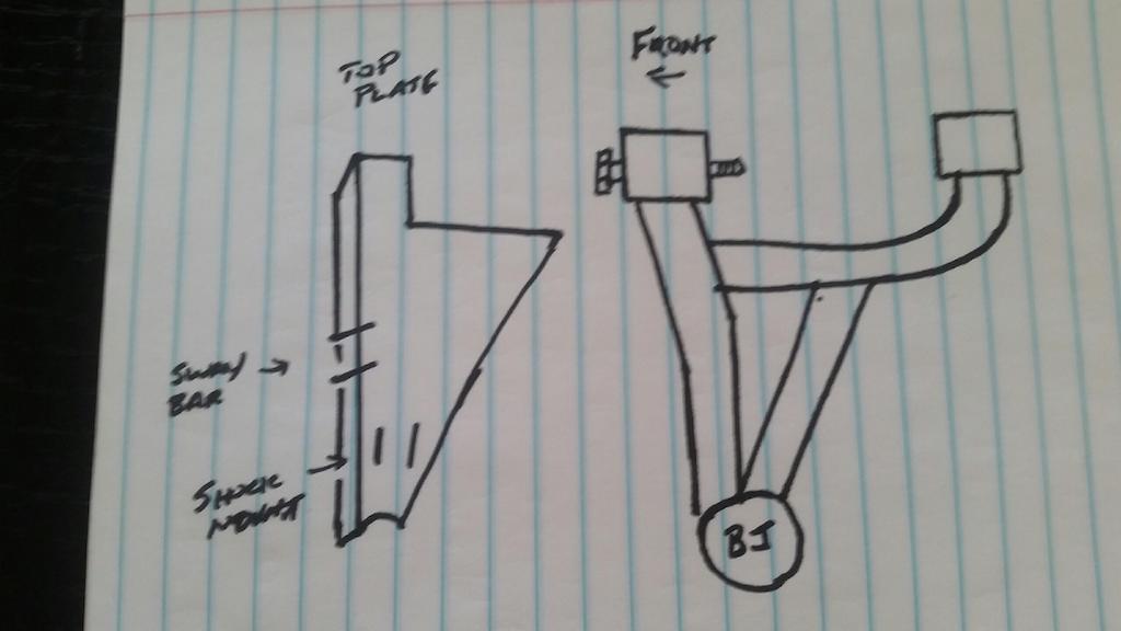

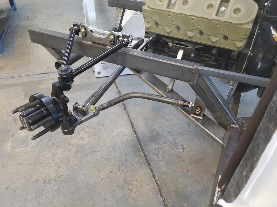

Okay ---- here's some simple pictures that ANYONE can understand.....
One is a picture of what is on DM..... a long - unsupported "j hook" design - that wants to BEND under braking (3:35 Hoosiers can supply a LOT of braking forces).... and also wants to TWIST and break that welded "eye"....

NOW --- Let's look at the SpeedTech front design that is supported and beefy and nothing will be allowed to bend/flex/rotate..... a 4 year old might draw a little better (LOL) but it's pretty obvious there's a huge difference --- BOTH TAKE 3:35's up front --- one I'd drive and one is scrap.....

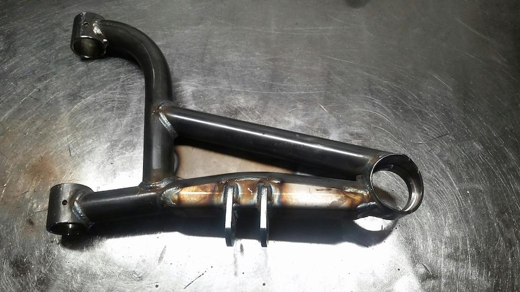

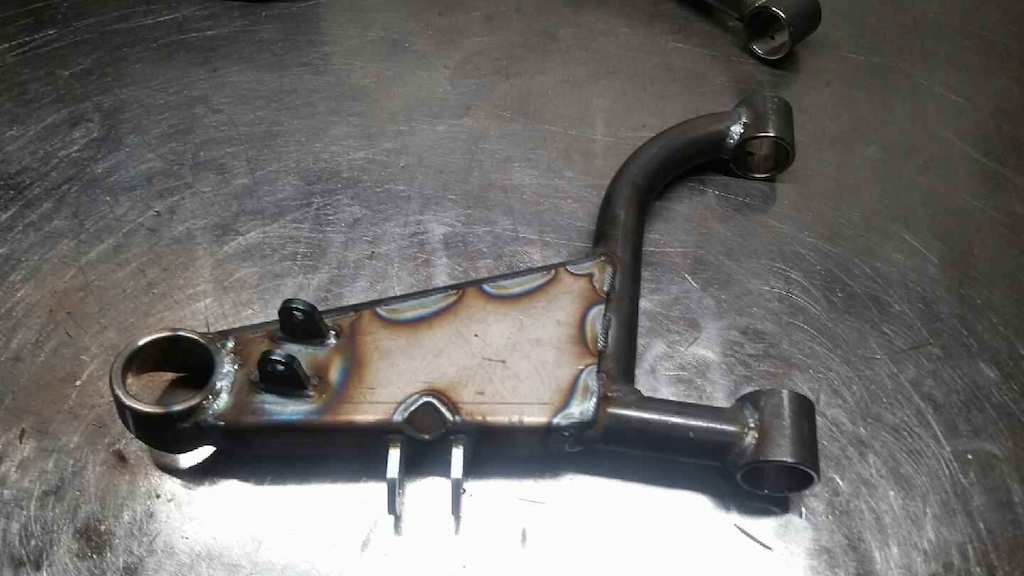

THIS is an actual photo of both sides of the SPEEDTECH lower control arm that accepts 3:35's...... Compare this to the WEAK SAUCE on Dirt Missile.... LOL Yeah that is all going away and we'll be putting this on FTW!!!
SpeedTech Extreme subframe design:
Attachment 66689

I'm no suspension expert but won't that lower control arm cause a negative caster gain? Giving a neutral or even loose steering feel? Probably a real handful in an off camber turn. The bent rear arm which if it was supported in the same plane as the front could be reinforced with a diagonal tube.

Since I have the Extreme subframe from SpeedTech now, I can attest to how hefty that LCA is.
One thing I spoke with both Ron and Roger at SpeedTech about that I liked from my previous JRS setup was the spherical bearings in the control arms. There is a lot of friction (Ron calls is stiction) when you go to move the arms with no spring/shock in place. I've thought about making a set of my own, it wouldn't be that hard. Aftermarket kits are available for the C5/C6 to do exactly this, but they are stupid expensive. You can get the high quality bearings for < $50 each (I did for TOW). 8 of them gets you to $400. But its the sleeves and standoffs which will take the machine time. Anyway, I digress...
Another thing about the ST LCA's: they are designed to go on a (typically) much heavier street car than I think Ron designs his race car parts for. That said, the race car has the capability of inflicting MUCH higher loads / stresses on components I would expect... So perhaps the higher forces of a racecar offset the raw weight of a street car. And thus this is certainly not a place to save a pound I think. (I'm rambling out loud here now...)

Greg, the Sutton LCA setup is the same stuff I ran on my asphalt late models. I didn’t use the “fishhook” style rods, but it was a straight tube. Otherwise the same. Maybe Ron needed clearance for turning radius, hence the bend?
Either way, it’s a very lightweight simple setup, that’s not meant to hold up at all. ANY contact with another car, or a simple brush with the wall, and they went in the dumpster. I carried two sets of each side on the hauler, and would often have to change them out after practice, due to a pass with slight contact.
I really can’t believe that he used a setup like this on a car like that.

I think it would actually be advantageous to update the geometry of what's on the the Dirt Missile to what Speed Tech is using. It really is dirt track stuff at the moment. It is either from Howe or copied from Howe, and as Mike at Muscle Rodz pointed out, I'm pretty sure the current lower control arms are actually going to lose caster under compression because they are not mounted parallel to the longitudenal centerline of the car.
