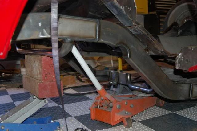

Sunday afternoon, time to put some work in. Boy this Morrison rear clip fits like a glove. It fit so tight I dont know how measurements could be off. I still have to weld it in but I got it in place for now.
Raise the rear first to get it in place.
Little bit from the front and rear jacks now
Added a ratchet strap to help with the one man show,lol
3.2.1....
CONTACT!
These are the only two holes you need to drill on each side. That way you can get to the nut
Thats it for now. Later on when it cools off in the garage Ill tack it in pace and put the rear axle in place. 105 outside is just too hot, I bet the garage is 120.
