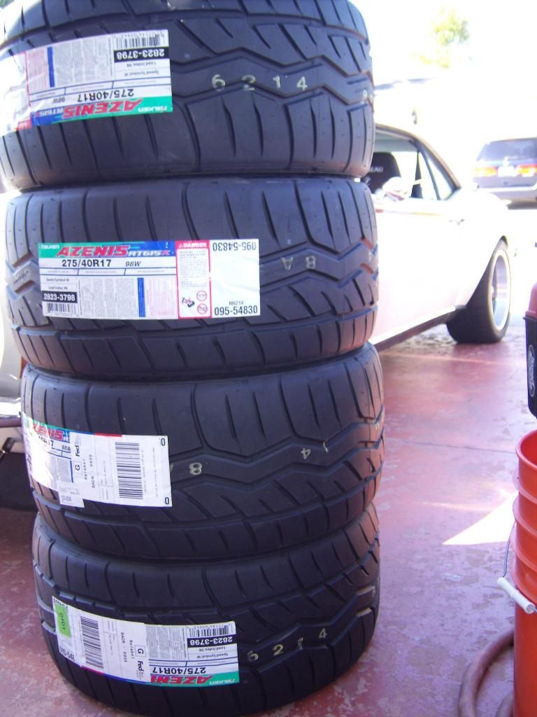

end of season Racing is coming and I have been getting the car ready, with some cool parts, and a new set of tires came in! Falkens 615ks 275-40-17s all four corners! just makes me feel the car will be hooked up

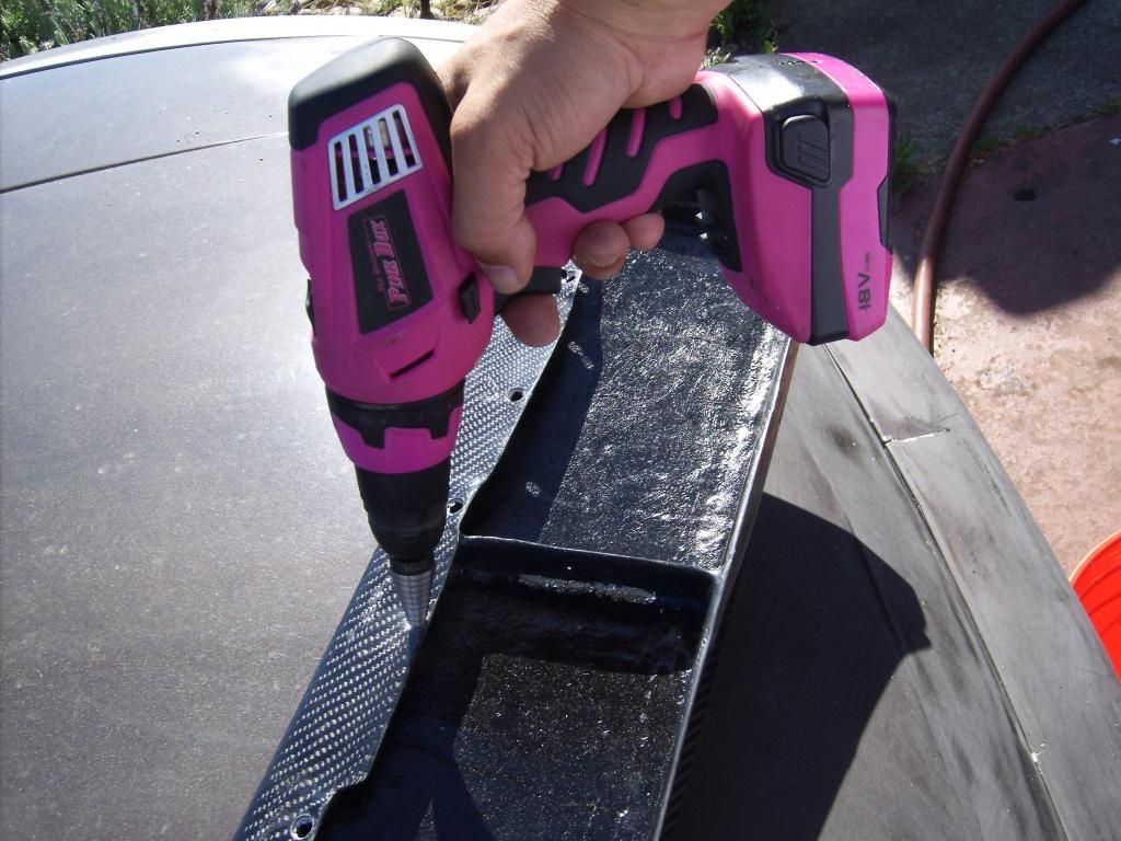

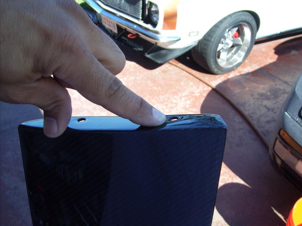

finished installing the anvil header panel i did have to ream the side mounting holes along with the grill mount holes
I used a unibit! and the girlfriends pink cordless
and I left a carbon line on the backside of the header panel

you get your rubber on?
not yet, I have a few more practice days and then at the start of November, NEW SHOES! ready for the last 3 events

You changed up sizes? When I saw her last you were running the 245/40r17 all around right?? Did your suspension changes allow you more room for rubber?
Shane
I had 245 on the front and did some short testing on some prototype parts to run larger rims, and then I switched to the ridetech tru-turn kit up front when a few friends of mine David, Mary, and Crosby all said I really must run the kit, so I installed the kit and did alot of testing(i know Ridetech tested it) but I don't have a mini tub car so the balance for my 275/40/17 on all four corners is slightly different then ridetechs 48 hour Camaro, so I ended up with 800lbs springs on the front 225lbs springs rear, and my rear sway bar rate is.........wait I cant give away all my secrets

Nice tires! Will you be taking them to Scottsdale and Del Mar in November? It's been a while since you've made it down this way.
yep Matt! I will be in Scottsdale and visiting you guys in socal for Del Mar, I wanted to come out and cheer you on at Optima, but I will be racing Pleastanton that same weekend you guys will be at Optima, so I was bummed about the conflicting weekend events
